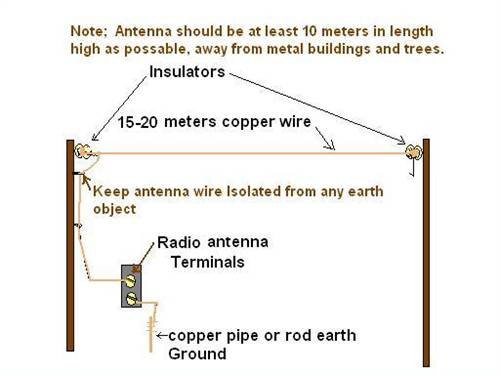

Friends,
You may be able to help me? Micro stereo system, gets FM reception OK in the bush via TV aerial and booster. I am in a marginal TV/radio reception area - outside the 97% TV coverage and have just bougth a sat dish.
For AM it has an internal loop aerial and I do not get a single station. Where you plug in the wires of the loop aerial there is an "earth" icon engraved at one connector.
1. If I connect an earth to it, would it get me AM reception?
2. I should not but can I connect the mains earth to it? This will blow the unit in case of a short somewhere no doubt. Must I run a wire from an outside fence post to it??
3. It talks about adding a long piece of wire; would this go on the other connector, i.e., earth on one side and the long wire on the other?? From my crystal radio days I remember a similar system.
Thanks.

Hi Dom
You should connect the earth wire to a good separate earth like a copper pipe driven into the ground a couple of foot, not onto the house earth as that can cause interference, as for the aerial wire get it as long as possible outside tied up to a tree for a bit of elevation, you also could try wrapping the Ariel wire a few turns around the power lead as it can pick up through the power system, but may be a bit noisy from residual interference on the power lines.

Greenbelt
Joined: 11/01/2009
Posts: 566
Posted: 06:46pm 15 Sep 2010
domwild
a little sketch for you

Thanks for the many replies. As FM comes through loud and clear it was a surprices that AM was non-existent. Apologies, the radio came with an external loop aerial, not internal. Despite this loop aerial I get absolutely no signal. But the manual (in Jinglish) tells me about "a long piece of wire" and there is this earth symbol engraved. Your answers and picture explain what they mean.
Thanks.
