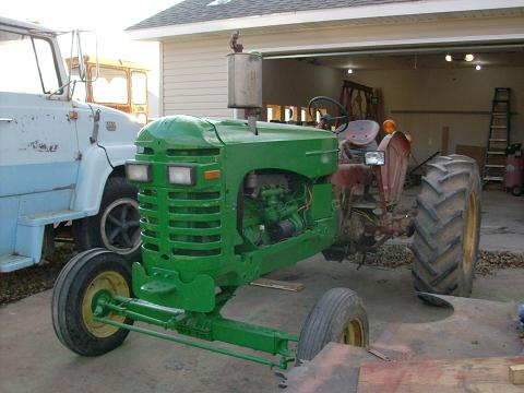

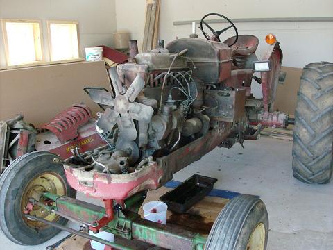

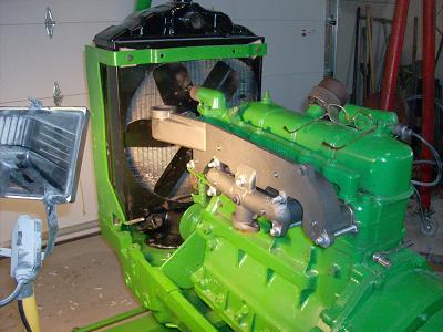

This is another recent photo of the project, I'm working on replaceing every last inch of electrical wireing now.
isaiah, I suppose (Red) paint would have been a better choice after all. The neighbors are sure looking at it as they drive by real slow, (one almost drove into the ditch).
Kind reguards...Mac46

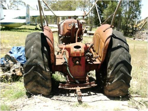

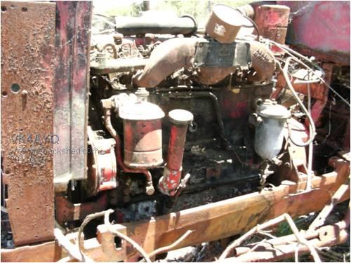

I have one of these as a restoration project, it has a Perkins P6 diesel75 HP I think engine and a few bits missing no bonnet or radiator cowl, I will post some pictures when I get a new battery for the camera.
Yours looks really great but it's the strangest shade of red I have seen, possibly an Irish red.

Thanks for the compliments...I agree, it is a strange shade of red. I just could'nt bring myself to paint a perfictly good JD engine, "red". My brother wanted to know what numbers and (ID) I was going to stencle on it...I had'nt thought of that, and could'nt answer his question. Yes, there is Irish in my heritage, German too, and English. The electrical is 99% complete, I still have the fuel line, front sheet metal, and hydralic pump to install.
The old engine was rated at about 45 hp and 1250 rpm, this engine is rated at 45 hp. and 2400 rpm. It has twin balanceing shafts and overhead valves, should be a much smoother running engine, and no oil leaks.

I took the 38 inch rear tires and rims off and installed the 26 inch rims and tires from the combine, also fabricated the mounts and installed the combine steering axil, makeing the tractor a wide front end from a tricycle front end. The engine is also from the combine...recycle/ reuse/ rebuild.
The smaller rear tires should put the ground speed at around 22 mph at 2400 rpm, up from the 16 mph as was with the other engine. I also installed the JD guages and 4-legged Deere steering wheel, and went by the JD service manual for the electrical wireing diagram and routeing, changeing it from 6 volt + ground tp, to a 12 volt - ground tp. If I ever need to overhaul the JD engine, the complete kit cost is much less than the Massey, although both are available.

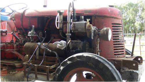

Thank you for the compliments. Yes, the whole idea was to be able to use it instead of the larger tractors when possible...saveing on wear and tear on them, and also saveing on fuel. It is a plus when the tractor has new paint, but not a requirement.It now has been updated with flasher and marker lights, new wireing, and should be a handy tractor to have around.

Hi Mac

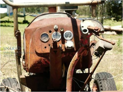

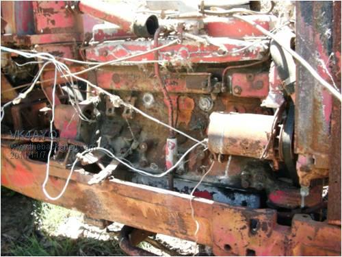

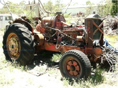

This is my old beast it has had a hard time in its life missing injector pump and starter and has a fordson steering box fitter, tyer size 30 x 19.8
Most other bits are there except the tin work.
All the best
Bob

Thanks for posting the pictures of you'r tractor. (she's a diamond in the ruff), I can pick out many simular things between the two tractors...pitty we're 1/2 a world away from each other, I have many of the parts that you'll be needing, the freight cost alone would be the problem, even if I just gave them to you it would cost a pretty penny.
I have a 756 Int. with a 6 cyl. Perkins diesel engine, but it looks to be a different engine than what you have. I overhauled it two winters ago, (did'nt paint it because of the cold temps.) This was before my heated shop, and one of the reasons I built the shop. There is notheing like trying to put together an engine in subzero weather...but you do what you have to.

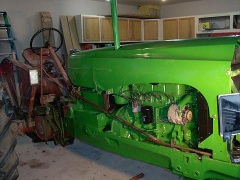

Hello, Everyone,
This is a picture of the tractor project, sitting outside after the first startup. It sounds suspeciously like a John Deere.
VK4AYQ, After some thought I've decided that the Massey Harris name will go back on to the hood, seems only fair. The engine will speak for its self.
I have'nt drove it around or anything yet, so I don't have a feel for how it will be....it sure is smooth running.
If anyone is interested ,I have some (very) used Massey Harris parts, includeing a complete engine, needs a complete rebuild, but ran fine up to the time I pulled it out of the tractor. Cheep, cheep, cheep.

Rastus, everyone,
Yes, I agree...it looks silly like this, but I have'nt had the time to clean it up and scrub it down. I'd also like to replace some of the seals and gaskets. I kind of whanted to give it some running time to see what the tractor acts like with the transplant...some have said that the transmission won't handle the different engine because of the higher rpm range. I have backed the govenor down to 2,100 rpm, but thats just because I did'nt or don't run them wide open anyway.
I must say that the smoothness of the engine / clutch is much better than the original, and both engines were rated at nearly the same hp, so maybe it'll be ok...time will tell. Thanks for you'r interest.
