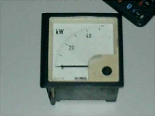

As I was rooting through the box with panelmeters, looking for a suitable meter for the anemometer I'm working on (old HDD 3-phase motor with real blade cup, but will post project story when it's finished) I came across this little beauty:
I have *no* idea when, where or how it got into my possession. Was very surprized to find it in the box, even though I once put it there myself...
When the 100 hp conversion is finished and I start pushing power back into the grid, this will make the perfect meter to monitor the kW's going out the door (and the $$$ coming in).
I'll admit, as of yet I have nothing but this little meter. But it's the first step... And every round-the-world voyage starts with the first step! Now to find me a 100 hp motor to convert. And some large blades. And a tower. But no matter what I still need to gather, I won't have to look for a suitable meter anymore.

Hi dinges,
You will require a current sensing coil. The type where the wire goes through the middle of a coil of many [approx 1000] turns. They are normally calibrated for a particular voltage, and only measure sensed current.
These are common in older style A/C, or motor control switchboards.
Gordon.

Hmm,
From your description Gordon, they are a fixed voltage kw meter, which may just as well be replaced with a normal shunt amp meter with different scale readings.... which makes it useless for variable voltage mills I guess.... , although I suppose you could use it as a rough guide if the battery didn't change it's SOC too much ... or is there more to this than I think?

the models that I have seen looked identical to the model in the photo above. I have seen units calibrated as kW,AC A & AC V. All were only 2 wire connections. A true kW meter would have 3 connections. Dinges can confirm the connections.
Most times with grid connections, we need only measure the current and then scale accordingly.

Ozules, Gordon, you are right, it's basically a simple analog meter with two terminals. With a shunt it reads amperes. So yes, of pretty limited use as an actual kW meter for a variable voltage application.
The story was more or less tongue in cheek, as I was surprized by this meter being in my possession and having an, err, 'ambitious' scale (ambitious w.r.t. homebrew windpower).

Dinges,
If the KW scaled meter that you have has only two terminals, it was probably intended for operation with a KW transducer in a 0 to 5V, or 0 to 20 mA, or 4 to 20 mA loop. If this is so, then what you have is essentially a DC voltmeter, or a mA meter.
Hopefully, by peering at the fine print on the scale, you can get an idea of what the base meter movement is. You could also confirm this by feeding a very small DC voltage to it and monitor the current and voltage as you run it up scale.
None of this helps, of course, with your intention to use it to monitor KW, as you would need the associated transducer to do this. While there are many kinds of KW transducers, including those that can have direct current and voltage connections to your generator, the AC ones most usually would require a primary voltage to 110V potential transformer, and a primary current to 1 or 5 V current transformer.
There is also the type of transducer that Gordon mentioned that could presumably be set up to drive your meter, but it is probably much simpler just to drive a liquid crystal display with it.
