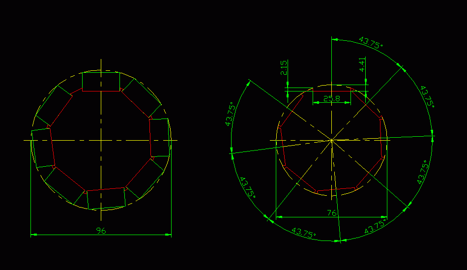

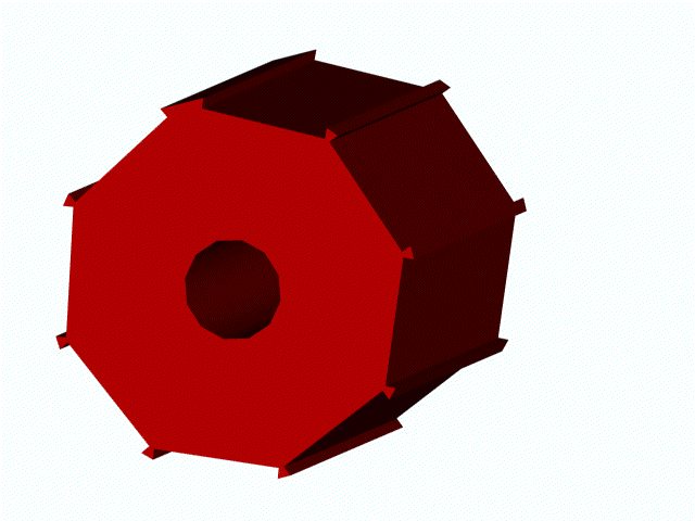

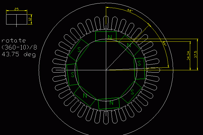

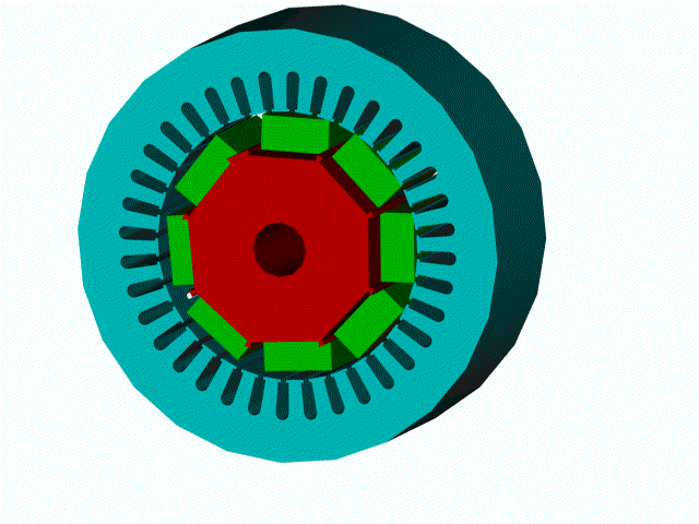

I noticed your post on FL with the 2hp conversion. Was curious about it and decided to make a quick sketch... seems to be the perfect candidate for a 4-pole conversion using 8 pcs. 50x25x12mm magnets; these will cover practically the entire circumference of your rotor, and nearly fill the entire length of your stator (50mm of the 60mm available space). By using the offset-method as I used in the 12-pole 10hp conversion I think it will be even very easy to build too, if you have access to a mill with dividing head (which I think you do).
Just mount the magnets at 43.75 deg (as opposed to 360/8=45 deg) on the rotor (with 43.75 deg angle between *each* magnet and its neighbour) and that's all. No need to make and drill aluminium cages. These magnets are cheap and plentifully available. I used 50x25x12mm in my conversion, but 2"x1"x.5" should work too, with slight change in dimensions.
Definitely check dimensions for yourself, I only drew this off the cuff. Your responsibility to verify dimensions (the 43.75 deg. offset angle is 100% correct though) if you decide to build it like this. The above angle is only correct for 36 stator slots, which I think yours is.
If it were mine that's how I would convert it. It would give you 8 cubic inch of magnets... according to Zubbly's rule that should yield you 1200W (according to my experience more like 800W). Simple and quick project, if you can turn and mill a new rotor of solid steel.
Peter.
Edit: I don't think it'd cog, I'd be 100% certain it wouldn't if you'd mount the magnets N-S-N-S... (i.e. 8-pole)... but I've never actually verified this configuration (N-N-S-S-N-N...) myself yet. I'm reasonably sure it wouldn't cog though...but no guarantees, of course.Edited by Dinges 2008-11-25

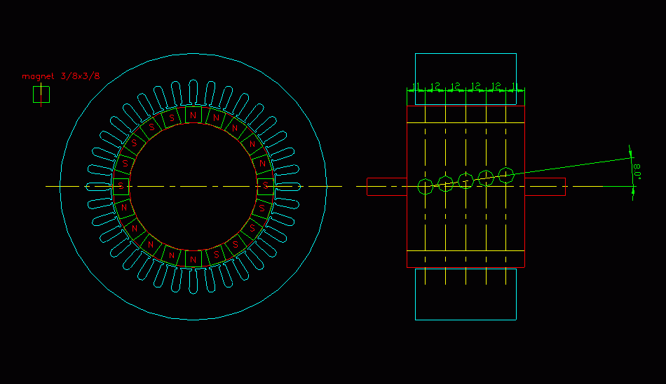

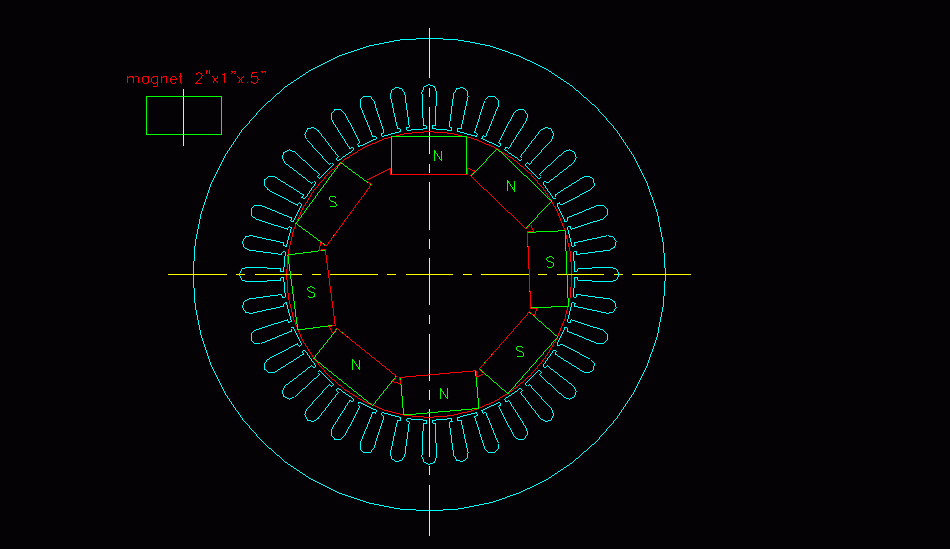

Hi Bryan,
Not really topical to this thread but needed a place to post this drawing, so... hope Gordon will leave it long enough for this reply to appear :)
Lots of round magnets should work fine too. The premium for N50 is neglectable, I'd go for N50.
You'll have to make a new aluminium cage for the rotor and drill or mill a lot of holes. It's a job that I've come to hate over time and doubt I will use ever again for conversions. The bar magnets with offset is just so much easier and quicker.
Also, with square magnets you can fit more magnetic volume in the same space. Those 120 3/8*3/8" magnets would yield 5 cubic inch of magnetic volume, the 8 square bar ones 8 cubic inch. That's 60% more...
Either way, both methods should yield a fine working generator when skewed properly. Your call.
Peter.

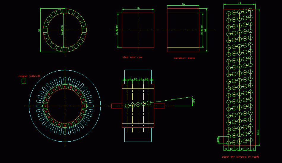

Ok, so I was bored tonight...
A skew angle of 8.0 deg (7.94 deg, to be more precisely) should give you zero cog if your outside rotor diameter (aluminium sleeve) is 96mm.
If you decide to use this as your basis definitely check dimensions. If you decide to give the aluminium sleeve another outside diameter (or decide to use a different method, without a sleeve) then your skew angle will have to be recomputed.
Peter (still bored...)
