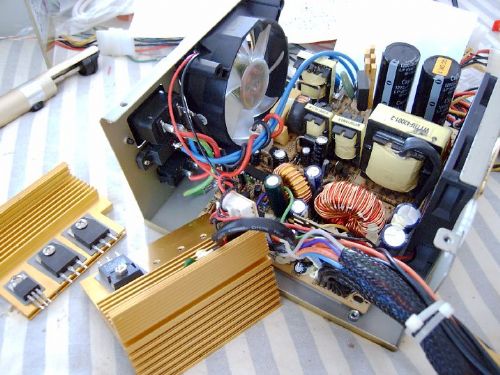

This is (was) my favorite 550W ATX PSU that I rebuilt several times (6 years old):

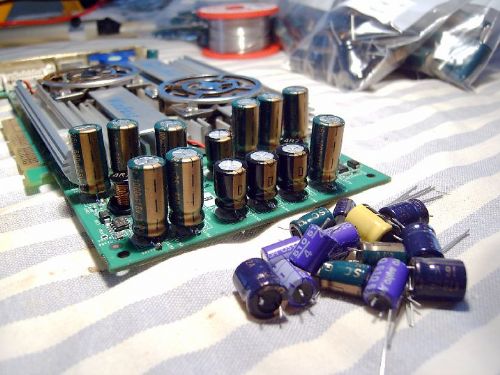

This is (was) my favorite Ti4600 Gforce video card (6 years old):
If you feel up to it, and its a hobby, have a go changing the caps in an ATX
PSU or maybe a motherboard where the caps are on the way out. You can
sometimes tell by the X in the top of the cap bulging up that its about to go
pop. Try to use the same or better voltage and capacity, and use good quality
low ESR caps.

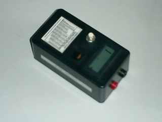

It's common knowledge that capacitors are nowadays the most unreliable components in electronic equipment. The rated lifetime of many electrolytic capacitors is only about 8000 hours. That's less than a year of continuous use... Exposure to heat will decrease their lifetime even more. They usually fail by increased ESR (equivalent series resistance). Their capacity still stays about the same (usually within tolerance), so they test fine when checking their capacity with a DMM. However, due to the increased ESR they're no longer able to perform their function.
Back when I still routinely repaired electronics I grabbed the ESR meter to check out caps even before I reached for the DMM. It was the single most useful piece of test equipment for repairing electronics I have ever owned, along with the DMM. When the ESR tested more than about 5-10 ohms (depends on the voltage rating and capacity) I replaced the capacitor. Amazingly, some measured up to ~150 ohm while still performing their function (depends on how they're used in the circuit). Sometimes they'll bulge, but I've replaced plenty of failed, high-ESR caps that had not (yet) bulged. And the best thing of an ESR meter: you can test in-circuit, without having to desolder the caps.
The latest incarnation of my ESR meter was loosely based on a design published in Elektor/Elektuur, september 2002, a simple one with digital readout. You'll find plenty of other designs too if you google the web. Some simple analog ones up to PIC-controlled devices. Here's a picture of mine, built on perf board:
If you're into repairing electronics, the next thing you should get after a soldering iron and DMM is an ESR meter, even before considering getting an oscilloscope. (though a scope can easily be used too, with some added electronics, to test capacitors for ESR).
Dick Smith also has a kit (K7204/K7214) of an ESR meter for sale: http://www.flippers.com/esrktmtr.html
If you hadn't noticed yet... I love my meter. A tremendous time and labour saving device. And an eye-opener as to how unreliable electrolytic capacitors really are.

Dom,
You may notice that in most pc power supplies they have only 200volt electro's on the input, rather than the 400v ones Gizmo refers to.
This is because the two (notice it has 2 identical 200v ones) capacitors are in series across the rectified 240vac (so about 340vdc.... 170v across each 200v unit). This configuration is neat to drive a half bridge topology. This system seems to be the mainstay of pc psu'S. I havent seen this style of thing much elsewhere.
In other power supplies (tv's, monitors etc) they use a single switch topology, and the caps will be 400vdc as they see the full rectified 240vac (340vdc). Usually only 1 cap is sufficient.
............oztulesEdited by oztules 2009-02-05

[quote=Oztules]This system seems to be the mainstay of pc psu'S. I havent seen this style of thing much elsewhere.[/quote]
I understand this is done for easy switchover from 110Vac to 230Vac (or 240Vac ). All it takes is one single-pole switch to change voltage, in effect turning the rectifier into a voltage doubler for 110V. Spudd's photo show the switch in between the two power receptacles, with 2 blue wires attached to it. If there's no external switch on the PSU, there's usually a wire-jumper on the board that does the exact same thing.
I figure this method isn't used much in other equipment (e.g. TVs) as these devices are unsuitable for use in different places anyway because of differences in local broadcast standards (PAL vs. NTSC).
To get back to Dom's original point: the 4% higher voltage (240/230=1.04) doesn't reduce lifetime expectancy of elcos. Unlike e.g. in the case of incandescent bulbs, where lifetime goes down by a factor of about 1.04^10 = ~1.53. So an incandescent lamp that's rated for 1000 hr at 230V would (be expected to) survive for about 650 hours at 240V. But elcos aren't incandescent lamps.
