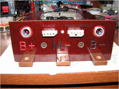

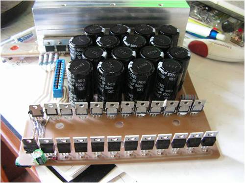

I received an email from a forum member over at fieldlines..... which I will post here, just so people can see how helping out others can have ramifications you cant begin to guess at..
I have helped create a monster...
Subject: methanolcat from otherpower
To: "oztules" <oztules@bigpond.com>
Date: Saturday, October 31, 2009, 2:03 AM
hey John
Not sure if you remember me or not, I used to ask ya questions about electronics and we worked together on a load controller I was working on for a windmill, later on asking some advice about a motor controller I was going to build for an electric motorcycle.
Well here it about a year later and I have the controller completed, in the past year I have learned loads about electronics, bought a used oscilloscope (cause I knew I would need it to be successful) spent well over a hundred hours researching and designing (even blowing up parts from time to time) designed the pcb, made the pcb, cooling rails, enclosure and every thing else I couldn't buy.

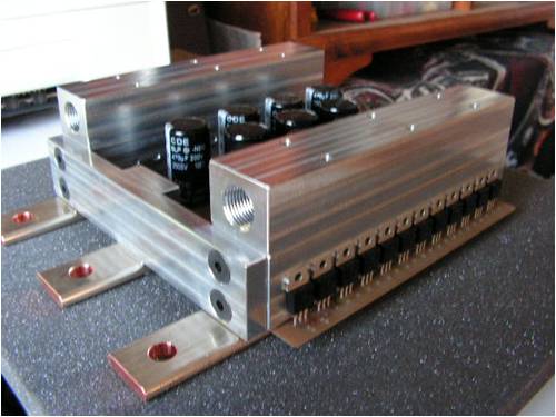

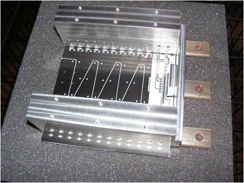

The controller specs are 200v max and 1220a peak, its liquid cooled so should be able to handle quite a bit of current continuously, has 3 throttle ramp settings (mild, somewhat aggressive and race) has adjustable current limiting, adjustable pwm frequency (although 18k seems to work good and keeps annoying noise out of the motor) open throttle shut down (in case theres a break in a throttle wire or the pot goes bad) and an on-board voltage regulator (15v) to supply up to 15a to the mosfet driver and power the control circuit.

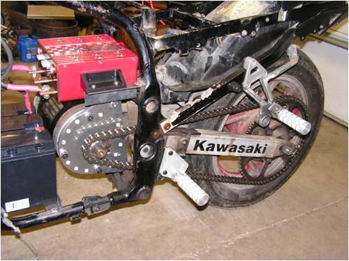

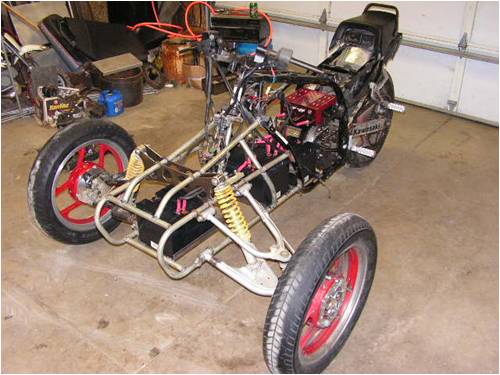

My main project was to build an electric reverse trike and heres a link to it on youtube doing a burn out, fun fun. http://www.youtube.com/watch?v=pY5c_ge-cBg
I still have more to do to the bike (body and other assorted things) but so far I have had it up to 85 mph and get around 25 miles per charge (depending on how ya ride it of course)
I just wanted to thank you for helping me in the beginning and see that your help has encouraged me to succeed on this project. I'm a machinist by trade so thats why all the fancy metal work, I have tons of pics, heres a few, I have more if ya want to see more, hope ya enjoy.
Had to put off windmill for a while due to back injury but will return on that next summer.
Thanks again, Matt

Matt has made a monster. All those mosfets will require a substantial power supply to drive them effectively. I don't see many batteries yet. Must be a way to go yet till it is completed. I think this would be a candidate for a LiPo pack.
The other place I have seen almost as many mosfets is in an inverter. A 20kW unit I designed in 1988 had 36 x 400V Mosfets, and this was bad enough in the control system. The heatsink was a fan forced, air cooled number. This unit above is 200kW capacity, and is a major item. I hope the fusing is up to it. I think Trev gets about 500A peak in his EV.
Gordon.

Trailer, theres no trailer, the batteries are on the bike in the pics, just hard to see, all 10 of them.
Running nominal 120V, but charge the pack to 140V, the batteries are my limiting factor, the most power I have seen is 434 battery amps, and that is from a dead stop, full throttle using medium throttle ramp on controller, which is aggressive but not out of control.
Problem is though that the batteries are SLA, 18AH at that so my range isn't so good and the voltage sags way down when I get on it.
Would love to have some lithium's if anyone is willing to donate them.
My goal with this was to be able to ride to work and back (16 mile round trip), and show off like we all love to do. The way its looking though, it may turn into a drag bike, hard to say at this point, lithium batts are expensive and lead acid isn't cheap either, I can't go 16 miles on what I have and new lead acid (50AH) would be $600 - $700 anyhow and if I was gonna do that I would give the extra and buy lithium batts.
I may just sit on this project for a bit and see if lithium batts come down in price, has to happen sooner or later. I can still ride it around and have fun with it, like I said maybe hit the drag strip now and then.
The controller is capable of 200V max and 1220A peak, those are maximum numbers, I would never push those limits though, not continuously, I would most likely never go over 180V and 1000A, should be fine with liquid cooling, not even using liquid cooling now and it barely gets warm, course longest trip has only been around 6 miles.
