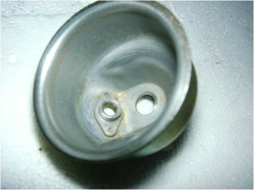

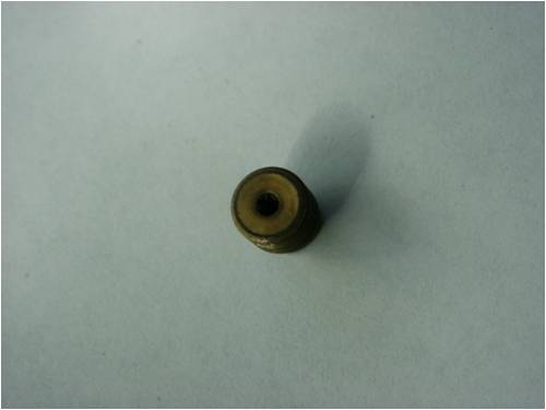

Today I realized how much of an idiot I have been, I went to use my back up generator to drill some holes in formwork out of the range of power from the shed, I took my trusty back up generator, topped up the fuel laid out the leads ready for a productive session.
Guess what it wouldn't go, Pull - Pull, puff - Puff, but nothing. Tipped a little fuel into the aircleaner and got a chug chug, but thats all, not good for a relied on back up generator.

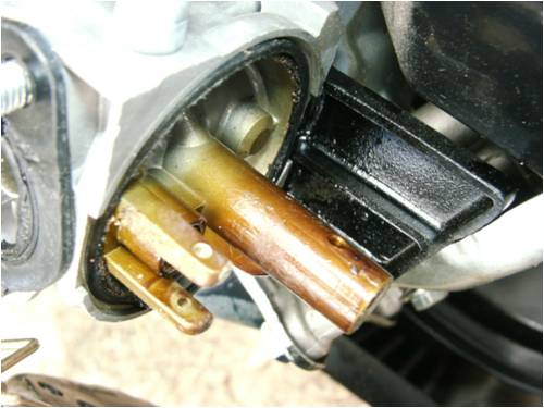

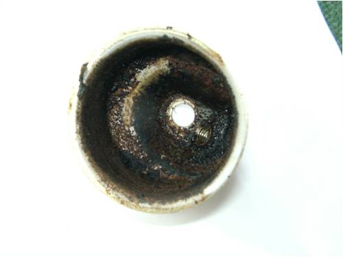

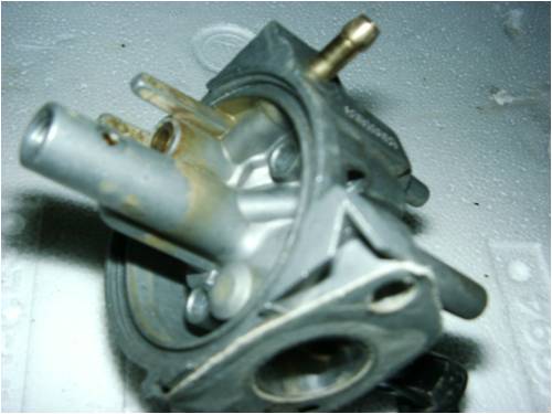

To check the fuel I took the drain plug out of the float bowl of the carby, and shock horror out came an assortment of brown grunge, something like flakes of mica mixed with sticky gum.
The revelation hit, last time I used the generator I hadn't stopped it by running the petrol out of the carby, I had just turned off the ignition and thats it.
The petrol left in the carby had turned into a varnish like substance and clogged up everything, this is why I am an idiot, because I know this happens, the composition of unleaded petrol is such that if left in a container exposed to air it turns unto this gummy grunge that would eat the horse from under the rider.

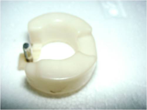

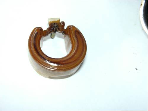

This brown varnish like substance coated everything and had completely blocked the main jet, and glued the needle into the seat so no more fuel could get in, in the pictures it is after I tipped all the loose grunge out, the rest of it was a real worry as it was as good as epoxy the way it stuck to the metal I could only just scratch it of with a screw driver.

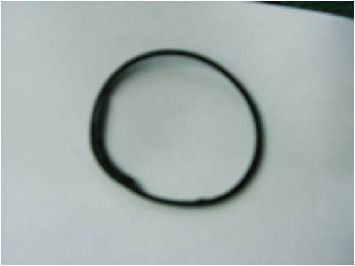

It was so corrosive that it had eaten the O ring that forms the gasket on the top of the bowl and included a bit of the o ring molecules into the toxic sludge no doubt.
After half an hour trying to clean it by manual methods I gave up, I was making no progress at all, so into the solvent bath it went, a mixture of acetone and paint spray thinners, four hours later it was a bit softer so I could remove it with a high quality Chinese paint brush which it dissolved, and some fine steel wool.
The results:
Not perfect I know but a hell of a lot better than when I started.
Tomorrow I will put it back together and hope I haven't lost any parts.

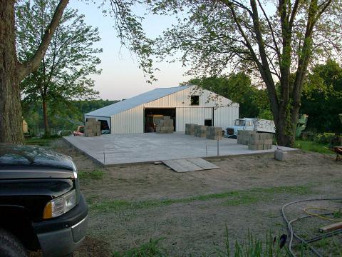

I layed 2 courses of cement blocks , first, for my new garage. It helps the building inthat it gets it up away from the splash of the rain and also lets you have a higher interior work space, "you can flip a sheet of plywood", without takeing out a light, and allows the windows to be higher, letting in better light.
A small additional cost compared to the entire project, and makes a huge differance. Worth considering.
