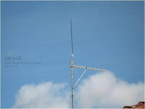

I have such an antenna, which claims to work for that 850 MHz band, but I am leaving it inside the house in the metro area (full bars) and have not mounted it. Do you think in the bush I will get more than 1-2 bars if I mount it outside?

Big YES to that. The higher the better, but you get to a point where the losses in the extra cable offset the gains in power. Best place is the middle of your roof, it acts as a ground plane. Or you could build a yagi like I did, I had good results with that.

It is different for both places, in the city signal strength gets you speed, in the bush the high gain antenna gives a lower noise floor, so with lower levels of background interference a quality signal can be had with low signal levels. mine happily runs at -95 dBm (no bars).
A 10 or 15 metre low loss cable (LL195) with quality swaged FME ends is about $60.
Technically 15 metres is over the length limit for this cable but the added height more than compensates (provided its aimed around the trees)
the yagi in the photo is a RFI model yb15 850. 13 dB gain ???
I cant remember what the whip is but it is about 9 dB gain
Some of the multiband antennas have very poor gain on the Next G frequencies, I have tested some that claim 8-9 dB but yield 2.5 or 3 dB on the 850 Next G signal.

Thanks for suggestions. The above is a link to a home-made Yagi and had I seen this before may have saved me $120 for the RFI whip. I may just build one like the above as I can use two, one for the bush and one for the city.
With a Yagi I need to know the nearest tower, for which Allan's link will be useful.
