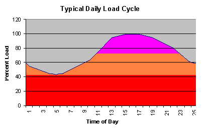

Well! Gentlemen I am with you. But we need to have an understanding of the magnitude of the problem we face before we can arrive at a solution. In reality there are several problems. The major ones are political, but stem from a view of the economy perceived as the instrument of politicians retaining their power.
Our society has operated its power stations for many years based on the economics as they have been perceived. More on this later. In 2003 at a conference in Brisbane, a paper was presented that quoted the costs of generating 1 MWhr (1000 kWhrs) by coal, gas (in combined cycle operation) and wind. The numbers were $34, $41 and $78.
The load cycle curve shown is roughly right for summertime in our societies, I have shown percent load for the vertical axis, it is actually read in megawatts, but for each state the values are different.
We use coal based generation for the area of the curve shown in red. That’s where most of the energy is consumed and we have used the cheapest source we have, ie coal. This part of the curve shows “base load”. It is constant, for very long periods of time and that ideally suits the coal based steam generation technologies. It takes a couple of hours to get a big turbine is operating and once set, it just keeps going. It also takes a long time to get them off line as they require very careful cooling before they can be shut down, to say nothing of coordinating the slow down of the
coal crushers and conveyors.
The orange band is the next cheapest to generate, gas being a major source here, especially in recent years. Gas turbines can be up and running in a few minutes. Combined cycle processes reduce costs partly. This is where say a gas turbine generates some electricity and the exhaust heat raises some steam and it also generates energy, this avoiding the waste.
The mauve upper band is reserved for the more expensive options- Snowy Hydro, wind and solar.
Now John’s argument is that we can never replace the base load component with renewables and he is right unfortunately because we really could not rearrange our lifestyles sufficiently to do without the existing base load convenience. Yes, it would be OK if we had sufficient alternative generation Australia wide to generate the same number of megawatts for the same number of hours and still have enough to fill in the orange and mauve bumps. But that sadly does not seem realisable, due to the huge investment necessary, the interconnections needed, the fact that we’d need serious concentrations of turbines everywhere that a wind might blow the fact of its unreliability and more.

Sorry Gentlemen, here's the pic.
