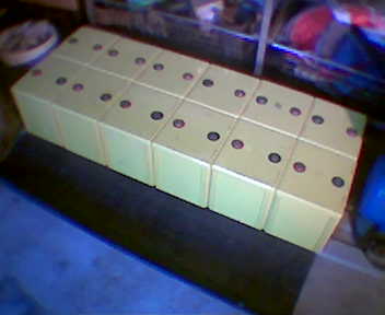

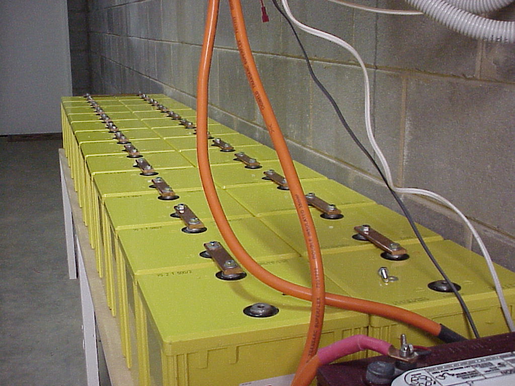

You mean like these:
And my main battery string:
Been using them for a year and they've been fab. No issues whatsoever. Who's the seller? It its my mad mate in Melbourne, he is prepared to haggle on price, especially if you're taking 24 of them. Nice chap too.
I hooked up the trailer and went for a drive. Melbourne is only 3 hours each way for me, it was a nice saturday morning drive. Down, picked up my solar tracker and the batteries in one trip. What I saved in freight for one covered petrol down and back, the other was just a bonus :)

Hi Ross
thank for your kind help as l didnt know that you were using same batteries as l looking for on E-Bay and the seller is 63ute or contact ej2106@hotmail.com but dont know his name . kind regard ian
