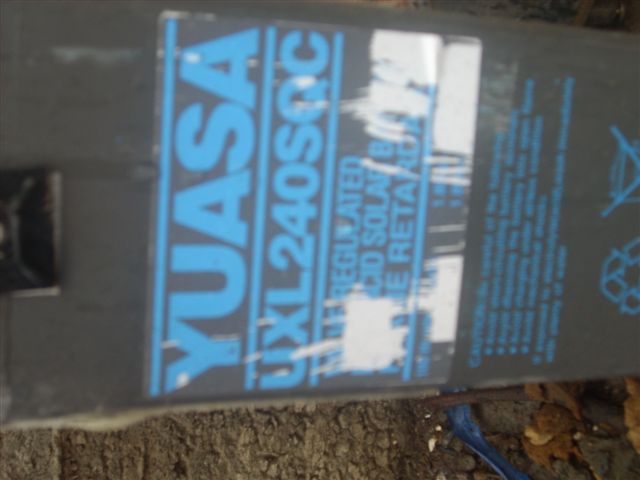

Hi Bruce and friends
For the last fews day i was unable to send photos earlier due my modem fail had to get replacement so now l have 60 batteries from scrap metal and will recharge over the weekend to find out if these batteries condintion if is no good l just simple take it back and if it all fine will buy it at very good price and however l can't find information on webs site as batteries are 5 years old are 2 volt@240 amphr

Hi Dwyer,,
a bit scratchy ,but that may just be from pushing them around the pallet..Bloody heavy,not many souls would actually lift and position these ..
First check for 2V or very close,,establish how many you want to keep ,look closly for "bulges" "cracks" ( a give-away for a crack is a fine line of white residue ).
Apart from that you will have to wait till fullcharge ..I'll find my "Usasa" catalogue and get you the float voltage,,14.2v fo a string of 6 ,in this case ,I think,never go over this ,as being valve regulated,it's a "one-way" safety device-can't replace water ,eletroyte is a paste anyhow.-these type of batteries can be positioned on their side or upright.
Nice big batteries,,a good score
