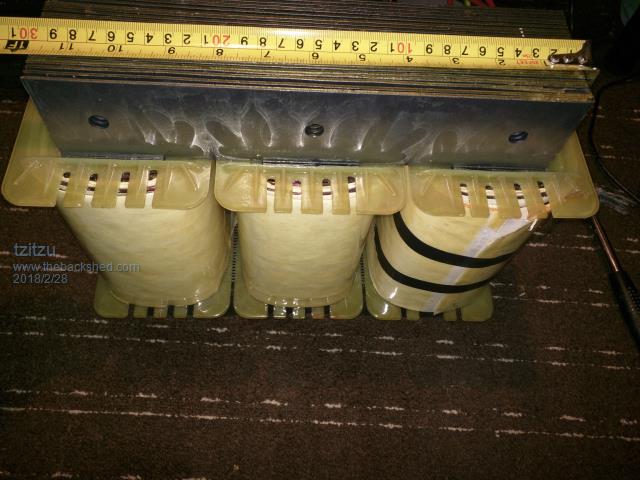

To put a a month story short, I got across a toroidal transformer rated at 2.5 KVA,
which had to unwind it and rewind it properly to suit the need of an inverter. problem is similar to those I've read in this forum ( no info's about the core specs).

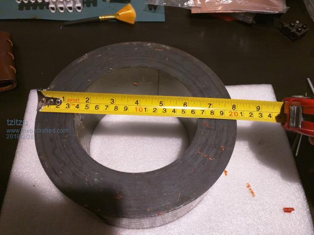

the core itself is D-204mm, d-127mm, H-76mm

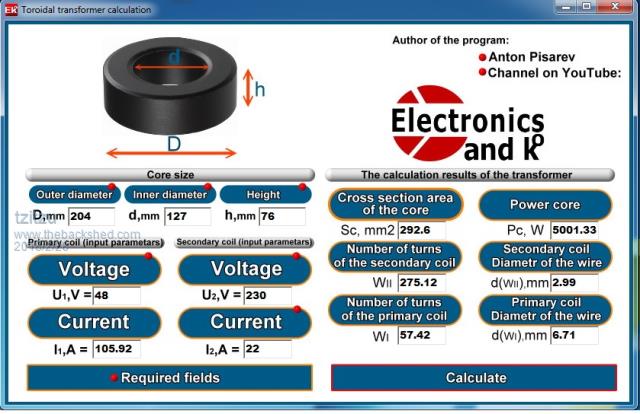

the values I got for the turns would be:
calculating magnetic flux using those values, is 1.2740 Tesla, if I modify it from 58 to 70 turns it goes lower to 1.0556
is it a good idea?

Those figures for the secondary of the Toroid look about right. If your inverter is based on an EG8010 chip you need to change the primary voltage to 26V even though you have 49V battery bank. Output power is going to e more like 2.5KW continuos, it would and 5KW as shown in that calculator for a few minutes.

You need the lower voltage primary as converting DC to AC the peak 48V needs to be divided by 1.44 for the mean AC voltage which is 33VAC. It then needs additional headroom to maintain regulation under load. A 48VDC to 230VAC inverter needs a 9-1 ratio in turns and copper cross section.
The more copper wire cross section you can fit will give you more power but there will be a limit. I have a core which is 190mm OD 100mm ID and 70mm high it will run for extended periods at 4.5KW. As the one you have has the same size hole you are going to be limited to a similar amount of wire. I have 6mm square mm secondary and 38 mm square primary. You may be able to squeeze a bit more in there but the figures in that calculator are very optimistic for a continuous power rating. I am working on real experience with my figures.Edited by Madness 2018-03-01

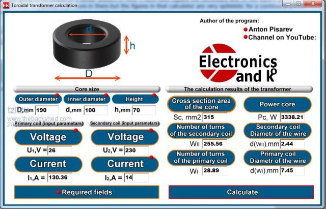

I still have a doubt regarding the core power since you've been kind enough and share the specs of yours, I thought to give it a try and I got this results that are quite similar with your test
Strange is that mine have less core section but longer circumference. could this be the reason?
Should I start winding it as per your specs then test a maximum load see how far it can go?

The cross-section dictates how many turns are required, the hole determines how much wire cross section will fit.
That calculator has secondary current as a required field so whatever you enter there will affect the output. I still think that calculator is very optimistic about what power output you will get for the copper wire size. It could be that the calculator is using power ratings for an amplifier where they are looking at peak power.Edited by Madness 2018-03-02
