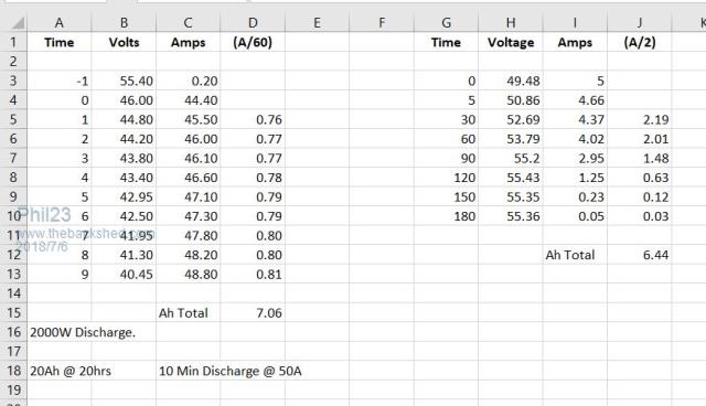

Posted: 11:21pm 05 Jul 2018
Can probably extend the batteries out with a couple of Anderson leads I use for camping, but they are a few metres long.
Still suspect the Charge/monitoring though as I don't see what I could really consider a bulk charge.
Left table relates to discharge, right to recharge.
7 Ah out on discharge seems pretty realistic, considering it's at 40+A, not the rated 1A.
But charge back in only accumulated to about 6Ah, & voltage is more what I'd consider a float than bulk charge level.
seems like a perfectly normal scenario for a UPS, if you dont have daily power failures it has endless hours to reach full charge, if you wind the voltage up it will cook and corrode the batteries.
