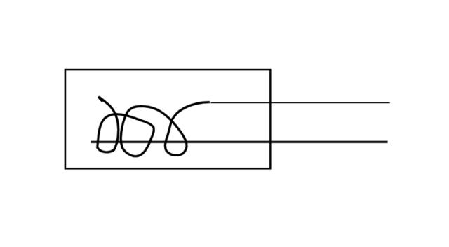

A while back there was a discussion about various methods for detecting tampering/panel opening etc and the best way to proceed.
I found some likely threads but they don't bring up the discussion - maybe too old or something:
Tamper/movement Alarm ideas?
Ball-switch vs Accelerometer....
... any hoo, here's a new thread. I have just got a pack of ten of these little switches which might help.. They are formed of two leads leading to a vacuum(?) filled can. One of the leads then forms a very delicate, "wobbly" spring around the other. It seems any significant movement from any direction triggers it sufficiently - bouncy as hell but who cares, you want the signal right?
https://www.ebay.co.uk/itm/10pcs-sw-18020p-electronic-shaking-switch-vibration-sensor-RDD-FH/153302967713?ssPageName=STR K%3AMEBIDX%3AIT&_trksid=p2060353.m2749.l2649
a fag-packet drawing of the innards looks something like this:
maybe something else to explore?

I know this is a very old thread, but rather than create a new one; I need some sensitive vibration \trembler switches as part of my alarm system. Have received a couple of samples from AliExpress, similar design concept as above, but none of them work unless you hit the sensors with a hammer to the point of breaking them.
Pulled one apart and the tiny brass spring is way too stiff and cannot possibly vibrate as it doesnt have enough mass at the end.
Has anyone recently purchased something like these that are sensitive and actually work??.
