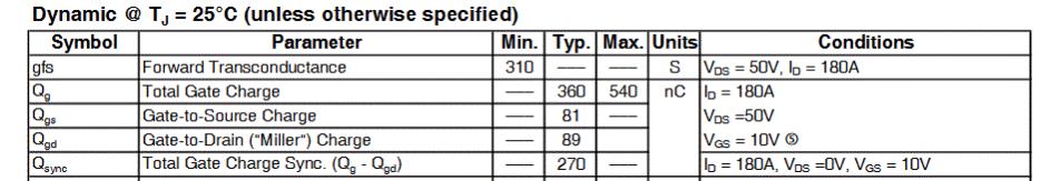

The larger mosfets have a very high gate capacity with typical drive powers of 180-300 nC per device, so in order to switch quickly to keep losses down will require 6-10 amps pulses of current from its driver in both charging the gate and discharging it. The average power though is quite small, a low ESR capacitor across the driver chip rail supplies the drive current.
This is just one reason why layout is quite critical, the driver must supply 30ns rise time high current pulses to each mosfet or parallel set, Trace lead series inductance wants to oppose the current flow and in turn create ringing at the gates that can stuff up switch timing and create High frequency hash and power loss. Hence the best practice of supplying each mosfet with its own driver chip, keeping overall lead lengths to 1-3cm.

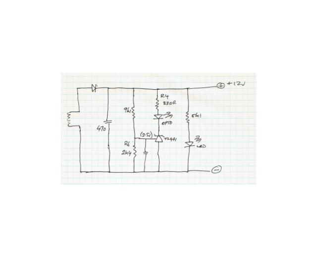

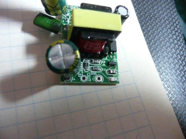

Isolated power supplies were always a bit expensive. I make my own but now there are some cheap ones becoming available.
I do use these B1215S but dont ask too much of them.
I have bought these XL-007 but I have not used them yet. We have good feedback on these units from Warp and Madness. These will take a DC input, perhaps as low as 35 volts.
I have worked out the output circuit - see below.
To adjust the output voltage: Easiest would be to change R6. ie, 1.8k (0603 smd) should give a 15v output.

  mackoffgrid said
Andrew, thank you for the diagram.
In the diagram above I see the first component which looks like a transformer winding.
1. Is that the secondary winding of the transformer from the board?
2. The primary winding was not drawn because it connects directly to the AC input?
3. If so, won't having any snubbers across the AC input and having it feed directly into the primary winding cause some EMI issues?Edited by LadyN 2019-02-08

Natasha, that is the secondary.
No, the primary side is rectified then is using some sort of switch mode circuit to drive the primary. I just wasn't interested in it as I wanted to manipulate the output voltage. All you have to calculate (for your desired output voltage) the resister divider so that the voltage across R6 is 2.5v, the reference of TL431. The opto provides the feedback to the switcher.
This ISO psu is about the best value going. No good in my current 24V project but great for 48V and above.

Posted: 05:20am 07 Feb 2019
Those used to be available with 15 volt outputs, but I haven't seen those 15 volt versions advertised for many months.
If you need 15v you can use a 12v supply and change R6 from 2K4 to 1K8. That will get you about 15.1v regulated output.
It will no longer supply the full maximum specified rated output current, but as an isolated gate driver supply it will have plenty of surplus power.
I run seventeen of them in my inverter. One provides +5v for the driver board, and there are four +15v supplies in each of my four bridge inverters. All seventeen running only consume slightly under 5 watts, which is the total running power for all the electronics in the whole inverter (with the four output transformers disconnected).

>> would you happen to know (or guess?) the surge/peak demand from the FET's capacitance on these PSUs?
This is determined by the number, type of mosfets being used and their switching rate, look in the devices data sheet for the total gate charge in nC, then you can work it out: IRF4468 below.
High-side mosfets will require 2 isolated supplies per bridge (hint source voltages are not the same)
