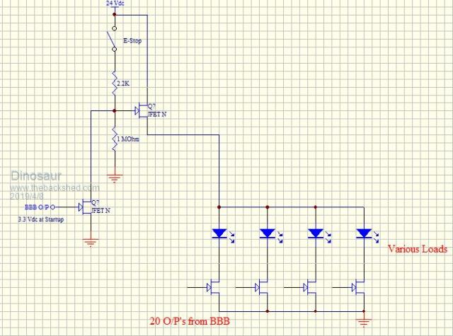

Testing a "cape" for the Baglebone Black.
It has 20 N Channel Fet's as outputs and 8 opto couplers as Inputs.
The board is designed to handle about 20 Amps at 24 Vdc.
So basically I can drive high current loads (Stepper motors etc) direct.
The Fet's are STU85N3LH5. RDs of 0.005 ohm.
It all works well except at power up of the BBB, all the outputs go to 3.3vdc
and thus turn all the 24 vdc outputs ON.
Anyway, decided on a new approach.
Firstly an E-Stop decides if the outputs should be allowed ON.
But people forget to reset the E-Stop, so not foolproof.
OK, so lets use an output to enable the Supply voltage, however that output is
already ON when you turn the power ON. That's when I dreamt up the circuit below.
Taking advantage of the fact that the outputs are at 3.3vdc , I use it to drive one Fet
to pull the other one Off. As soon as the BBB has powered up, and I have initialised
the outputs, the 24 VDC rail will be allowed through to the 20 O/P's.
My doubt (and that is why I am posting) is if all of the other 20 outputs are off,
the voltage rail above the 20 outputs will sit at 24 vdc.
In fact it will always sit at about 24 vdc.
Should the 1M Ohm resistor be connected to ground or the Source leg (Power rail to 20 o/p's)
Will this circuit even work ?
Problem with loading pdf and jpeg snipit not good resolution.
Top R = 2.2K Lower R = 1 M Ohm
Bottom Fet is driven by O/P.

Circuit seems ok to me at first glance and should work fine - you have used the issue against itself to effect a cure. I think to be more technically correct 1M resistor should go to ground not the FETs source. Otherwise with no loads there will be a voltage measured at the LEDs (sneak path through 1M resistor) that might be annoying.
I like off to be OFF.

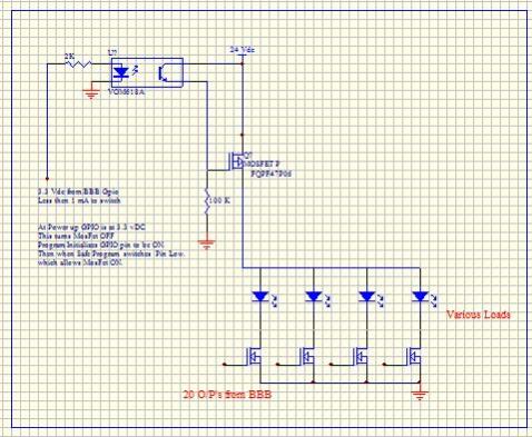

Just an update to my circuit above.
tinyt I played around with some transistors I had (2N2222) but could not get the N Channel to to turn on fully.
I think a lot has to do with the N Channel liking to sink the load in the Drain leg.
All 20 of my outputs are in the Drain and deliver the full 24 vdc to the load.
The best I could get was 22.3 vdc.
Anyhow after a lot of trial and error, I concluded that the P Channel is the ideal
candidate because it likes to supply the load in the Drain leg.
And that is the purpose of this, to supply power to all the loads.
I tried dozens of ways to drive the P channel with a N channel, bit in the end the opto
was the best solution.
So for anyone else contemplating this the circuit below.
EDIT: The part numbers are: P-Channel FQPF47P06 , N Channel x 20 = GK1CL509, Opto VOM618AEdited by Dinosaur 2019-05-04
