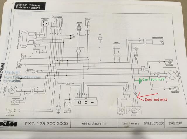

I need a little help from the experts! I have a 2005 KTM 300 EXC that i bought a year or so ago. None of the lights / trip meter worked but she runs just fine. So I have pulled her down for a rebuild and while I'm at it I decided to fix the electrics...

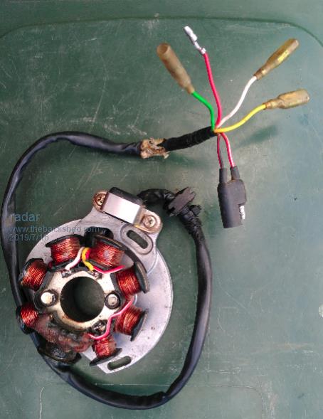

Well its a dogs breakfast and somebody has been splicing away. From what I can gather at the stator/magneto is off of a "EXC-US 200-250" so it has 4 wires for the CDI and 1 for the AC lights like below.
But the majority of the wiring is like the below "EXC 125-300" minus the White wire coming out of the Stator/magneto.
Can anyone confirm that i could ground the white wire out of the Reg/Rec. to achieve the desired result? As drawn in pic below.
Any help would be greatly appreciated!!

Only had a bit of a glimpse, but for trial and error you could ground the wire with a fuse link, so if it is not correct then that shall blow, right?

Your beasty can have 1 of 3 types of Ignition/Mag/Generator
It depended on the dress of it at ordering.
Part No 54839004000 2K-1
Part No 54839104000 2K-2
Part No 54839204000 2K-3
What you show in first picture is 2K-2 Type , If looking for
the correct type to match the 4 Wire Reg/Rec you want a 2K-3
May-be try as Ralph suggested Adding about 2 Ω resistor
and a fairly small quick blow fuse.
Or possibly the wire has broken off.

Thanks Radar! This was really helpful. I can confirm my stator is the 2k2 version with one side of the charge coil going to ground.
So I will test running the white wire on the rectifier/regulator also connected to ground.

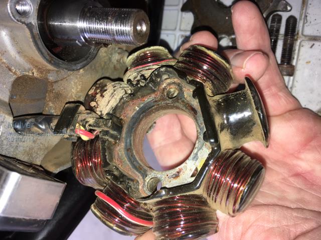

Mulver
Joined: 27/02/2017
Posts: 160

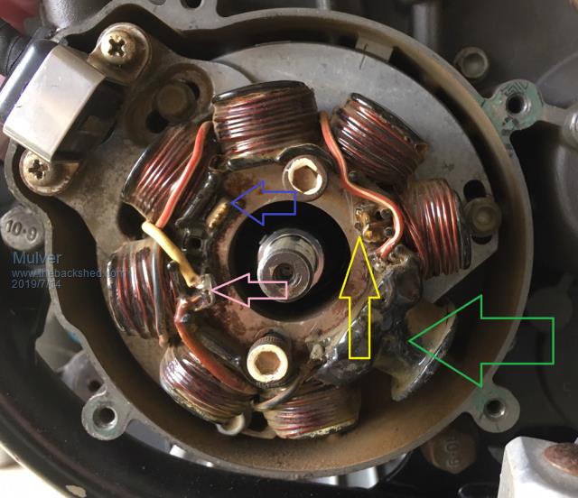

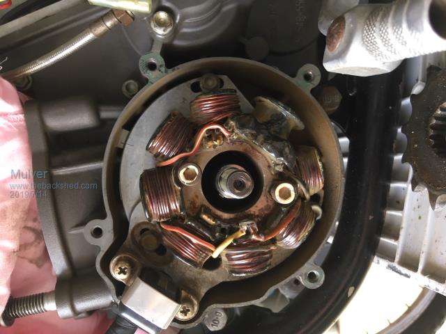

Posted: 05:47am 14 Jul 2019

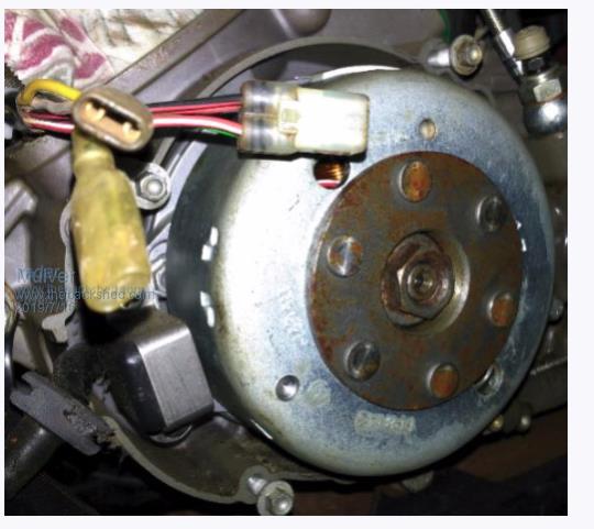

Tool acquired, flywheel off, even more confused !
No white wire!
Is the green arrow pointing to the CDI coil? (red and Black Wire)
Yellow arrow is ground.
Pink arrow is yellow wire and connected to one side of the coils
Blue arrow does not appear to be connected to anything.
Edited by Mulver 2019-07-15

Posted: 02:56pm 15 Jul 2019
That stator is a 2k3 140 Watt .
Mnn Seems to be wired different than i have seen , Not saying it is Wrong though .

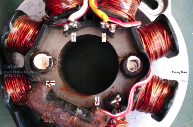

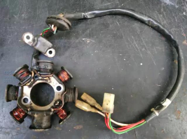

Here are some pictures of a few 2k3 i have .
Notice the wiring difference looks like one of your poles
is not soldered to anything , on mine .
yellow to ground through coil
White to ground through coil .
Black/Red through coil to Red/White

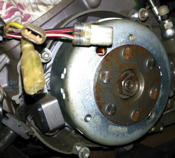

Next Picture is a 2K3 from 1998 Note the Wiring Tails
And compare to next photo
Next Picture is a 2k3 from 2008 Note the Wiring Tails
What type of tails do you have .
Next Picture is from a stator 300EXC that was up for grabs on
GumTree last week . Note The wiring tails . Pretty poor picture
but if blown up you can see 4 wires on the stator ,
The Pulser wires RED & Green do not go to the stator .
Normaly 4 wires on a 2K3 stator for + Two for the Pulser?
Can you snap a few shots of your harness , Mainly the voltage reg
and its tails ,
The intermediate harness Tails also,
It is the one that plugs in to cdi .
