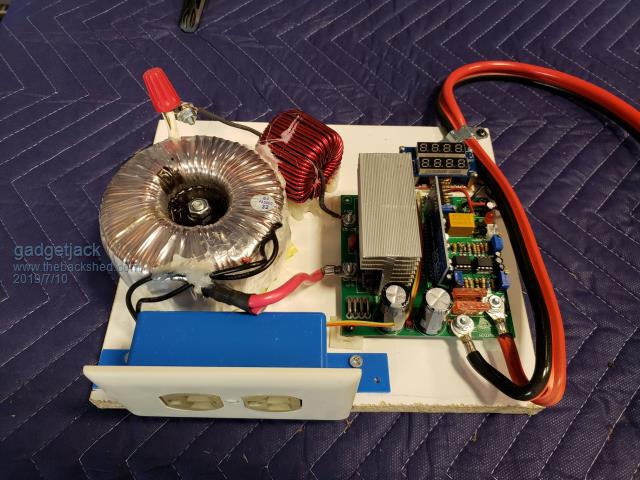

Here is the same board wired up for a 600-700 watt inverter , but at 24vdc.
Ben is correct. It is a very tough little board.

gadgetjack - thank you for the nice picture. If we break it down to components:
1. on the left you have the toroidal transformer
2. in the middle you have a choke
3. on the right you have the brains and control board. The ESG002 (which I call "brains") is standing up vertically alongside the heatsink
4. offscreen you have the power source
I. Is that correct?
II. If so, where does control board come from?
III. Can the control board be modified to input 120V DC?

LADYN
1. yes that is correct.
2. Ebay
3. It is a stock board , you order for 12,24,48v input.
No modes to the EGS002 other than to make it 60HZ.

Thanks for the reply GadgetJack. One last question? Where did you source the choke coil?
I'm considering E-I core transformers from scrapped APC UPS units. Is a choke still required for iron cored E-I transformers?

I pulled the choke from an old Xantrex 1800 inverter that went belly up. They are pretty good inverters till they die, then it is a big mess. Lots of burnt parts.

If you are going to use an E-I type transformer for an inverter, you will still require a choke for low idle consumption and generally (from my last experiment) runs more efficient than without it under load.
