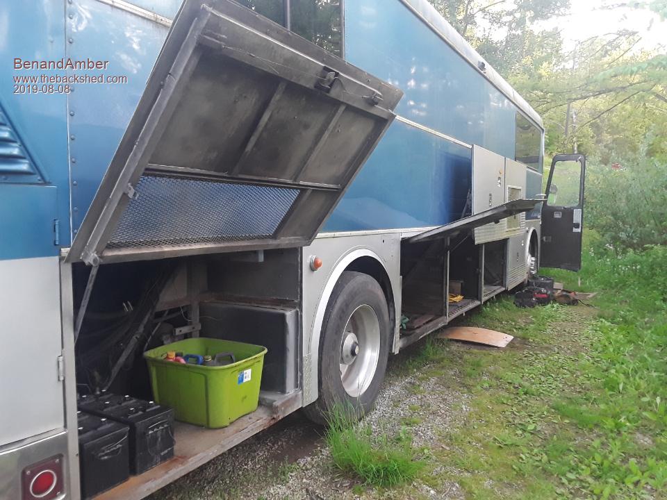

I already have an Onan generator I don't use it and haven't used it since I've built my first inverter
It is the most awesome generator I've ever owned as far as the way it's built
Generators are loud noisy smell bad and take fuel to run
My solar system will likely meet my needs going down the road but just want a little extra just in case
Was going to build a gas powered battery charger but decided I will be running my 6v92 anyway and might as well take advantage of that
48 volt alternator will be almost no maintenance regulate itself and be there if I need it
plenty of space for it no modifications necessary just bolted on run wire to my battery Bank and forget about it
No transfer switch needed
That just makes good sense all the way around for me

There is a duct going right down the center of the bus with the hoses for the heater core at the front of the bus
I believe you are right about me needing to tap into that and use it anytime the engine is already running for another reason
It is a diesel pusher and the motor is not loud at all on the inside my Onan Generator is 10 times louder than the bus just sitting there running

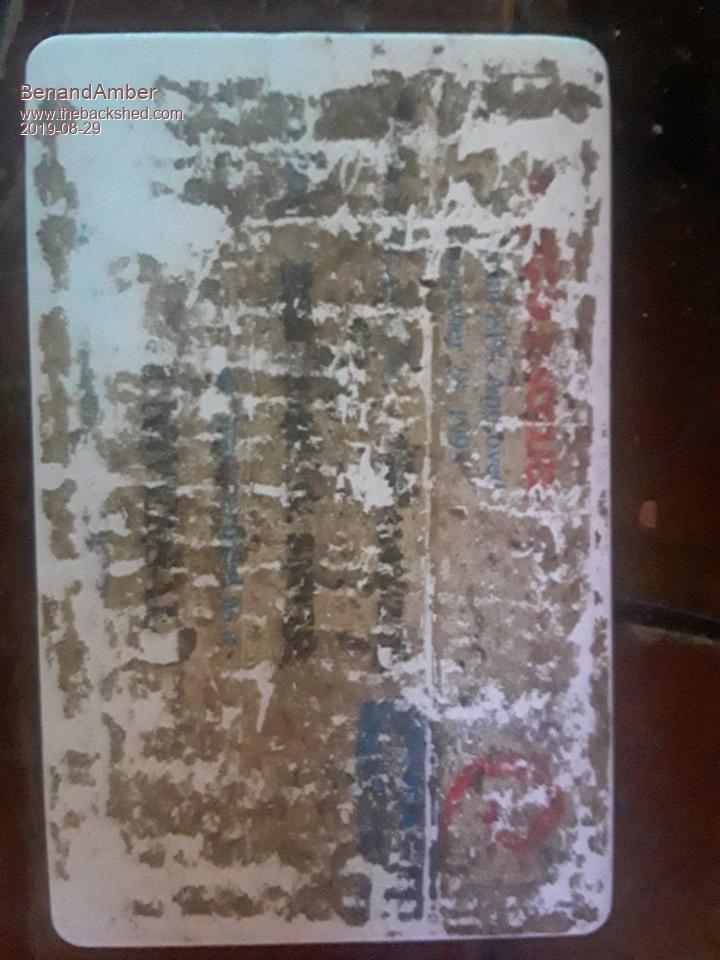

Can anyone on here guess what this is
It's been in my wallet through many wash Cycles and many accidental jumping in the pool
The information is so distorted I think it's going to take another person having one to figure it out
