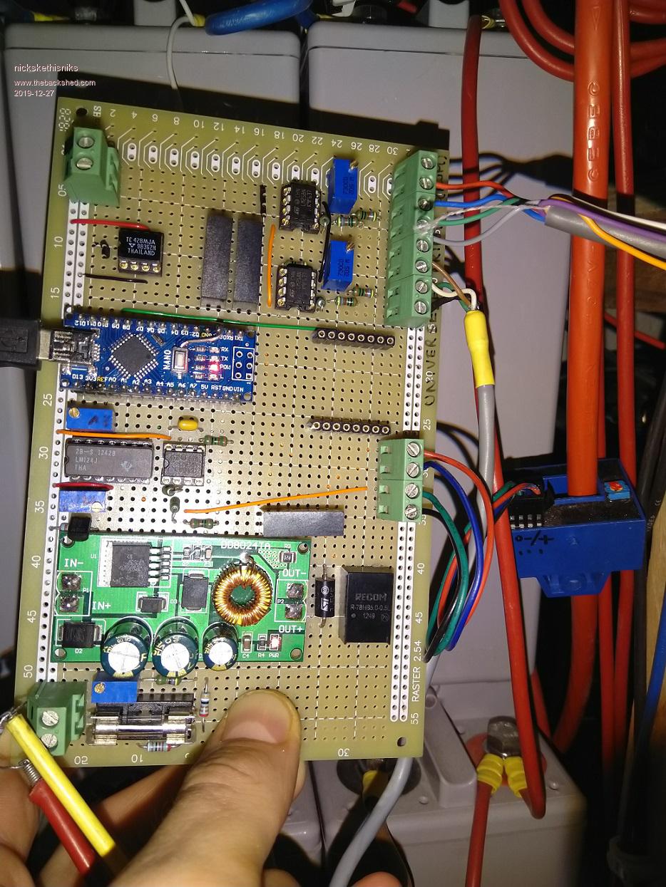

Arduino nano on a prototype pcb, with dc/dc converters for the current LEMS, voltage dividers, opamps to condition the signals, some other things...
The arduino nano sents all the data thrue the usb (programming)cable plugged in the Raspberry Pi.

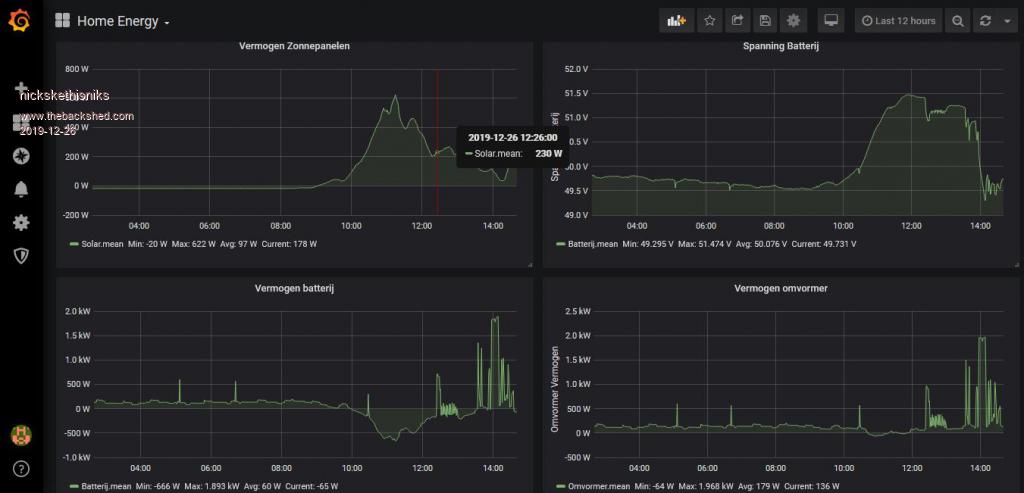

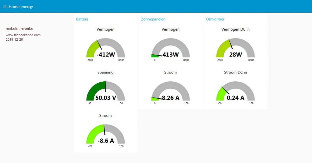

On the RPI, I'm running Raspian linux software, Node Red for easy programming a UserInterface. I use Influxdb for collecting all data in a (SQL kind) database.
Grafana is used for making nice graphs.

I will upgrade the nano with an arduino due in the future because of the 12 bit inputs, better resolution.
But then I think I would make a pcb for it. It's allways taking me 1-2 whole days to solder a prototype pcb... Drawing a pcb takes less time in the end.
Like the opamp circuits for converting the negative and positive current to a positive signal... I use +-12V powered LEMS....
So the Inverter (because of the backfeeding) and battery current can be negative and positive... Make's it a bit more challenging.

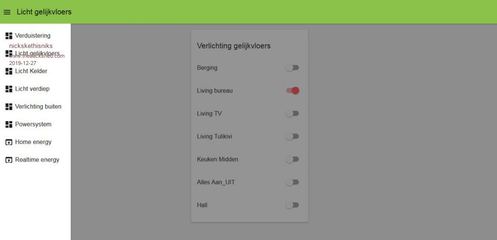

My nodered UserInterface: ( realtime monitor for the data, verry easy to use because of the many youtube documentation)
My Grafana graphs:
For controlling our lights we are using nodred too:
(Im using a rpi for controlling an arduino due with relays connected)
This is the pcb that's connected with the Lem's and measuring the battery voltage, I only measure dc currents, no ac measurements at the moment, that is for the next version.
