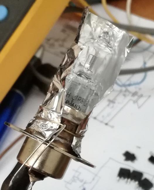

Pete Locke
Joined: 26/06/2013
Posts: 186
Posted: 05:05am 19 Jun 2020
Only had an ex lighthouse 12v 60w lamp, so jerried up a tin foil reflector. Left a gap between the light and the foil, and proceeded to take a couple of bits off a dead fluro electronic ballast. Three good MOSFETS, an optocoupler, and for shirts and giggles a small cap. The main bits needed for a model engine glowplug driver. All survived. Took about a minute and a half to heat the board up enough, but they came right off, even though they had the glue treatment to hold them while being manufactured.

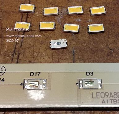

Pete Locke
Joined: 26/06/2013
Posts: 186
Posted: 07:48pm 13 Jul 2020
Hi BenandAmber.

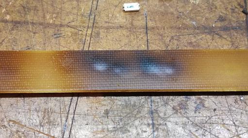

It does take a minute or thereabouts to heat the joint enough to melt the solder. Quite different from a normal soldering iron. The whole board needs to heat, so slowly moving the lamp around the area of interest is needed to do this. The last board I desoldered with this method was an LED strip. The type used in a fitting that replaces fluorescent light units. This required heating the under side of the board rather than the top where the LED chips are, due to the chips having a heat sink in the middle which is soldered to the board. I'm still learning the technique with this, but it works well as my hot air station still isn't here. Ali Express is a great place, as long as you aren't in a hurry :-).
As you can see, the board will get toasted if too much heat is concentrated too quickly. But all the LED chips survived. Bright little suckers as well at 30mA.
Hi Andre.
Yes, a hot air gun would allow better direction of heat, but I'm still waiting for mine to turn up. This exercise was simply to see how well a light bulb would work as demonstrated in the YouTube video. 60 watts seems more than enough for the task.
Pete'.
