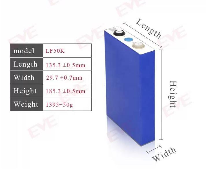

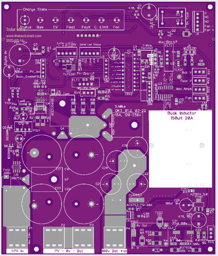

Am ditching the small petrol 230 ac generator used when out in the field, as quite often it runs out of grunt and makes a lot of noise. Rather than get a bigger better one have decided to make a portable high power unit using a 100 volt bank of 50 AH Lifepo4 batteries and a DIY toroidal core AC inverter.
100 volts is perhaps high for a portable unit, but the batteries are quite small and the higher voltage means lower currents with increased efficiency. I want to have peak power outputs of 4 KW or so to start large power tools, with a continuous output of about 1 KW; This suits using a small toroidal core inverter.
The 32 x 3.2v 50 AH batteries are suddenly very cheap here in NZ at < $50 each, brand new "A Grade" EVE cells, each battery has a spec of 160 watt Hrs, so 32 of them will give me a usable capacity of just over 5 KWH @100% discharge.
They will require a BMS, luckily the boards for that from another project, are in transit from JLCPBC.

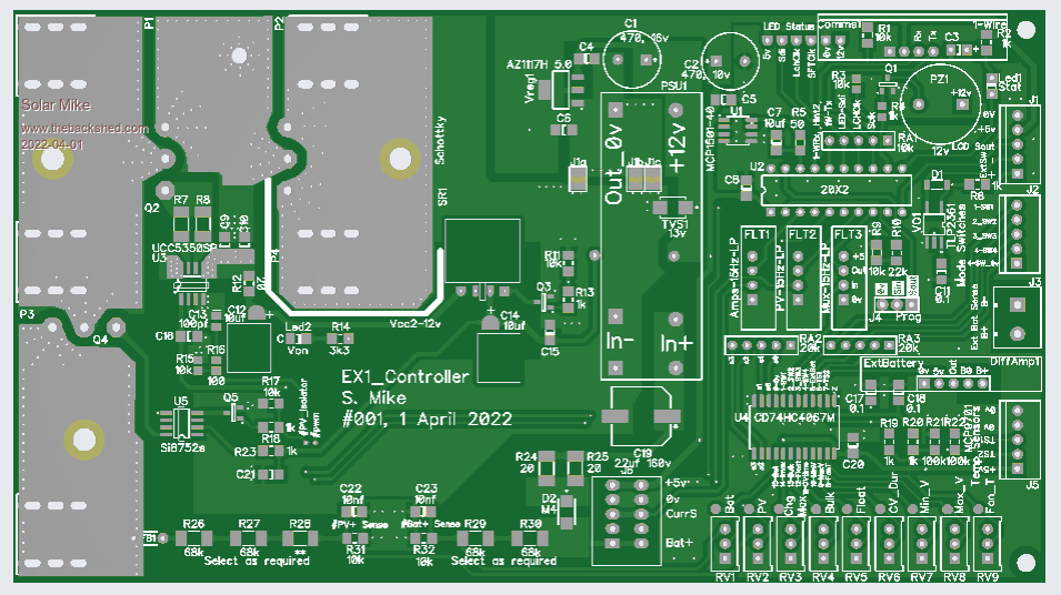

For charging the bank, have designed a new 200V PV controller that has an input from the BMS to cut back on charge current when the BMS is balancing. I will be able to plug it into my current PV array or perhaps add a small up converter to allow charging from a lower voltage input source.
PV Controller 140 x 165mm:
More to come....

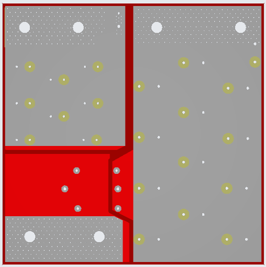

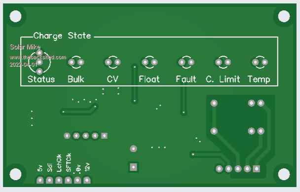

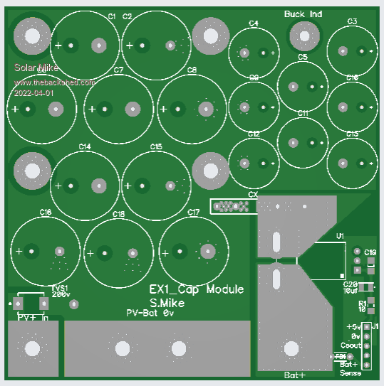

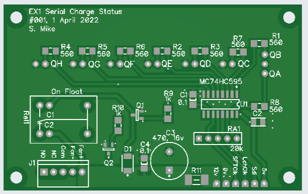

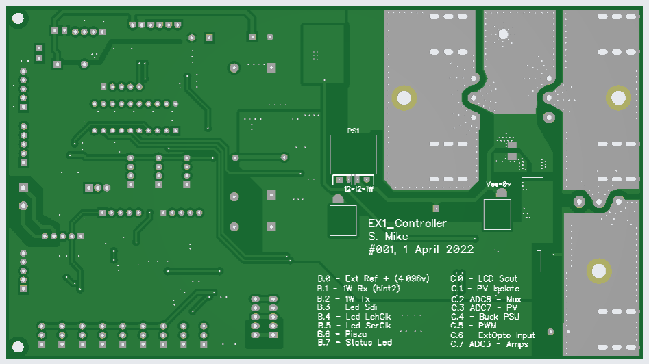

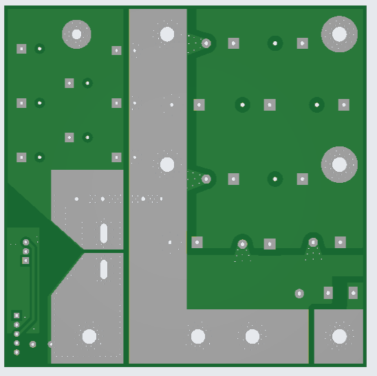

Whilst waiting for the pcb's to come back (air mail post this time), have been doing some experimenting with the PV controller design.
In order to arrive at a better layout for the power devices, thought about placing the main electro caps on their own pcb, this is bolted to the mother board via high current standoffs. Here I have use many smaller long skinny caps in parallel to get a lower esr and better heat dissipation. To use up any larger 35mm caps, a new cap only pcb can be made very cheaply without having to re-design the who thing.
By doing this the pcb traces for the power mosfets and the caps can be optimized for higher current, also having a more efficient layout for the gate drivers.
Will be interesting to see what the max power output is, the main mother board is 100 x 180mm, 100x100mm cap pcb bolts on top at one end, there isn't much clearance so a couple of components sit in cutouts. CPU and controls are well away from high current switching traces. I have used a few plugin modules for the analogue noise filters and a small pcb containing the circuitry for a differential voltage sense of the battery terminal voltage. The serial data led charge status pcb allows the leds to poke through a slot in the front panel, or the serial LCD display can be used instead.
Control Motherboard 100x180mm:
Caps 100x100:
Serial Charge Status 80x50mm:
Differential Voltage Sense:
Mike

Sorry for disturbing. Is it tradition here not to give project schematic but PCB? I could imagine that there are unique people, who can read PCB as schematic, but I'm not belong to them.

  Kabron said  Sorry for disturbing. Is it tradition here not to give project schematic but PCB? I could imagine that there are unique people, who can read PCB as schematic, but I'm not belong to them.
Yes a schematic would be nice, I don't have one, normally I create a schematic to check the design process, but with these two somewhat experimental pcb's to save time, both boards have been designed direct to PCB without drawing up a schematic first, sorry I don't even have a pencil drawing.
I have sent the gerbers off to be made, once I have tested the boards I will draw up a circuit and publish it here along with the gerber files and software.

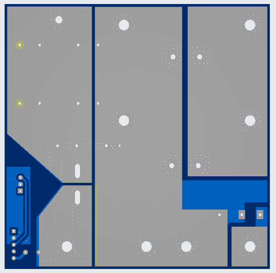

Edit: Additional cap pcb, for 35-40mm input electro's and 19mm output types.

schematic
When you start dealing and laying out POWER ELECTRONICS most components are laid out in positions for very precise reasons. Schematics are good once the board is made and working.

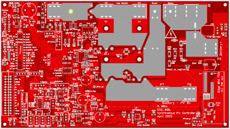

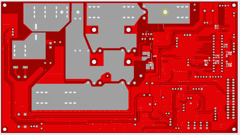

Posted: 06:15am 29 Apr 2022

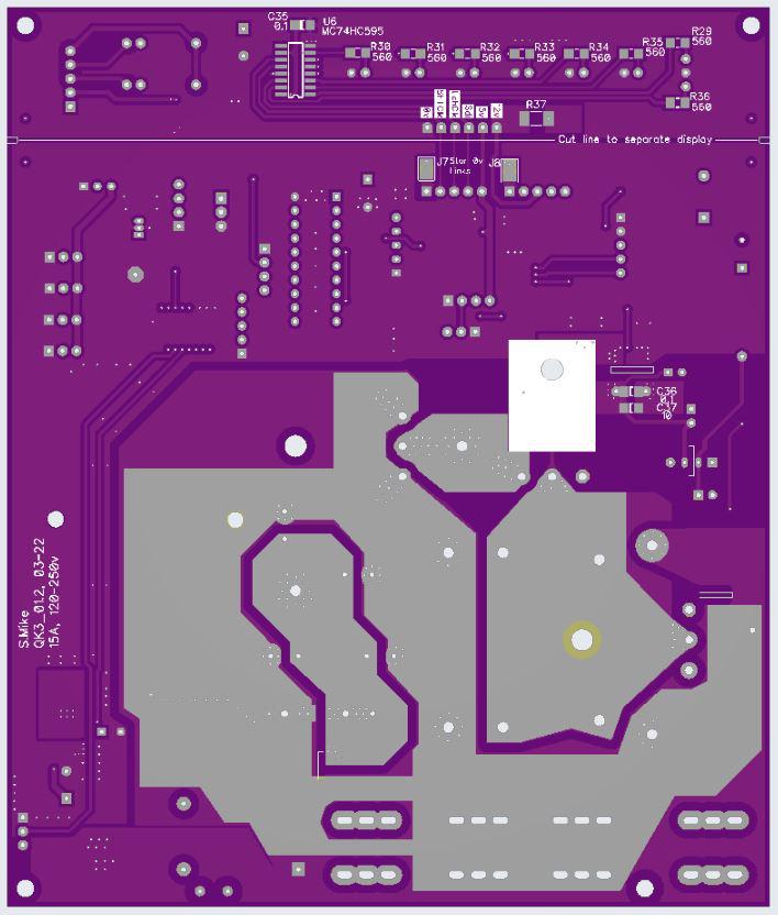

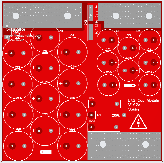

I haven't actually sent the all the gerbers away yet, as its cheaper to keep the weight down for standard air mail postage, which takes only a week longer than expensive fast courier. With the semiconductor shortages (now includes standard caps, resistors) its getting almost impossible to build anything. So have made another experimental design for a fully synchronous PV charge controller using dual mosfets in the switching elements, now I can use some lesser rated components that are readily available and I have on hand.

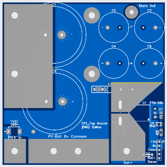

To get optimum trace layouts have continued with the separate board containing the electrolytic capacitors, I will be using 250Vdc 330uf caps, so have made the cap board to suit.
This time I do have a schematic as the design is a little more complex, will publish that when its finished, currently scraps of paper.
The mosfets mount under the pcb and clamped by it to the heatsink back panel.
Main Board 123 x 220mm:
Caps 100 x 100mm:
The external differential battery voltage sense and filter modules are same as the EX1 versions previously published.
Mike

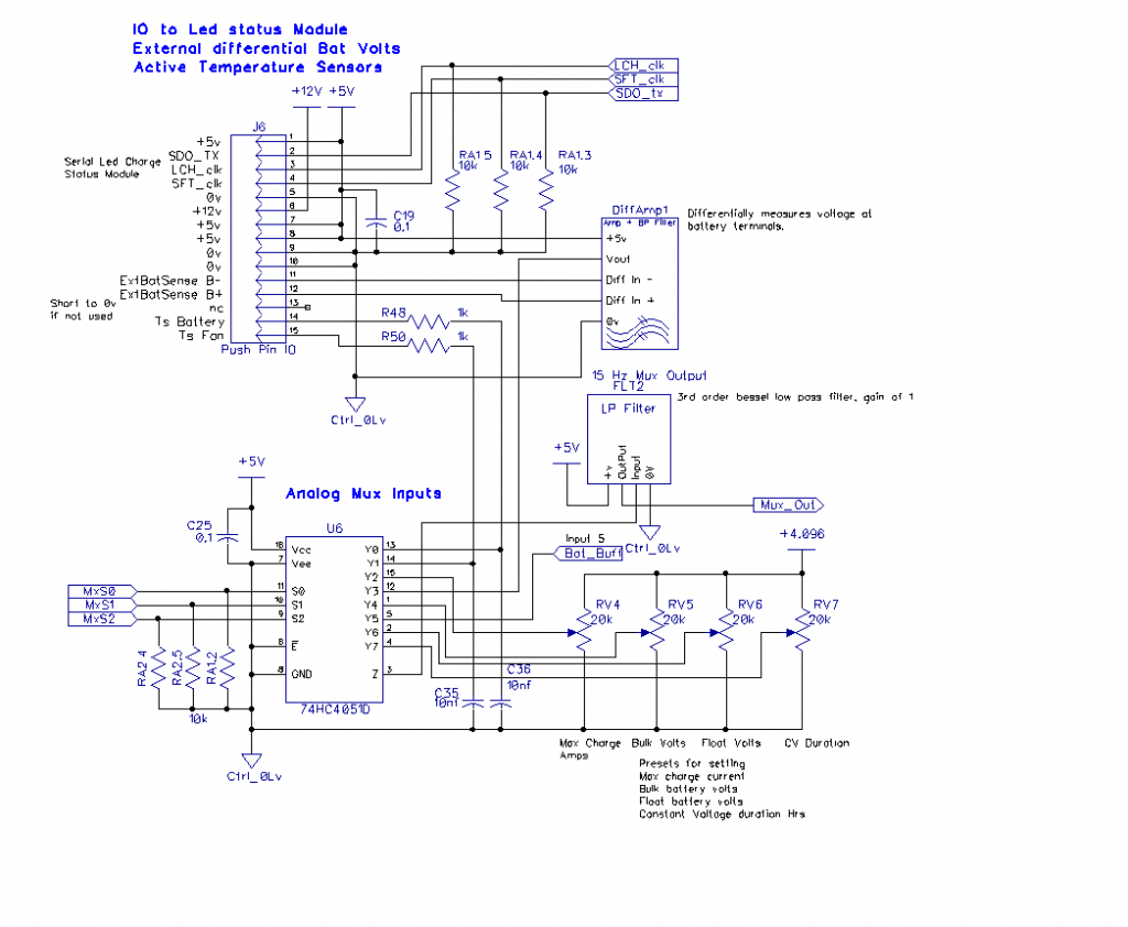

Posted: 03:46am 07 May 2022

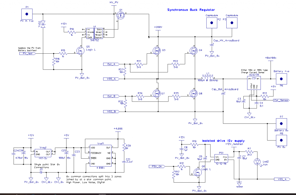

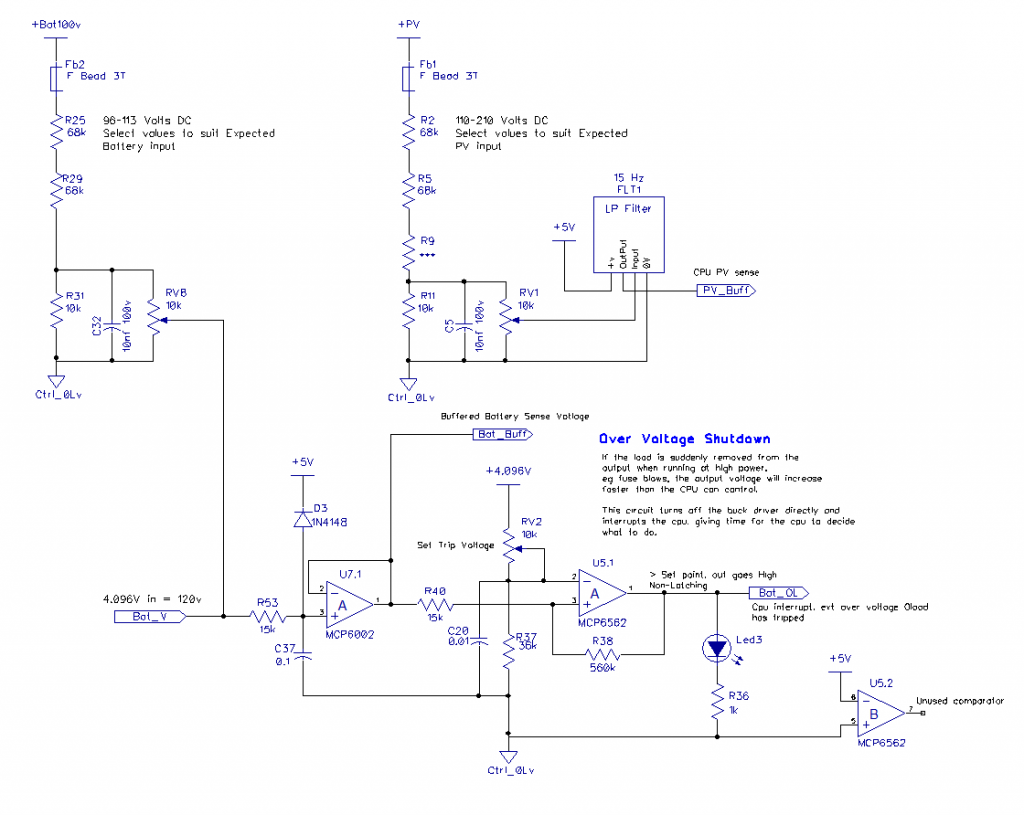

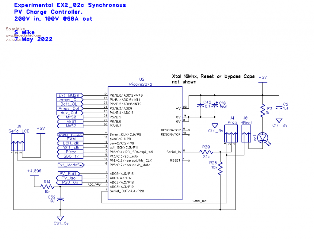

Finally have drawn up the schematic, cannot see any errors on the pcb, so that's a good start, sent remaining gerbers off this morning, now only a small alarm interface board to do for another project; this will give me plenty of stuff to work on over the winter months.
CPU:
Have used the Picaxe 28X2 here, was going to use the PICO RP2040, but the pcb would have been larger, few components like the cpu 16mHZ crystal and reset bits not shown.
Synchronous Buck and Power Supplies:
Small mosfets are logic level types, the 5 power mosfets are determined by the expected voltages and charge current, I aim for something with 2 - 12 mR on resistance and 50V higher than the max PV voltage.
The Big input/Output electrolytics are housed on the piggy back Caps pcb, this gives me a lot more space to lay out the driver circuits.

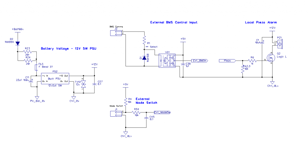

The 4.096 voltage reference is a MCP1501-40, this powers the settings pots and the CPU ADC reference input, common 0v rails on the pcb are split into 3 regions ending at a common star point to keep noise levels to a minimum.
Various Inputs:
V01 a TLP2361 logic opto is used for connection to the external BMS, the BMS will tell all controllers on the battery bank to switch to float once batteries are balanced.
Battery and PV Sense:
PV voltage is monitored by CPU directly, plugin 15Hz Lowpass noise filter module cleans up input.
Battery voltage is buffered and connected to the analog mux and an over voltage shut down circuit, the shut down trip voltage is set a volt higher than max expected output.
If an output fuse blows the output voltage can increase very quickly, faster than the CPU is able to control things (slow interpreted basic). Buck converter circuit is automatically shut off while the cpu catches up.
Analog Mux and IO:
A 74HC4051 8:1 mux is used to allow monitoring of the battery voltage, two temperature sensors and the pots for Max charge current, Bulk Voltage, Float Voltage and CV time duration for Lifepo4 balancing, battery bank terminal voltage can also be measured with a small plugin differential input module.
The mux common output feeds via another 15Hz filter to a cpu ADC input.
IO pins on J6 also connect to a serial data input LED status display pcb for visual charge progress.

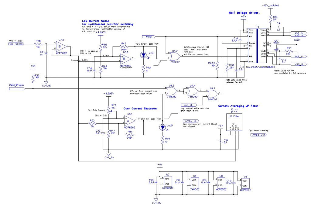

Mosfet 1/2 Bridge Driver:
Driver Ucc21521 has two inputs and incorporates a user set dead time with R28. Normally with 1/2 bridges the low side output (B) is on when the high side input (A) is off, with battery chargers a situation can arise where there is no load on a fully charged battery, and the PWM input is mostly off or very low duty cycle; under these conditions the low side device is ON and this can charge the output inductor in reverse turning the buck stage into a voltage boost circuit; no way should this be allowed to occur.
To fix this a comparator detecting the charge current fires whenever the current goes below an amp or so, turning off pwm drive to the low side (B), switching the circuit to As-synchronous operation where the mosfets drain\source diode is used.
With a fast CPU running "C" or assembly code, extra circuitry wouldn't be required, it could monitor the charge current and act quickly, but a slow old picaxe running at 64Mhz isnt fast enough.
The driver can also be turned off external to CPU by the battery over voltage signal or excess current as set by RV3, with 2 x 150A mosfets it can be set quite high above the normal CPU PWM controlled Max current.
Mike
