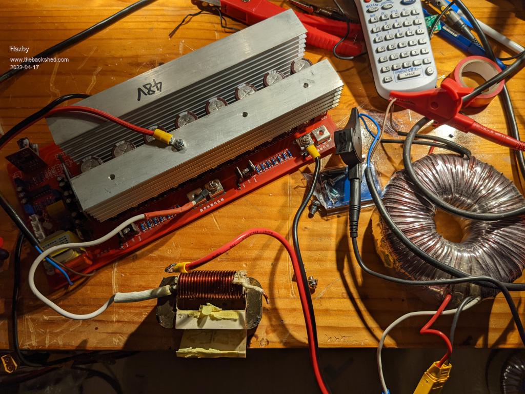

I'm building an inverter with very low self consumption for camping and RV use. This will use one of those sunyima inverter boards for SPWM.
The batteries will be reclaimed laptop 18650 lithium ion in a 10 parallel, 14 series arrangement. So approx 42v when discharged and 56v when charged.
So at 42v, the primary winding of the transformer should be 30v=42/?2
Now it just so happens that I have a 43v transformer on hand. So I'll have to either unwind some of the primary to get to 30v OR add to the 240v side.
The idea of adding windings to the 240v side appeals, as the transformer will become more efficient due to lower flux density. But I think winding the windings will be tricky.
I estimate I'll need 2 turns per volt, so I'll need to add about 120 turns to the original 240v side.
Now the hole is only 30mm diameter to start with and the online calculator says I can fit 213 strands of 1.8mm wire through it. Sounds good!
But... In the real world, how would I go about trying to wind this wire through an ever decreasing hole size.
I love the hoop idea, but that in itself will be 15mm diameter as a minimum. And as I'm starting with a 30mm hole, I don't think it's the solution.... I wonder if anyone can think of an even smaller hoop material, or any other ideas.

I have tested it as pictured without modifications. At 47v supply voltage the sine wave was beautiful with the choke pictured. And self consumption was under 5W for the whole thing. The switching circuitry was responsible for most of that figure. Fantastic.
But the output voltage was 180v, which is in line with the calculations. So not just the voltage but also the total power output will be marginal.
By winding the extra turns on the secondary, I can get another 25% of power out of the transformer with NO practical extra increase in self consumption.
I appreciate that most devices will run just fine on this voltage, but it would be good to get more out of it for the cost of some elbow grease.

Ah I assumed about 2 turns per volt, so to add 60v to the secondary, I assumed I'd need 120 turns....So much for assumptions.
Well I just measured what I really need by putting 2 temporary turns around the core, energised the inverter, and unfortunately I only measured 0.5v. So I'll need 240 turns. Well this means that I'll need thinner wire for sure.
Ok a change of tack. I'll unwind 5 volts worth of primary, cop the extra self consumption on the chin, and wind as much extra secondary as I can fit. Each turn is 20cm.

my view is that reducing the primary turns will be the fastest way to get the
thing working well.
The losses have always been greatest in the primary winding DC resistance
and the secondary DC resistance with my testing on my builds.
The increased primary current will bump up the Rds(on) and FET switching losses
but these are quite small so you can let them grow a bit.
If you just took the needed turns off the primary, I expect idle power to rise
to about 7W from the 5W as it is now.
Haxby
Joined: 07/07/2008
Posts: 427
Posted: 05:42am 19 Apr 2022
Ultimately the primary winding is what sets the level of the magnetic flux in the core, and core loss is the lion's share of no-load power consumption, so yes it follows that it's the amount of turns in the primary that is most critical when concentrating on no-load power. The more the better.
So I was going to unwind the primary from 43v to around 36v, then I was going to add to the secondary windings to get to 240v.
Well I unwound the primary to 36v and tested the no-load power, and was surprised that it hadn't risen much.
So I kept going to about 33v where the power went up to 6.5W. That's ok by me.
That gives me 215v on the output which is a good compromise all round. In future I can always add more turns on the secondary if I really need a few more watts out of the inverter.
So somehow I have dodged having to wind a transformer yet again!
