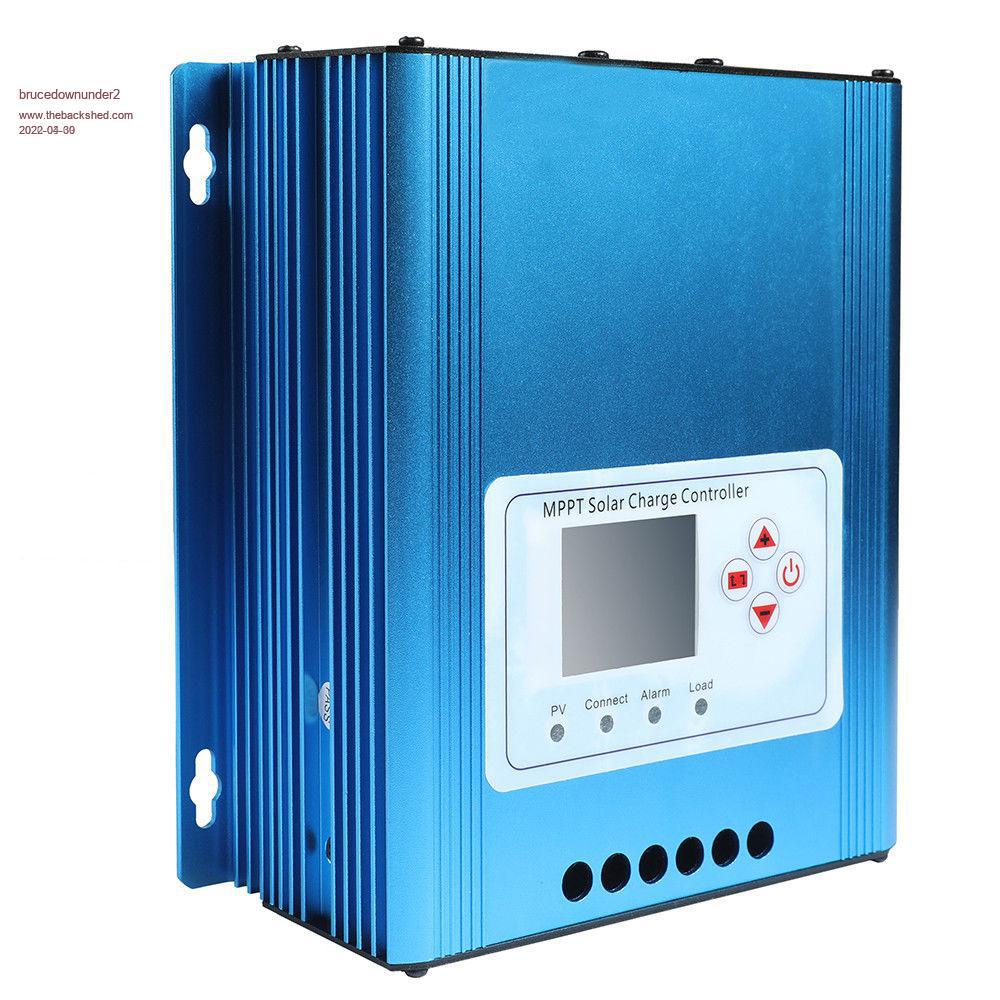

Good morning,
  I have this CPE solar controller  from new.  I need help from another owner that has one working.
 I gave up trying to get help from the distributor ,through many e-mails from the day I purchased it, but unfortunately, no real help in the operation ,the instruction s were beyond my interpretation...
 I have been trying to work out the  4  little symbols that are supposed to configure the input / output of the solar
power, but only get very low numbers.
I have a few other controllers of different brands , and all seem to work with my array of 2.5 Kw .  I am seeing 1.3+ Kw out of the  "E smart 3 " .
I would appreciate help, I'm around the Gold Coast, if anyone close by is able to assist.

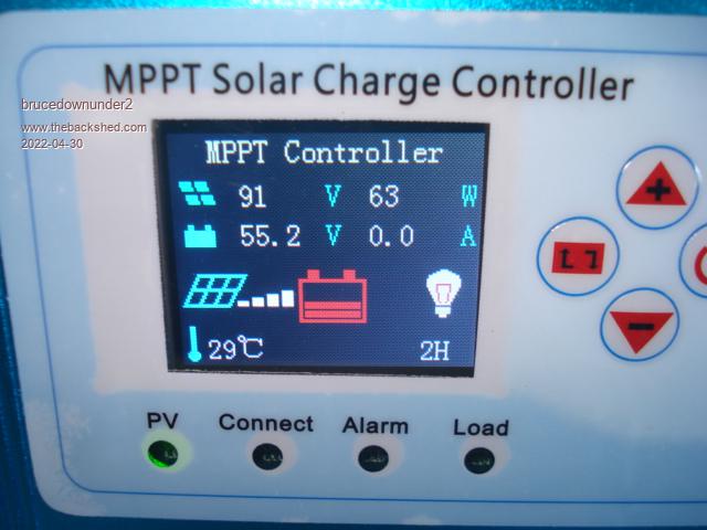

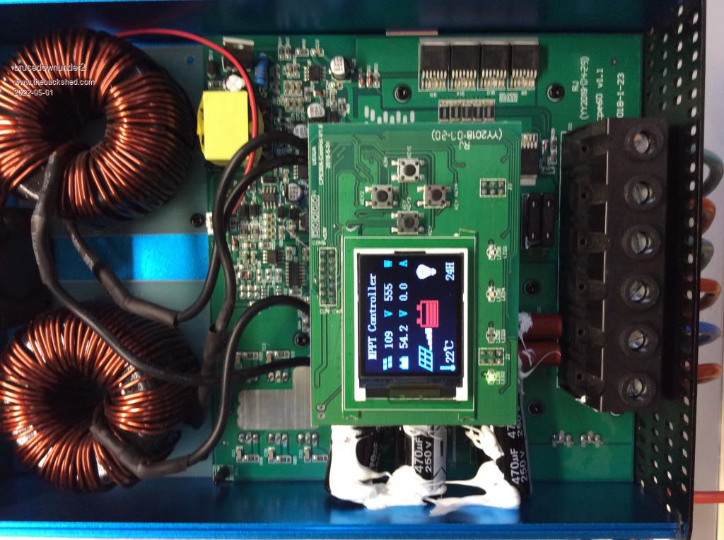

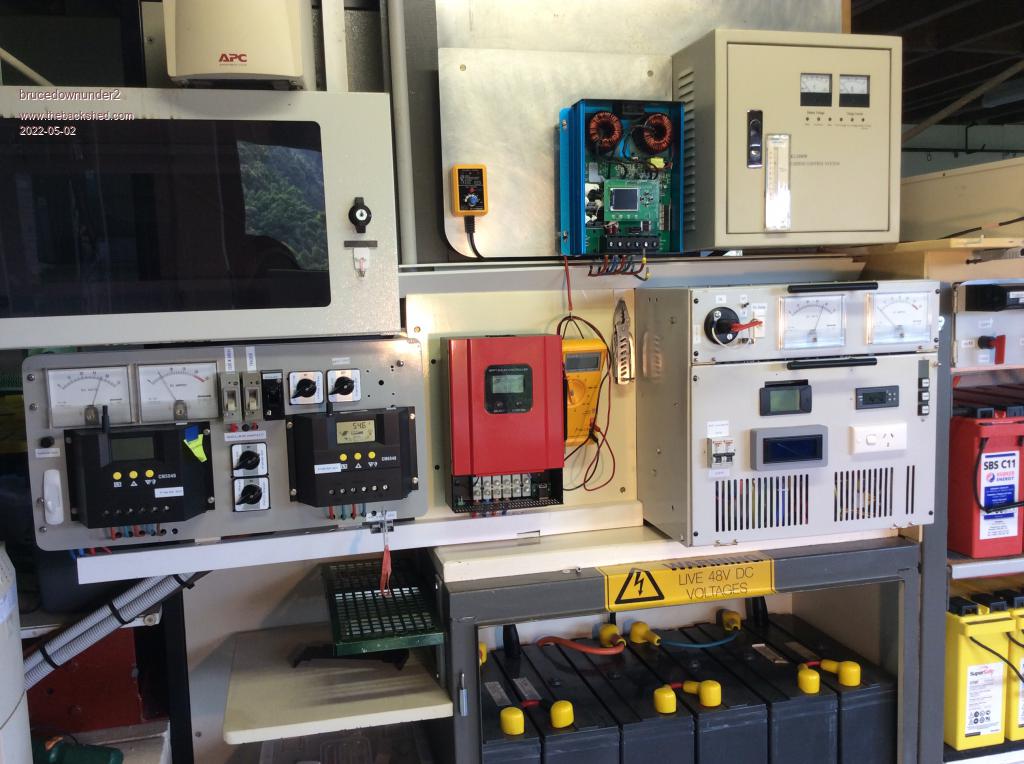

I'll attach a photo shot of the controller showing that it is seeing around 300 watts of power .
 But , it's not being directed into the battery, it shows 0 watts into the battery.

Now I see the photo of its innards, thanks will take a closer look.
Just noticed it says 555 Watts, can you check the cable between the charge controller output and the battery with a clamp meter?
The Amps out is 0 on the right hand side of the screen, I believe this will only show Amps out if the Load output connection is in use, you would have a to have A 48v light or something on the load terminal and turn it on or off via the button on the left....I think, better still check that output with a volt meter first, then try pressing the button on/off.
The load out terminals should not really be used for anything, I have been warned by a few different Sellers not to use the load out terminals, it is mentioned in the manual do not connect an inverter to this terminal.
So I think the Amp on the screen will remain at 0 and the battery can still be charging, seen as watts in....I think, but could be wrong.
Text is not all that clear, but it will do.

Hi Bruce, just below the screen and between it and the screw terminals there appear to be a couple of blade fuses.
Have you checked them?

 First Pete, yes, they were the first ,long time ago , that got checked with a multimeter, plus pulled them for inspection-all appeared OK,thank You.

Hi Bruce, it seems odd that the controller is showing watts on the screen, when nothing is going out.
Does it run hot?.
I am thinking you may be on the right track as far as mosfets go, they tend to short out a lot when they go to mosfet heaven.
So maybe a shorted mosfet would still allow it to show a power reading.
Looks like the mosfets are on the bottom of the board. But the solder connections appear to be on top, at least that is what you photo appears to show.
What sort of readings have you got from them?
Pete

There seems to be a short burst of power from the controller to the batteries when it is switched on and solar is connected, then a fault (perhaps over voltage) is triggered and then it shuts off.
I guess this indicated that it is trying to work and one set of fets are likely to be working for that to happen, the other set of fets or the driver maybe not working as they should, or the voltage sense section.

Hi Bruce, as an outsider looking in I am not convinced the unit is charging at all. Aaron suggested a clamp meter to check if any current is actually flowing - it was a very good suggestion. Did you try that and if so what did you find? It looks like either the Watt meter or amp meter or both might be lying.
I also think that the unit cannot predict the wattage that is/would be available but I am sure it can/should measure and report it whilst it is delivering that power.
My advice before going too far towards swapping FETs etc is to check the supply voltages to the electronics, especially the measuring part (may be an op-amp or active type current sensor) as the measuring part appears to tell lies.
There are 4 x surface mount T0220 packs with 7 pins and some others directly below the upper control panel and are probably part of the power path?  these are easily accessible but difficult to ascertain if 1 is faulty if paralleled and maybe there are still others mounted/hidden underneath the pcb.
The 550W but zero amps says a lot also, is it really delivering that 1.6kW? a clamp meter is the best and simplest way to confirm.

  Quote  There are 4 x surface mount T0220 packs with 7 pins and some others directly below the upper control panel and are probably part of the power path?  these are easily accessible but difficult to ascertain if 1 is faulty if paralleled and maybe there are still others mounted/hidden underneath the pcb.
They look a bit like D2PAK7 TO?263 7 LD or something, the first time I looked at this type of ic and saw one data sheet showing a mosfet in this package, it looks much the same, so pin 1 is the gate, in the photo it appears it may be connected on the other side of the board, there is some interesting mosfets in this type of package and might be an option for future builds......perhaps.
The op amp might be one of those little 8 pin ic's, I replaced a cracked one on another charge controller...
