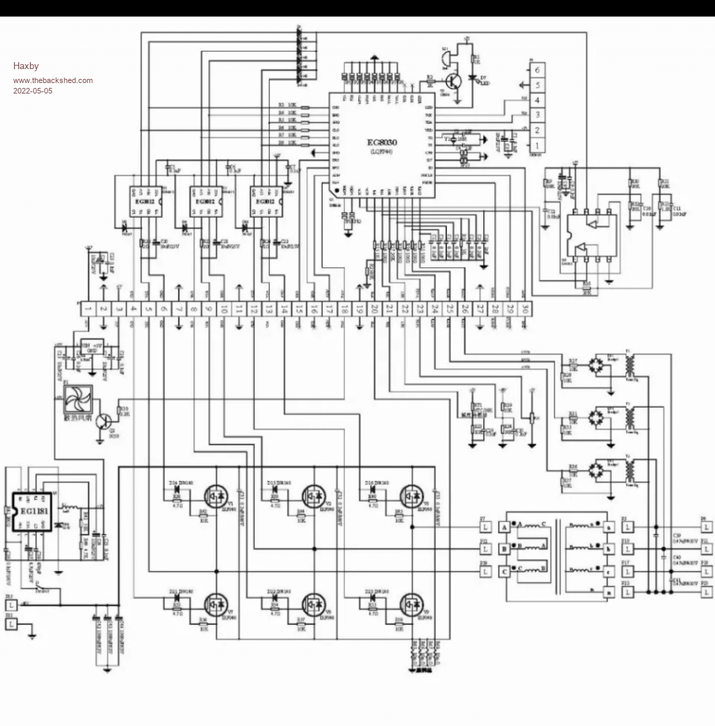

I stumbled across the EG8030 while browsing Ali express. It's the 3 phase version of the EG8010. It has 6 outputs to drive 3 half bridges, which in turn drive 3 legs of a Delta wired 3 phase transformer.
Does anyone here have one going? I'd imagine it needs 3 chokes, one on each leg. I wonder if it would have problems regulating each phase if one of the phases was loaded more than the other two.
No chokes on the output are pictured in the example diagram, but that doesn't mean much. The output caps are there. I suppose each of the phases is driven by SPWM. Anyway I bought the EGS031 board so I'll have a play with it in a month or 2.

looking at the schem, it appears there are 3 individual Vfb for each phase.
This would probably handle uneven loads, assuming well designed primary:secondary ratio
on the transformers.
I've seen it work in youtube videos.
