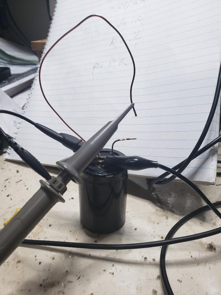

The test cap is a Aliexpress 100V 10,000uF cheapie, costs about $6 each or a bit more now.
These caps are not robust, I blew one up when I fed it 95V for a day.
Maybe they are relabeled 60V caps or something.

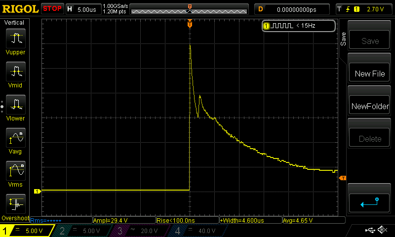

So I soldered a 1mm diameter copper wire, 5 inch long onto a cap terminal.
I measure the resistance and get 19mV drop at 5 Amps
This will be the current sense.
I charge the cap to 50V and then short it, capturing the voltage across the
copper wire.
the event:
The peak is 30V
I did not believe that so I did it again, checking the voltage divider and DSO settings. Must have made a mistake..
no mistake.
30V / 0.019 * 5 Amps = 47,000 Amps
I must smoking some really good gear tonight. 47,000 Amps?
I would like it if other people here would do the same test, to confirm
or not what I have seen.
maybe there is some other effect here adding to the voltage ac\\\\\\\\Anyway, the inverter power board has 6 of these caps installed in parallel and so
it would appear there is a very huge amount of current available on the DC supply.
Should the FETs be switched on both high and low sides then this current will be dumped through them.
No FETs can handle this sort of current.
On occasions I have tested a board with caps installed and the FETs blow.
It comes with a quiet "tick" sound.
But with no caps installed and a current limited power supply you can
get away with murder.

poida
Joined: 02/02/2017
Posts: 1510
Posted: 12:09pm 02 Dec 2022
I was on drugs
30V / 0.019 = 1579
and then times 5 gives me
7,895 Amps
Now that is reasonable.
Only 7,900 Amps peak instead of 47,000
Where did I get that 47K from..
Solar Mike, how about you do this test? Only take about 10 minutes.
I'd love to see if this can be repeated.
This test is realistic.
HY4008 resistance when fully on is 2.9 milliOhms
the wire I used as the current sense is 0.019V when 5 Amps is passed
through it. R = V/I so resistance of the wire = 3.8 milliOhms

mab1
Joined: 10/02/2015
Posts: 290
Posted: 05:00pm 02 Dec 2022
Does the copper get warm? Copper isn't used for current shunts as it does have quite a significant temp coef - might be exaggerating your results?
Posts: 6636
Posted: 08:17pm 02 Dec 2022
You have the inductance of the loop made with your copper wire.
You probably also have to consider "skin effect". That is something we worry about with AC, especially high frequencies.
Both of these may increase the impedance of the circuit but I can't guess by how much.
You might have ended up with a resonance (L and C in series) to make life even more interesting.
Edited 2022-12-03 06:20 by TassyJim
Posts: 3428
Posted: 09:33pm 02 Dec 2022
Yes, large current transients can be quite complicated. Long, long ago while studying HV Transmission and System Protection we were told to ensure the voltage rating of everything was overrated by 3 times. A short circuit would create voltage transients of up to double the normal peak voltage elsewhere on the transmission line. The ends of the line were especially vulnerable.
If I recall correctly fully describing a short circuit event took a couple of pages of calculations.
Edited 2022-12-03 10:11 by phil99
Murphy's friend
Joined: 04/10/2019
Posts: 678
Posted: 08:36am 03 Dec 2022
Those 3.8milli Ohms were at 5A, the wire was cold then.
That resistance instantly got much much higher with the short circuit current. I very much doubt that your quoted peak short circuit actually flowed through that wire.
Had it, that 1mm wire would vaporize instantly, you did not mention yours did so.
You might repeat this experiment with a disposable mosfet doing the switching, eliminating possible doubtful contact of touching wires.
Perhaps you could take bets which blows first, the wire or the (100A rated?) mosfet

I agree that the skin effect likely makes for the huge voltage across
the wire. The very fast change in voltage over time means
a lot of high frequency power, and high freq flows mainly on the
outside of the wire more and more as the freq rises.
I measured the wire using DC so it used the full area of the wire
in the resistance. Litz wire will give different results.

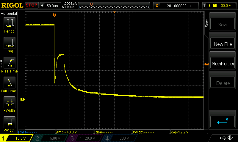

Today I had another go.
This time, a poor old HY4008, with the Gate driven by 12V, switched on
via a push button. A 1K resistor is used to pull it down to ground to ensure it's
only on when I press the button.
50V on the cap and I press the button..
volts across the Source and Drain:
And there were no flames. I am disappointed
But the FET did get destroyed and finished up a dead short
Is it worth it doing it again at 1/2 energy and 1/4
to see what it can survive?

Murphy's friend
Joined: 04/10/2019
Posts: 678
Posted: 08:04am 05 Dec 2022

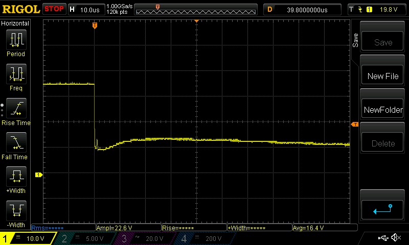

That graph has me curious, why the voltage re bounce?
I would have thought a short MosFet has zero volts across source/ drain.

Posted: 09:23am 05 Dec 2022
I think it can deal with the current for a little while, then it goes a bit linear
and then some cells overheat/blow up/go short and then it completes the destruction.

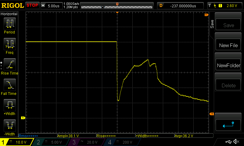

I tried it at 25V, which is 1/4 energy and it survived two conduction events
1/2 the energy is 35.4 V and now I try that..
a different timebase this time.
the HY4008 survived 3 dumps of 35.4V of the 10,000uF cap
the current should follow an exponential decay curve and it seems to
after the first part of the switch ON period.
I now give it 50V and it can not deal with it and goes short circuit.
again the bounce

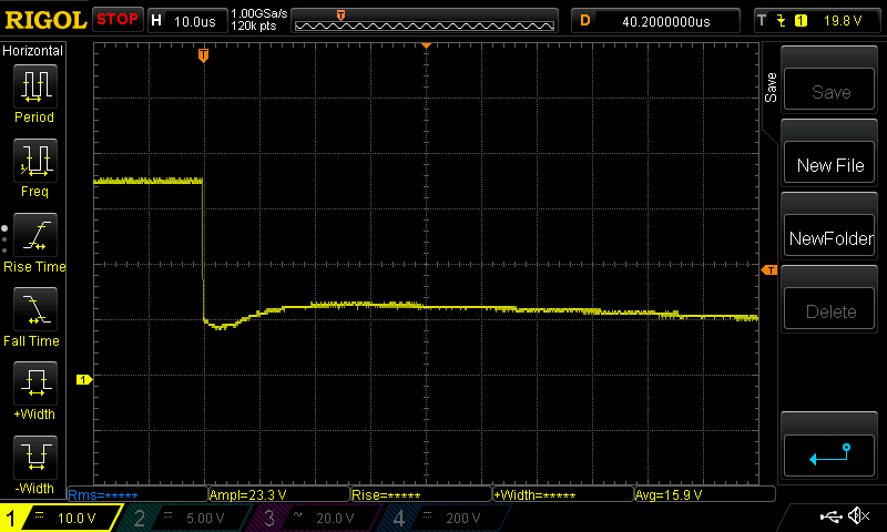

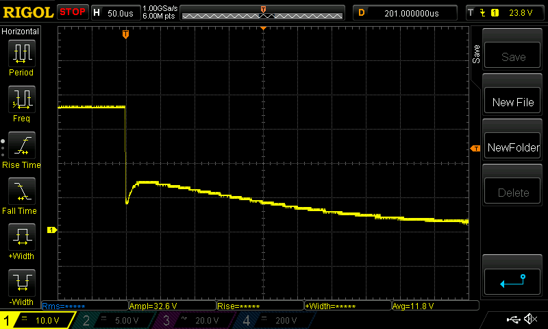

Posted: 08:21am 06 Dec 2022
just got home and had a beer.

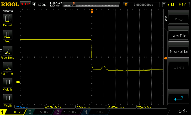

This FET is different. I am using those which seem to "test OK" after an
inverter blowup. So there is none of this pronounced hump.
35.4V, 12V gate voltage and no cap to boost the Gate drive
This the the test conditions of the above examples as well.
at 1us/div we can see the little bump which seems to always be there

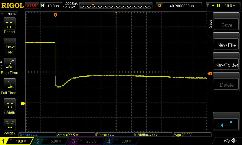

now I give it 22V on the gate, 35.4V on the big cap
and then I go to 40.5V on the big cap and it blows.
Not very interesting voltage capture this but it blew just the same.

wiseguy
Joined: 21/06/2018
Posts: 1336
Posted: 06:20am 07 Dec 2022
Thanks for the update Peter. The graphs don't show the same peak after the falling edge for the last FET tests compared to the previous 2.  Not sure why the peak was there but I guess also no surprise that the 20V gate voltage didnt make any difference to the peak which had vanished lol. So my theory remains just that, the latest test certainly didn't support it at all.
In my capacitor experience which is mainly around Nichicon, United Chemi-con, Siemens and Panasonic, I am sure that I have killed very robust FETs with a lot less than 10,000uF so I am wondering about the internal impedance of the 10,000 CAPs. I have little faith in any Ali supplied capacitors and a whole lot less with their semiconductors which are often outright clever inferior forgeries masquerading as genuine parts.
