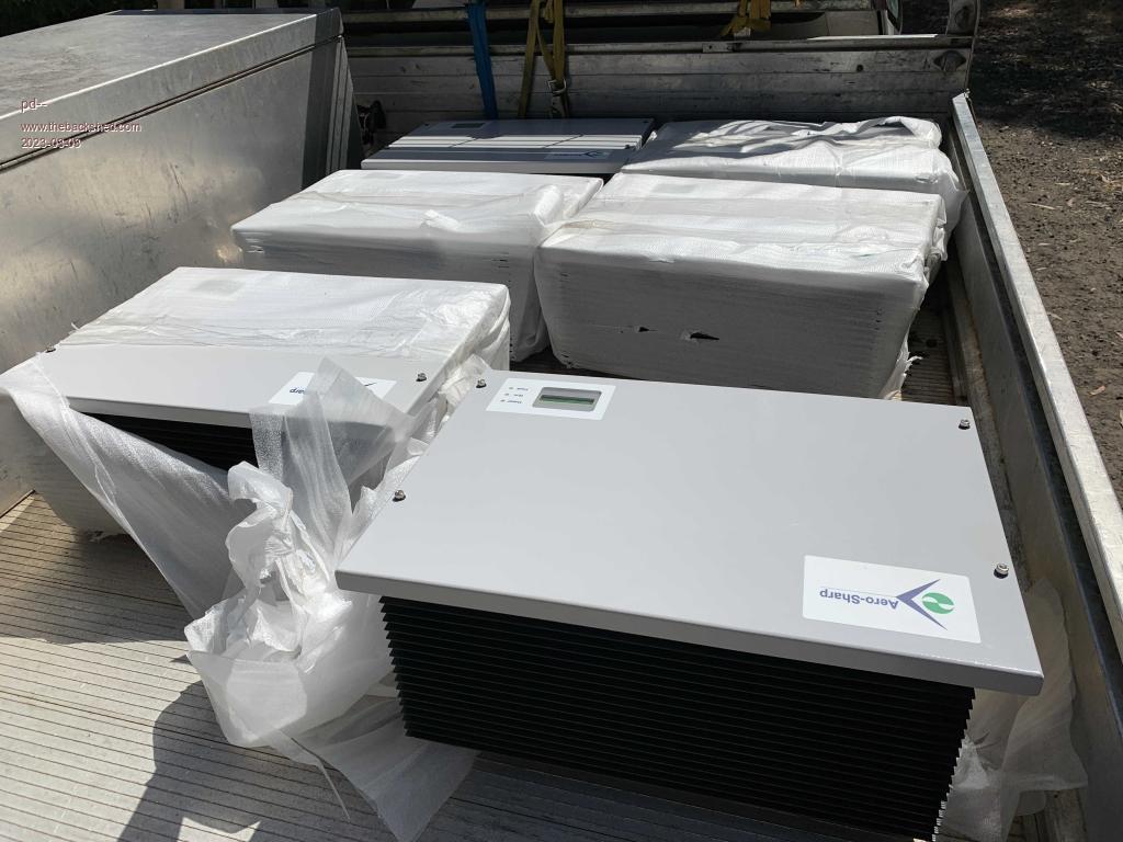

Six brand new Aerosharps
ill PM my details

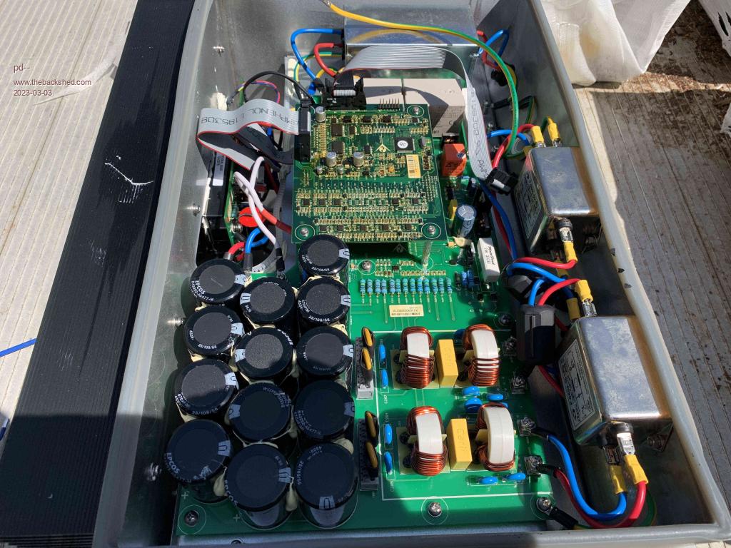

pd, you know you were wondering how to get the current sensors?
Each board in those Aerosharps has 3 good sensors.
Sometimes genuine LEM, sometimes alternatives with same pinouts.
The pinouts also will match with the mppt board if they are 3 pin type.
(please check this before you solder them in place,
I could be wrong, and on about 1,000 times in the past
I was wrong)
4 pin type LEM sensors will need a bit of fiddling with.
But 3 x $25 LEM sensors per board is worth the time to desolder.
pd--
Joined: 11/12/2020
Posts: 122
Posted: 08:31am 03 Mar 2023
Definitely, thanks for that
They are the 4 pin type lem casr 15 np
i have the data sheets so wont be hard to figure out
and 13 $20 capacitors.
its amazing how things just popup when you need them.
just need to figure out the choke
