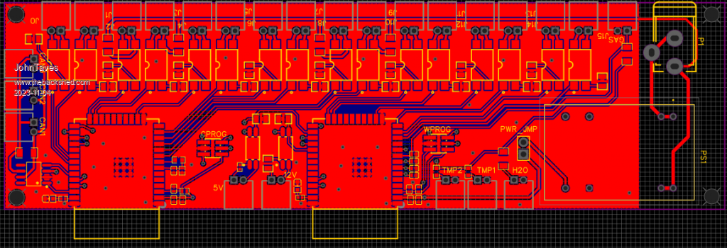

I find that the BMS and charge controller offerings are just wrong for lithium packs, so I made my own. If anyone is interested in this speak up.
Background:
It makes no sense to have the solar charge controller, or inverter/charger, using pack voltage to decide when to charge or not charge. When any one cell reaches the top or bottom cut-off V, charging or loads should be stopped. In other words, the BMS should be the brains of any lithium based system.
The off-the-shelf BMS offerings combine the disconnect circuit and the brains into one package. This is stupid. The brains are independent of the amps and voltage (number of cells in series). A pack disconnect SSR should be sold separately depending on amps and voltage your application requires. It should take a simple 2 wire on/off open/closed connection from the brains. In other words, sell one product the BMS-brains, and sell a line of simple disconnects for different amps/volts. (I do not have a pack disconnect.)
The charge controller doesn't need any brains. It should either deliver the current or stop depending on the signal from the brains. Many applications can buy panels that match the max power point to the pack voltage so that all you need is a simple SSR+diode to connect the panels to the battery.
In addition I got frustrated with the rats nest of wires from the cells to the BMS.
Solution:

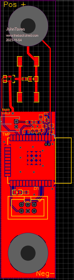

I made two esp32 based boards. One, the cell module, measures the pack voltage and temperature, and sends the info via bluetooth to the controller board. The controller board has a pile of SSRs to control things, a CAN connector, and bluetooth and wifi.
The cell module, has the form factor where you simply bolt it to the terminals on a prismatic cell that you buy from alibaba. The temp sensor does require you to wire a thermister and tape it to the cell. This board has 2 20ohm resistors in parallel that the software will turn on, potentially for hours, to give that cell a haircut if it is the first cell to reach the top V. The software can ensure that no one cell is always the one to reach the top V. These report their measurements every 2 seconds, and are asleep between measurements. After I implemented the sleep feature, I was unable to measure the amps. Prior to that it matched the expected ESP32 drain of a few tens of milliamps. Nobody will get excited about the ability of the esp32's A2Ds, but I find them totally acceptable for measuring cell voltage. They seem good to about +-.01V. I figure that I have no need to run these cells up to 3.65V which is supposedly the max. I stop at 3.5V so it makes no difference if the cell was really 3.52 or 3.48.
The controller board has 2 esp32s. I got tired of trying to get a single esp32 to do both the wifi and bluetooth. There are 16 total SSR outputs that are used to turn on/off loads and charging. There is a CAN bus that I use to capture the data from 2 Reidon SSD digital shunts. One shunt measures the pack voltage and amps, and another measures the solar amps.

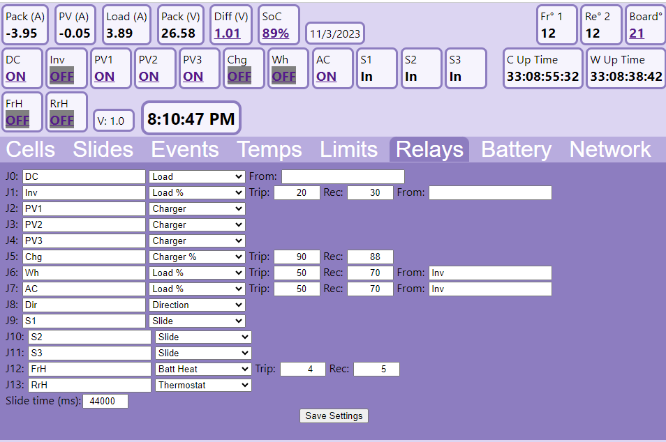

It has input for 4 different resistance measurements. Two are used for the temperature in the front and rear of the RV and control the 2 furnaces, one of which will heat the water bay where the batteries are to ensure neither freezes. Another reads the water level resistor in the fresh water tank, and another reads the propane gas level resistor.

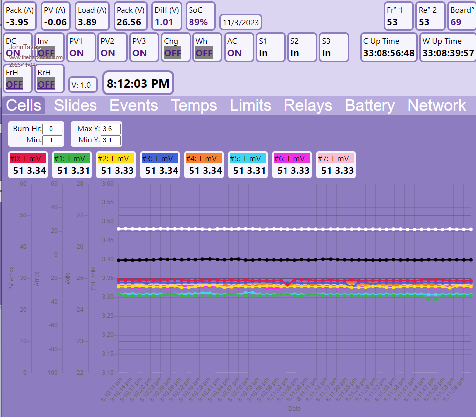

The software provides a web page where you set the # of cells and the various cut-offs and recovery values. The temperatures and gas and water levels are shown on the web page (the screen shots are from an earlier version, so no water or gas level).
The software does coulomb counting to monitor pack state of charge. I have it set to stop charging at 95% and turn charging on after it drops below 90%. This means that the pack is almost never at 100%. I have my settings such that 100% is when any one cell has hit 3.5V and the pack amperage is less than 12 (I have an 2p8s 280ah so 13kwh total).
It will turn off the main cabin air conditioning if the pack state of charge goes below a certain %, and same with the electric water heater, which reverts to gas.
When any one cell drops below the minimum voltage, the DC/DC converter is shut off along with the inverter resulting in only the current necessary to power these boards.
Because the coulomb counting will accumulate error, I occasionally run the pack to 100%. The software has not been fully implemented where it will monitor what cell hits the top and then turn on that cell's drain resistor to give that cell a haircut to ensure that it will not be the one to hit the top next time. I just do this manually. Whenever I hit the goto-100% button, I check afterwards to see what cell was the top dog, and turn on its resistor for several hours.

Sure, each component should have its own protection. So, an inverter would shut off when it detects over current or over voltage that would wreck itself. But it does not need to have settings that will attempt to protect the battery. That is just a waste of circuits and complexity as you identified. More importantly, it should not be able to deliver charge, or be a load, without a closed circuit from a device that has cell information.
With respect to the battery, separating the brains (CPU, cell monitoring, and UI) from the simple circuit that will disconnect the battery, changes nothing with respect to "last line of defense" for the battery. It simply reduces the number of product offerings from NxM to N+M.
Simplicity is safer than complexity, but combining the brains with that pack cut-off device is not simpler. The exact same set of circuits exists in both the combined and the separate situation.
Hiding the cell voltage information inside this "last line of defense" is a waste. It forces additional complexity.
I have no problem with a battery that comes with its own BMS (e.g. battleborn). But attaching other charge/load components that know nothing about the cell voltages and that do not depend upon a trivial open/close circuit to turn on, is not more safe for the battery. For example, a Victron MPPT is a complex device that does not have cell information and yet it can deliver a charge. It can do that without receiving any positive signal from a device that does have cell information. It is poor reasoning to conclude that, because the Victron will stop when it detects pack voltage is too high, it is therefore another line of defense. It should be viewed as additional complexity that has the potential to F'up and deliver too much power. I am not saying that I or you should not trust a Victron combined with a battleborn. I am saying that it is a bogus argument to say that it is more safe for the batteries than a simpler system where the charge controller can only deliver power if a simple circuit is closed.

I saw you post on Murphy s friend active balancer, I could not really place it in perspective. So I wondered a few days if I should start a discussion or not because he didn't really want to.
So feel free to ignore my probably long post, but I think we are all here to show our projects and to learn from another. I myself will always be open for feedback if we do it with respect.
I know you made your system with a certain reason and I think we are more or less on the same page, it starts on cell level monitored by a master brain. Let this unit play with the slaves. The hardware that's were we differ.
Murphy showed us his active balancer, in my view a part of the BMS, like you have your bleeding off resistors (passive balancer). I don't know his system and never asked but if I look at his pictures I clearly see wires coming from each individual cell (not used for his balancer), if Warpspeed designed his balancer, he probably would have gave him also advice for his master, or BMS. With the things I already saw from Murphy I would expect a nice no nonsense bms behind the wheel.
As far as complicated, well a few years ago I made something much more complicated, but the system behind it is actually quite simple and similar. I made a working proof of concept with individual pcb's per cell (somewhere to be find on this forum), each having a push pull circuit with transformer, the energy was exchanged with a central "hf AC bus". I have packs with different capacity cells (age) that I still wanted to use.
Was it useful? I learned a lot that's for sure, I think it was fun thinking about a solution for a certain problem. Probably more expensive then adding new cells for compensating the unusable energy in the strong cells.
It's all about perspective and background, you didn't want to use 17 sensing wires, well you use at least 16 ESP's. And honestly I'm a bit jealous on the programming skills you must have to pull this off.
For me this would be really challenging and probably to much to ask, I could even say overly complicated (for me) only to avoid those 17 wires. So I used only 1 µC with 1 ADC and 16 dual opto mosfets to create my bms (also somewhere on this forum), I don't mind the 17 wires, they could be placed very neat in my opinion. I know my system is very reliable because of the limited number of components used, there is only 1 ADC, so if it's not accurate, each cell is measured with the same accuracy. If their would be a problem it will be easy to solve. Those were my main constraints, I will probably make a new version in the future but based on the same principle, pimped with an esp. But I'm sure we both had fun and learned a lot doing it our way.
Why an active balancer? Murphy stated he's using a very old out of balance battery pack, a big deviation in cell capacity. With an active balancer you can use all the energy in the pack, IF the balancer is strong enough during a big load. It might even bring the cell capacity closer to each other because the strong cells are more heavily loaded (not proven but who knows).
You think their is no use of constantly have an active balancer, passive or active? I would not use an active balancer with new cells, it adds to much points of failure, the chinese ali express versions I've tested so far are not even that accurate and I would not recommend to use. But I use an active balancer for already 4 years now with 12V LA batteries in a pack that I could recommend, they keep the pack well balanced.
You probably have a new battery and cell capacity deviation is no issue, but I think your system can benefit if you could start balancing once a certain difference occurs between cells. And not wait until a cell hits 3.5V to start balancing, you can probably save a lot of equalizing time starting the balancing sooner. Eventually when the battery pack gets older this could be important. You also see this implemented in RC lipo chargers, balancing starts immediately if a certain threshold is met. I know all cells have a slightly different voltage curve so there is no point in doing that with 1mV. Your ADC's are probably not accurate enough? But wasn't that problem with the esp32 with very low and high voltages on the adc and in the middle it was pretty linear, so actually not a problem? I suppose you use a voltage divider?
I Agree. I also think that it is cool that it is scalable to any pack. The esp32 library I use for the bluetooth only handles 8 devices, which is fine for my 24V pack. However, I kicked out another design of the main board that has just 1 esp32, but allows you to stack them. This means you can make a 48V system by stacking 3 controllers. 1 will do the wifi, providing the UI. The other 2 will gather the cell info. Each controller is identical, so you end up getting more relays and more voltage sensor with each board.
I agree this is not superior to 17 wires, or rather it is superior in the one-design-scalable sense which may not have any value. I had the notion that I would put this up as a DIY open source thing, like the Stuart Pittaway DIY BMS, but never got off my butt to actually do it.
  nickskethisniks said
You probably have a new battery and cell capacity deviation is no issue, but I think your system can benefit if you could start balancing once a certain difference occurs between cells. And not wait until a cell hits 3.5V to start balancing.
It will run the resistor for as many hours as you want, regardless of cell voltage. The first cell to hit 3.5V tells me what cell to give a hair cut to.
The idea is that I don't want the same cell hitting the max every time. That is more important than attempting to squeak out the maximum capacity. I have never run my pack to the bottom. I have no idea what cell capacity deviation I have. I suspect my use case is pretty common. If the battery is getting low, I use gas heat and limit the high energy devices, or I find a way to plug in. If the mix of battery capacity, solar array size, and weather means I am spending too much time running gas, the solution is to add more PV panels and Li cells. It does not make much sense to attempt to recover some capacity, that may or may not exist, from the pack.
