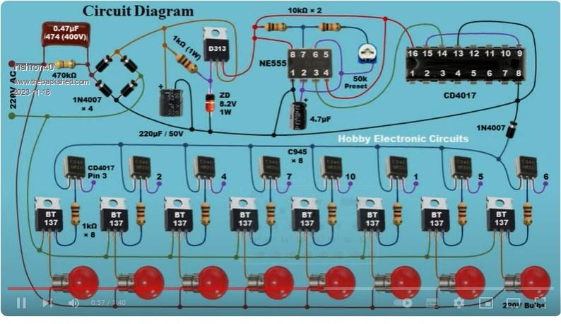

hi , I build this circuit and its working fine,
I did not have a 50v 220 uf cap so I put in a 16v  470uf.
even though it is working good could that give me any problems over time?
I also  wanted to connect some led,s for monitoring .
I did connect some led,s with a transistor  to pin,s  3,2,4,7,10,1,5,6 and to neg.
but having no joy,
I was full sure that should have worked
just wonder would the output pins supply enough current to switch the c945 and an led at the same time
any help appreciated
