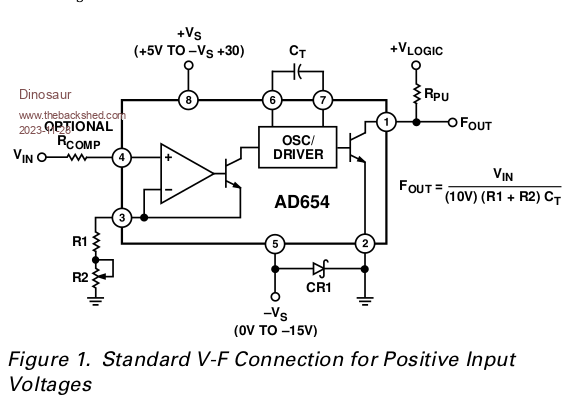

Hi All
Doesn't seem to matter how I convert the formula in the image, I can't come up with
reasonable resistor sizes.
Allegedly a 0.01uF cap should give 10Khz output with 1mA current.
I assume that is 1mA through R1 & R2.
The Input Voltage is limited to 1.000 V for good linearity.
Again I assumed 1k ohm.
Would love someone to correct me or show me how to calculate the total R with 1V input.

Transposing the equation gives:-
(R1+R2) = Vin / (Fout x Ct x 10)
If Vin = 1, Fout = 10000 and Ct = 10^-8 then (R1+R2) = 1000 ohms.
Same as the datasheet says.
Ignoring all that the op-amp negative feedback ensures the voltage across (R1+R2) is the same as Vin.
R = V / I
1k = 1V / 1mA

Hi All
Thanks for that Phil.
My error was using uF 0.01 instead of F 0.000 000 010
