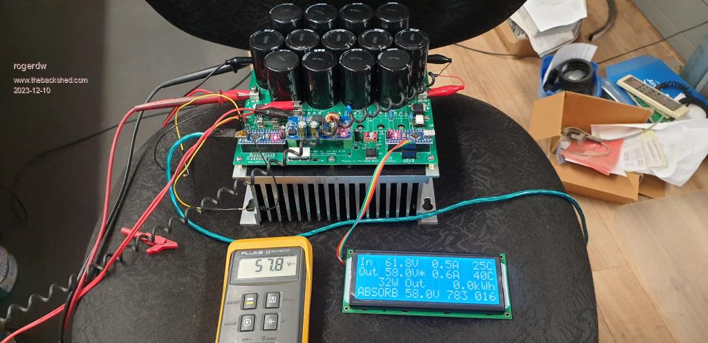

rogerdw
Joined: 22/10/2019
Posts: 957
Posted: 01:23am 10 Dec 2023
  nickskethisniks said
I don't know what your expectations are, or what you mean with low voltage, but you are right Warpspeed's PCB isn't designed for the currents the backshed controller can do.
Thanks Nick. I think if I was only building a small system I would definitely consider Warpspeed's design  ...  but I have 12kw of panels all in strings of three. That would mean I'd need 16 controllers.
As it is I am building four MPPTs and have them nearly finished. Still need to sort out the chokes and a cabinet for them all.
I'm no expert on Arduinos but have just finished taking my son and grandson to an 8 week course on Arduinos, which I sat in on. I've managed to load the arduinos for them okay and made some adjustments to the various settings, so I'm making progress there too.
Cheers,  Roger
