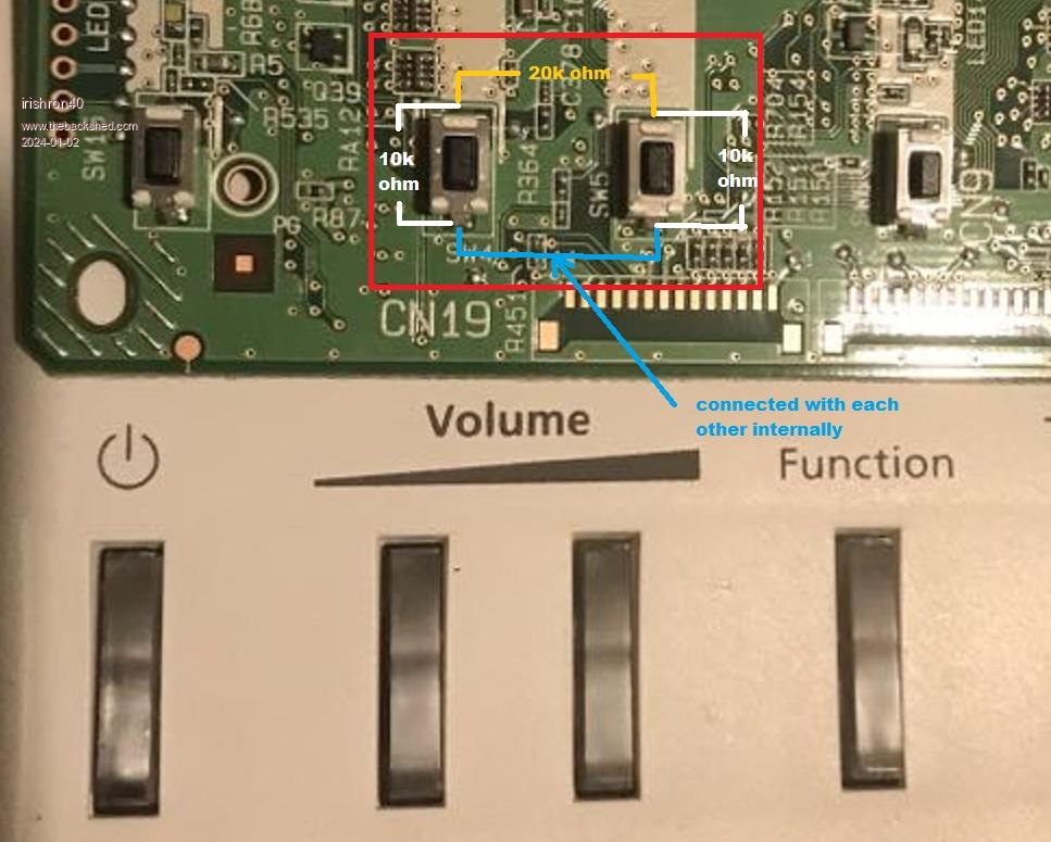

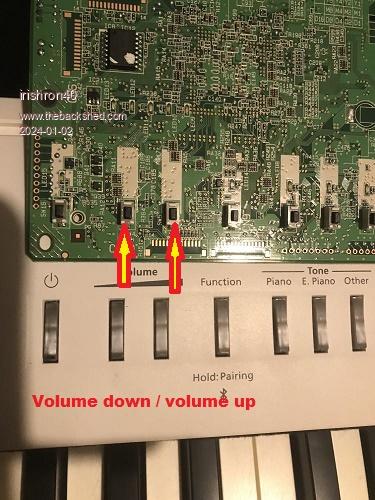

I have this piano , but the volume is controlled by 2 push buttons which is not working good as a performer,
i like to add a potentiometer to operate the volume
each push button measures 10kohm
one side of each push button is connected to the other .
when i measure the ohms between the two other pins from each push button I measure 20K

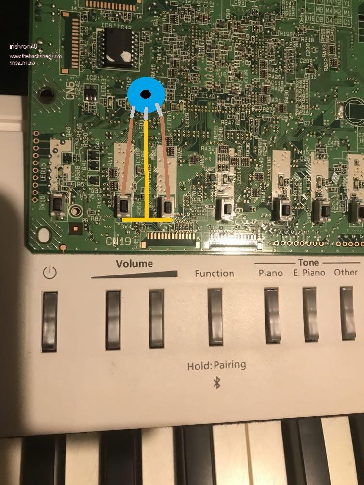

i drawn out a diagram and was hoping someone could tell me would this work before i start soldering
i would use a 20k potentio meter
god bless
ron

This looks like a digital 'Up/Down' topology.  An analogue potentiometer is unlikely to work as suggested.  More likely to cause damage.
How about locating the analogue audio output and adjusting it?
For example, the piano may have an AUX output suitable for input to an amplifier?
Best of luck.

yes Arthur ,it has two jack outputs  ,could you sugest te best way to wire the potentiometer and also what vallue?

Adding the potentiometer will not work.

There are quite a few music players and amplifiers that don't use analogue potentiometer anymore they went for Rotary Encoders, you will have to find out how it works.
Did the push button change volume by pressing several times or hold the button on for a short time?
A small amp on the aux out might be Easier solution.
several times and also when hold

Ron, before you spend a lot of time and effort trying to modify it, have you tried cleaning the switches?
There's a fair chance it's just the switches getting dodgy in their old age. I'd at least try cleaning them by dribbling a drop of CRC or some sort of contact cleaner onto the button and hope some seeps in  ...
...  then I'd sit there for a few minutes sharply pressing the button with your thumbnail or similar.
I keep new switches for most of the stuff I fix  ...  but that method buys some time for many control boards I see. If they improve even for a while it makes it worthwhile chasing up some new ones  ...  or even swapping with some lesser used ones alongside.
And I agree with the other comments, I think they are simple on/off switches that digitally alter the volume when they are pressed. You could even short the switches with a piece of wire to see if the volume goes up or down as you short them  ...  and that may also prove whether it is the switches that are faulty or the digital control they feed.

Ron,
Assuming that the output is a mono signal.  It will have a 'centre' pin, or wire, and a screen (ground).  Connect these wires to either side of a 1k log pot.  Connect the wiper and ground to the input of an external amplifier.  You should be able to vary the volume from the pot.  If this works, you might want to mount the pot in a metal box and maintain the ground screen.  All of this can be done without needing to modify the piano itself.
Hope this helps.
AD
Try searching for:  RV16AF-10-15K-A1K-3LA  on eu.mouser.com
(As with all modifications ... they are done at your own risk.)

it is a brand new piano , but am not happy with those push buttons.
I actualy checked buttons again , but volume only goes down or u when they are held in, nothing happens when tapped.
I thought it was gonna be more simple
