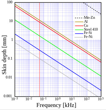

Solar Mike
Joined: 08/02/2015
Posts: 1255
Posted: 10:52pm 08 Mar 2024
Here is a graph showing the skin depth of a conductor versus frequency.
Your 24Khz equates to approx 0.4mm; If you are using an H-Bridge transformer driver with secondary rectification, most of the current in the wire is AC so skin effect will come into play. Use multiple insulated wires about the 0.8mm dia or thin copper foils for your windings. However during development stripping insulation off the ends of 100 or so copper wires is a real pain, use bigger wire and only do the thin stuff in the final build.
In charge controllers with buck converter topology, most of the inductor current is DC, with a smaller HF DC ripple component, so skin effect isn't so much of a factor, just use big fat wires.
