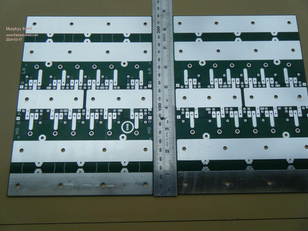

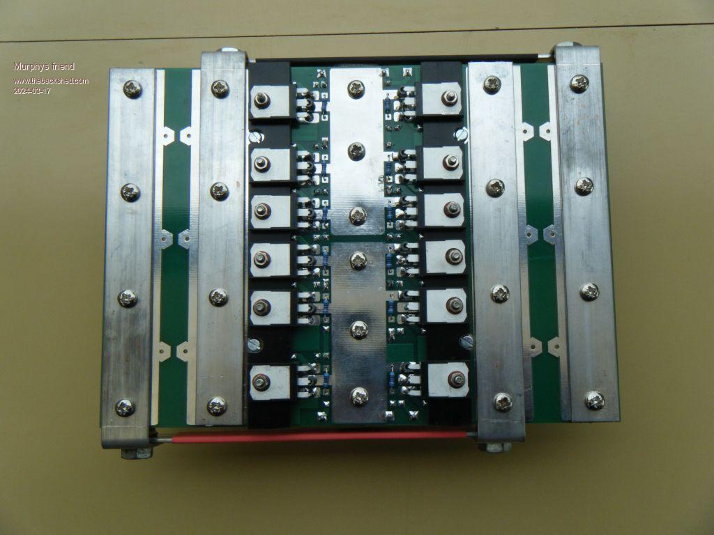

A big expense of a decent size inverter is that large 2oz copper PCB for the mosfets & capacitors.
So, if I told you that I just built a 6KW inverter using 1oz PCB board for the mosfets you possibly won't believe that.
But, with the right track layout, making the top & bottom power tracks identical, one creates 2oz copper tracks by paralleling those tracks. This has the added advantage of these tracks having now twice the surface area for even higher current capacity.

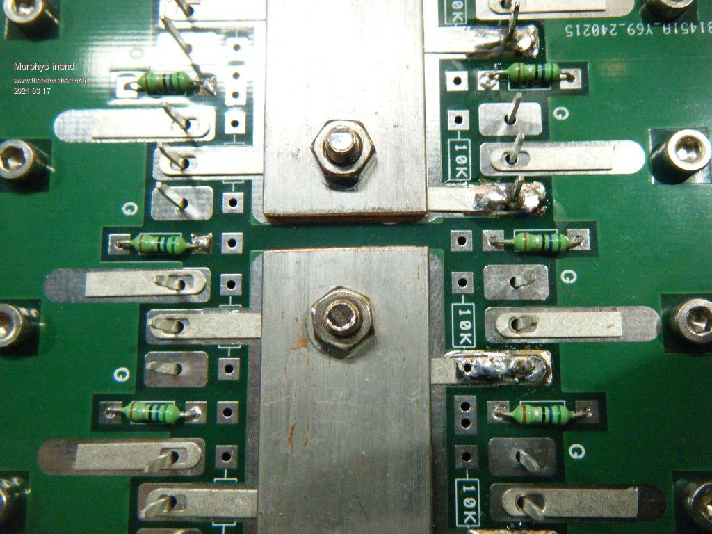

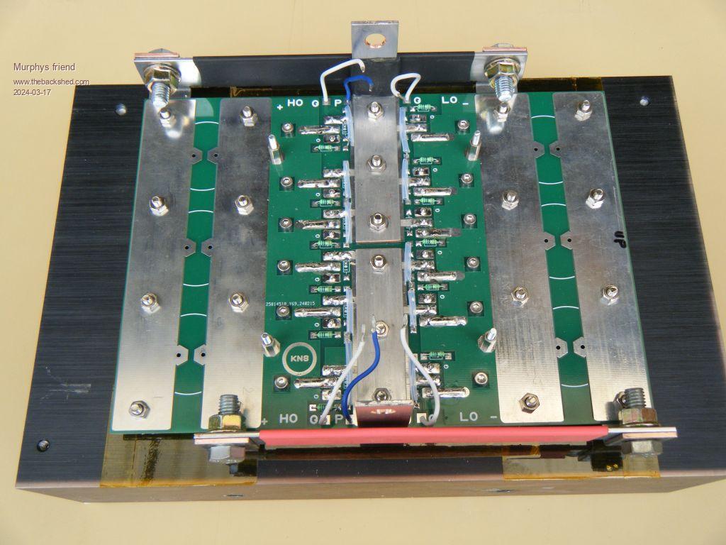

So, here is what this power PCB looks like for 12 HY5608 mosfets:
The top and bottom side are shown next to each other.
Ther is still the track bottle neck where it narrows to connect the mosfet pins to take care of.
For this I use warpspeeds trick of cutting the tail off long tail solder lugs. The next picture shows that arrangement.
Anybody considering this, make sure they are tin plated *copper* lugs (dull silvery finish) and not nickel plated brass (shiny finish) which is useless for this application.
A tip about soldering these lug tails: I have 2 sets of 60 W temperature controlled soldering irons and neither of them was up to the job with the biggest tip available. There is simply not enough heat storing capacity in those thin walled 6mm tips those irons usually come with.
I use an old fashioned non temp controlled 80W iron with a decent 10mm copper rod wedge tip. So, if it takes you longer than 2 seconds to fully flow the solder around the mosfet pins & solder lug, a more suitable soldering iron is recommended.

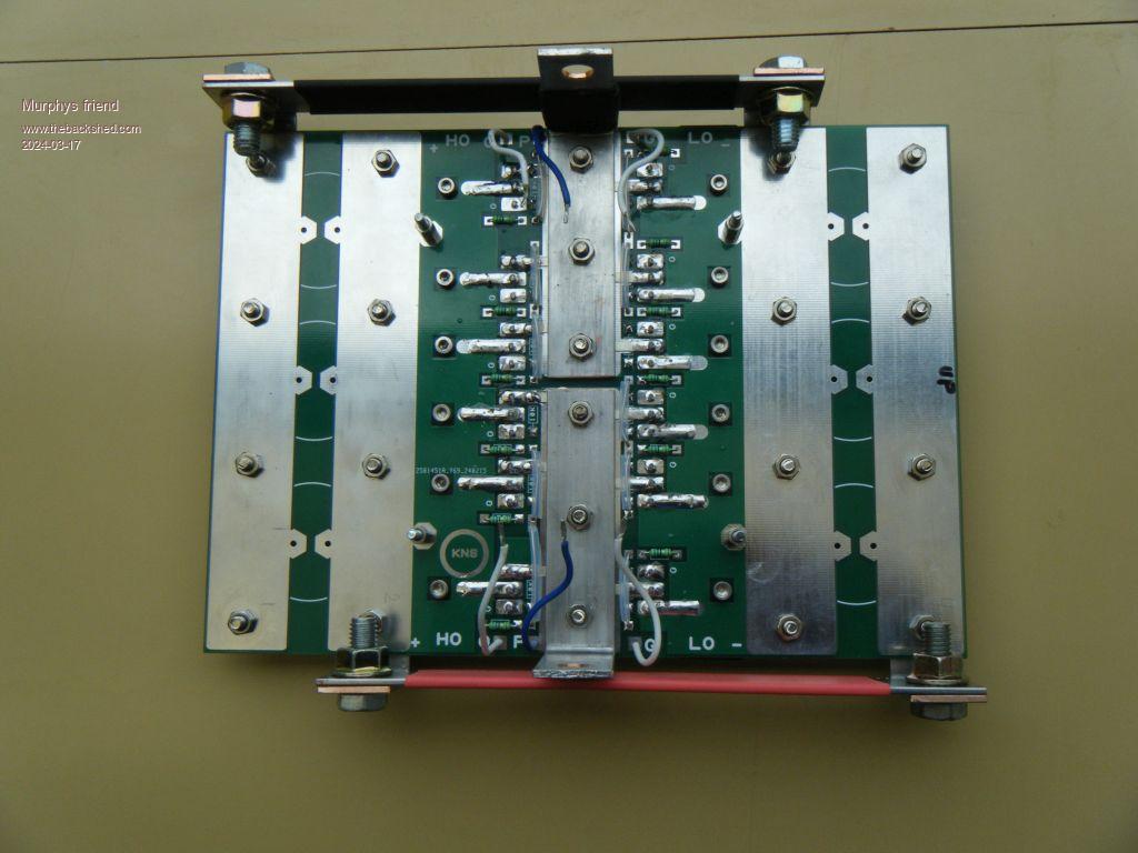

The next picture shows my power connections to the PCB tracks. I am not a fan of those dainty 6 legged, solder on PCB, screw connectors. They make it too difficult to route 32mm sq power cable & lugs to, this is much easier off the board where I can use 8mm bolts to make that connection.
Another thing you'll notice is the complete absence of the driver components, I find they clutter up space there and make the board bigger than it needs to be. It's, IMO, much easier to use a piggy back PCB for that which can have equally short gate tracks.
The only small parts on that power PCB are the gate & source/gate resistors.
The following is a picture of the bottom side of the assembled power board. Note, there are no fancy mosfet leg gymnastics required to accommodate the ferrite beads. Just bend the legs at a right angle where their size reduces.

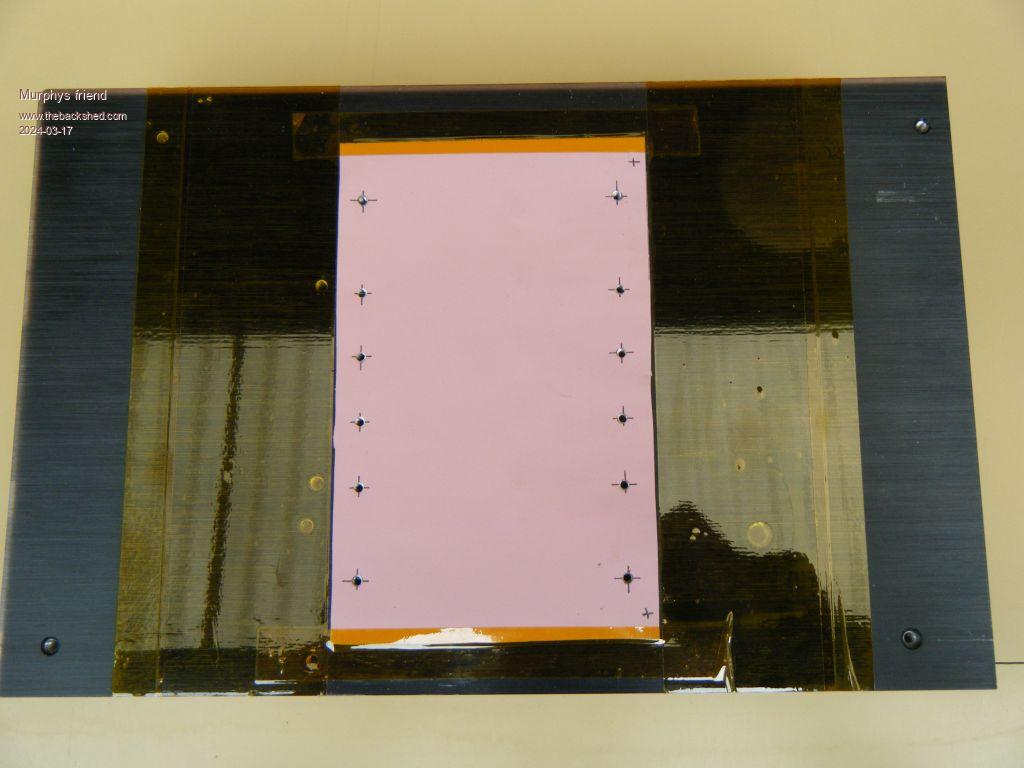

You may not see it clearly (its black) but I placed the mosfets on a 3mm thick fibreglass board spacer strip, between the mosfet top and PCB, to increase the gap between the heatsink & board to 6 mm. This also gives me clearance for the copper busbars (20x2mm) plus better air circulation under that board.
I designed that board for an Aerosharp heat sink but then realised I had an equally suitable heatsink from an old GTI which had a thick side fin, making it very easy to mount it with 2 x 8mm bolts in my inverter case.
The heat sink uses a silicone sheet to isolate the mosfet drains, this is taped in place with Klapton tape.
This is much easier than using individual mosfet insulators which would be difficult to keep aligned when the board is mounted onto the heat sink.

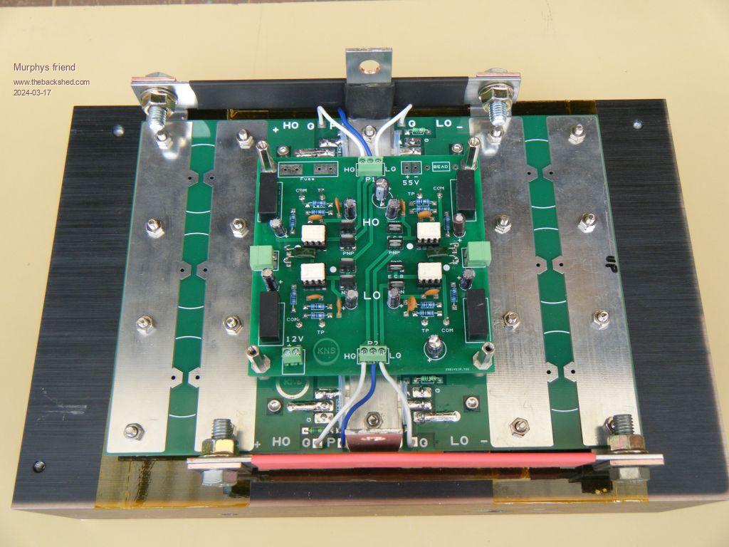

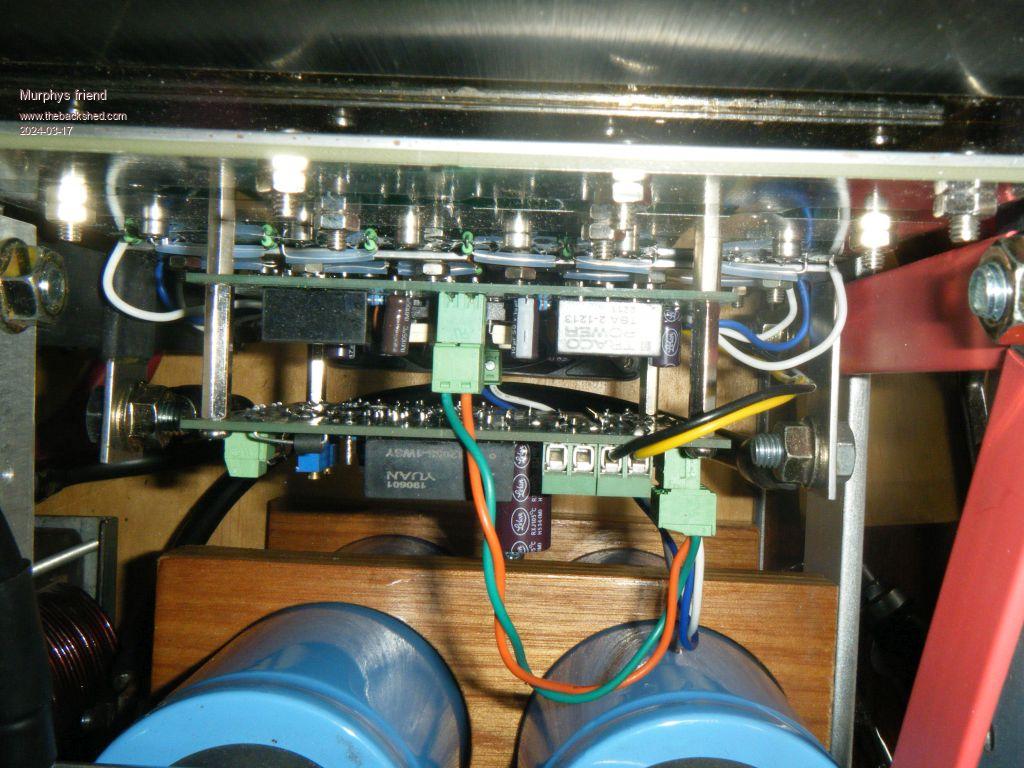

Next is a picture of the power board mounted onto the heat sink.
There are no capacitors fitted to the board as I'm re cycling the big (and expensive)33000uF/100V caps from that warpverter. These are mounted just next to the board.
Also, note the metal spacers for the 100x100mm piggy back boards. 2 of them connect the battery voltage up to the control board for voltage monitoring.
The first piggy back board holds the drivers. it looks like this:

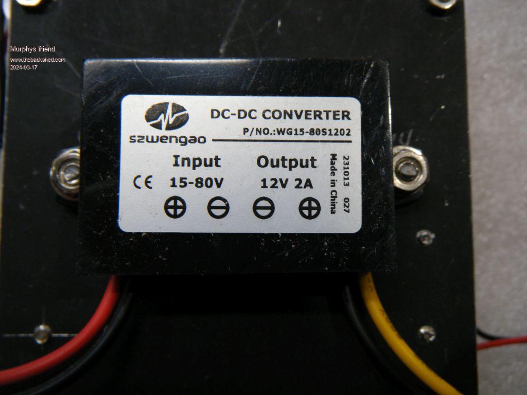

I'm using a different method to get the isolated 15V supply for the drivers. First the battery voltage is reduced to 12 V using one of these:
This also supplies sufficient power for the 120mm 12V/10W fan.
Here is the driver board piggy backed on the power PCB:
There are 4 off, 12V to 15 V, isolated boost modules on that board for the FOD3182 drivers.

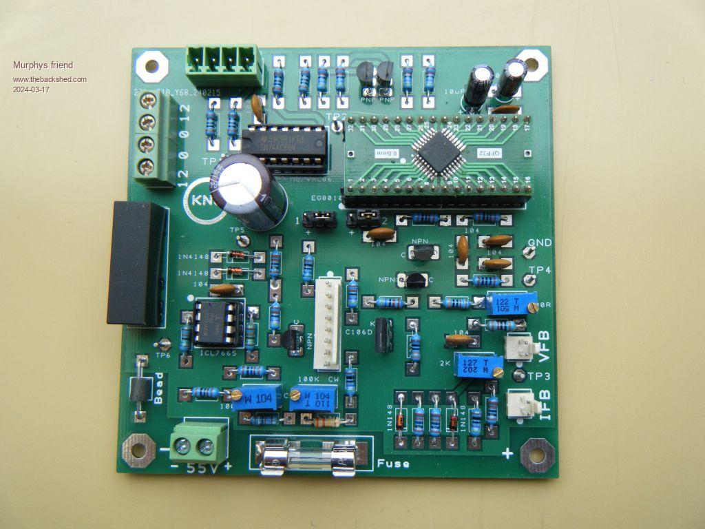

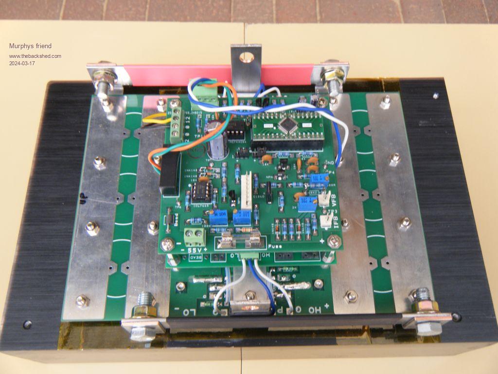

The top piggy back PCB is the control board. Just a simple EG8010 chip with wiseguy's balanced output modification.
Battery low voltage shut down (or start up) and over current shut down installed.
Both use a crow bar method to turn the EG8010 off. Current monitoring is via a current transformer independent from the EG8010.
There is no EG8010 fan control (I use an external temp. monitor with a display).
As you see, no bells & whistles   .
To be continued.

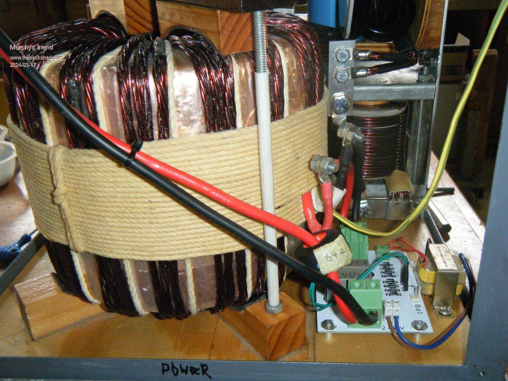

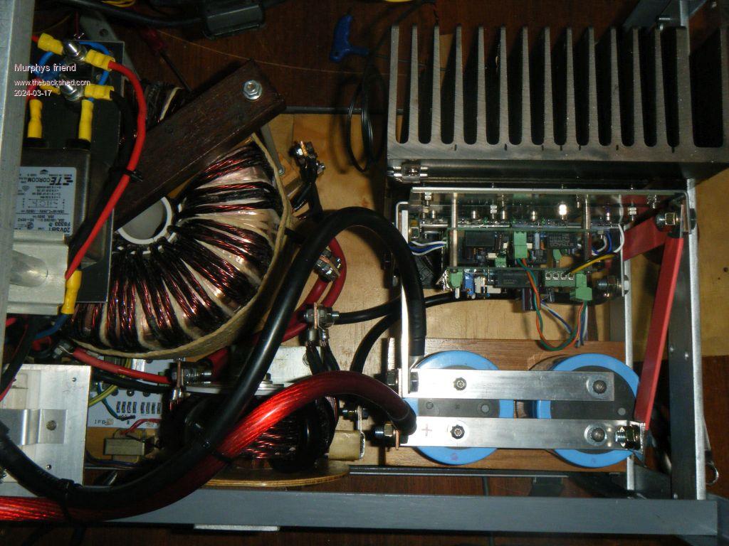

Here is the complete electronics mounted on the heat sink:
This arrangement makes it very handy for setting up the trim pots and testing on the bench top.
Even later, for trouble shooting,  it can be removed from the cabinet as a unit after disconnecting the power and undoing the 2 bolts holding the heatsink in place.

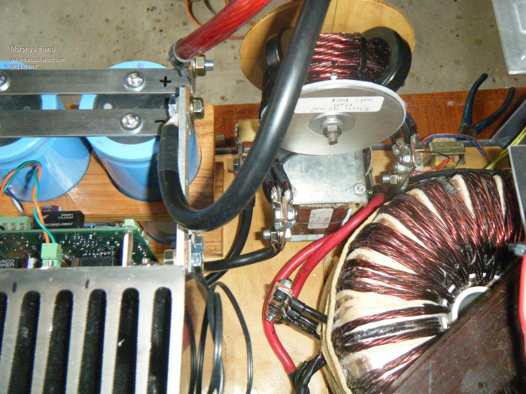

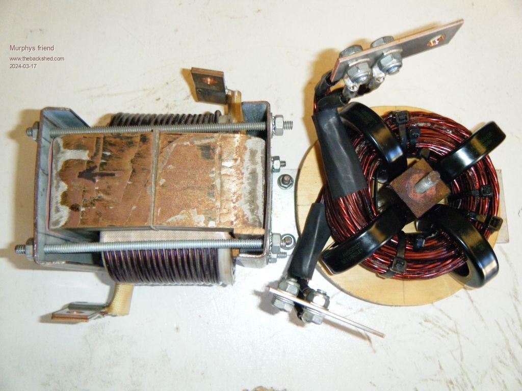

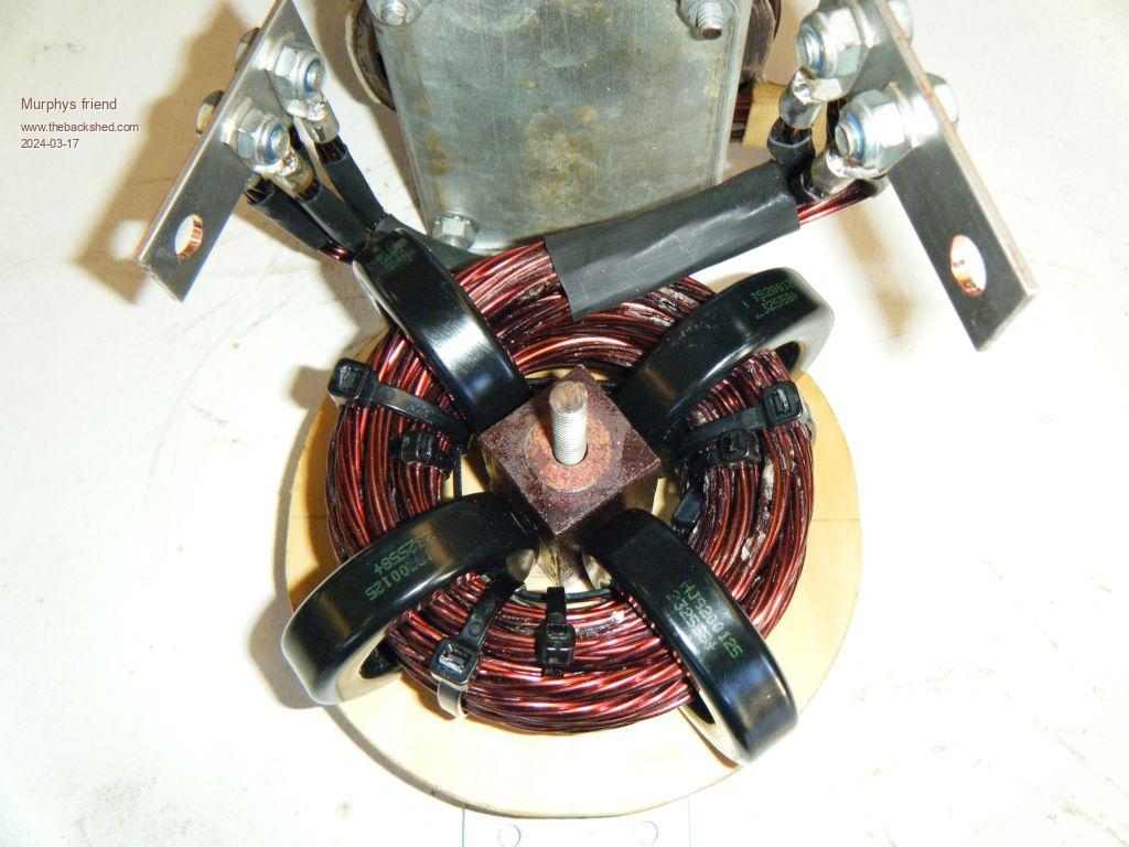

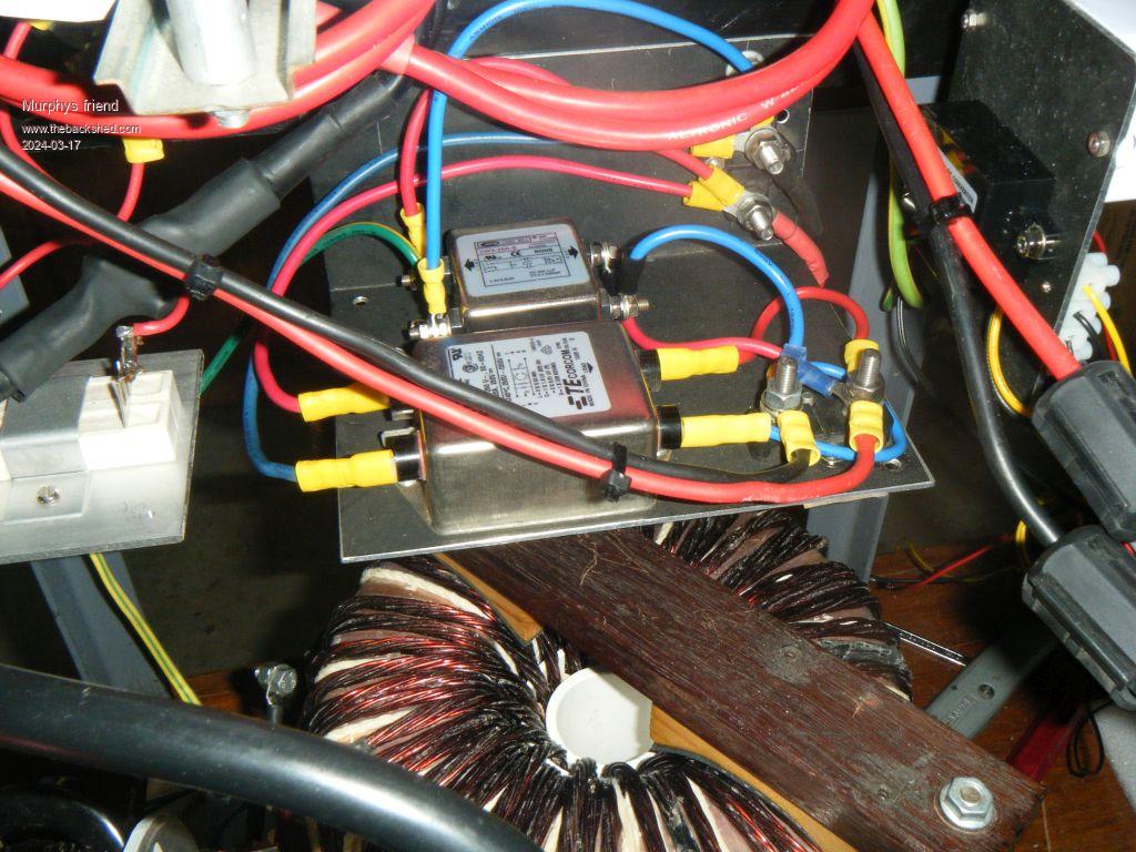

Next, one of the 2 chokes I used:
My thanks go to the person who posted a picture of arranging the toroid rings this way. It makes the coil insertion sooo much easier. I just pre wound each of the 4 x 5 turn coils on a suitable PVC pipe section and then inserted them, corkscrew fashion, one at a time.
Definitely beats trying to get that wire through a stack of 4 cores.

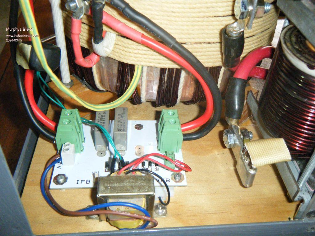

The other choke is a silicon steel version I had made for the warpverter. It had a wedge shaped gap but that proved to be noisy so now it's replaced by a 1.9mm gap.
But that choke gets too hot for my liking at high power so I will replace it eventually with another ring core job like the one above. Perhaps even a 6 core version, should be easy enough to make.
Now some pictures of the rest of the build:
This inverter is going to be work in progress for a while, it will only be yet another spare once I finish tinkering with it.
So far I ran it up to 5KW, could not find any more handy plug in loads.

The "solid 2oz copper" on my power board is also present in the form of two 1oz tracks in parallel, plus the additional brute capacity of the copper busbars. It's just a different way to achieve high current capacity.
BTW, the price of the 3 PCB's on that heatsink, including delivery (by the cheapest option), comes to the grand total of twelve dollars . One has to include the price for the copper bars in the total board cost of course but I do like the M8 bolt connecting advantage they give me.
You may have noted that I don't use small pads for the components nor the tiny tracks one sees on commercial boards. That makes repair or parts changing easy without worrying of track lift off, something you would appreciate as a PCB repair man.

Your choke core comment is noted, if you look at one of the pictures you'll see the windings just about completely fill the toroid hole so, would that not suggest they are spread evenly around the (inner) surface?
That choke does not even get warm with 5KW of load but the choke next to it (silicon steel core) does get uncomfortably hot. I will replace that with ring cores when they arrive.

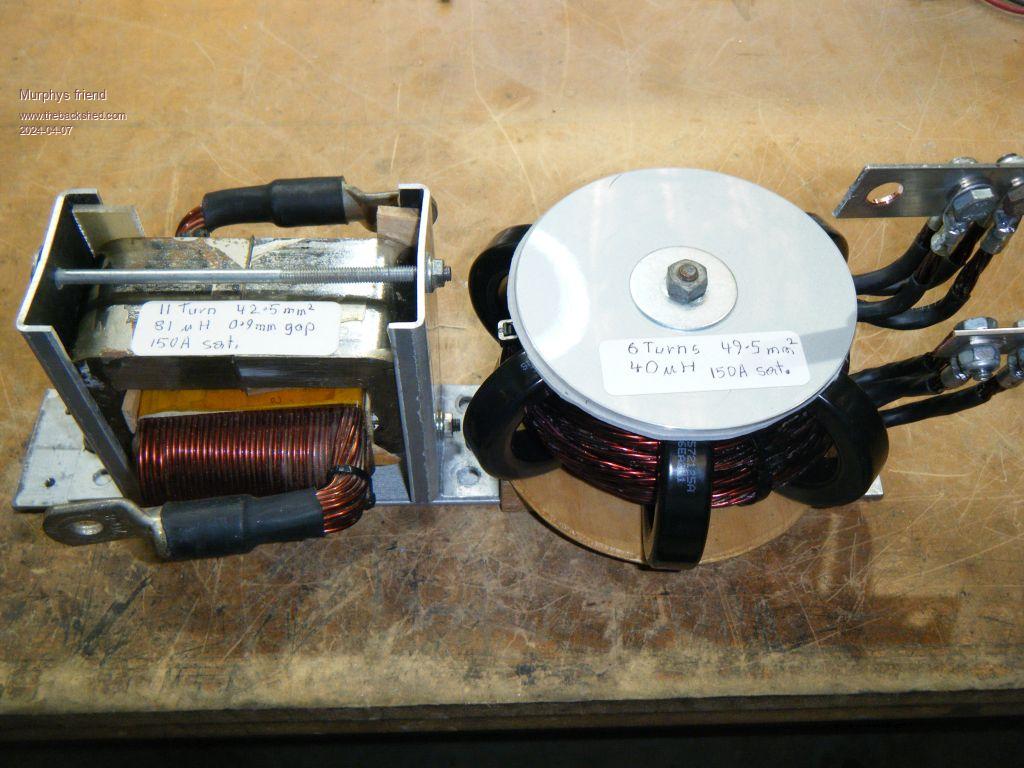

The 39W load above had a choke in each leg of the primary. One was a 6 ring Sendust core choke like this:
The other choke was made from a re cycled Aerosharp C core. Here is a picture of both chokes:
Considering that my 3KW inverter has a standby power of just under 20 W then the 39W of this 6KW inverter look acceptable (to me ).
One thing I learned with that testing is the importance of adequate copper wire size in the choke(s). The C core choke I used initially had undersize wire turns (for the 100+ Amps at 5KW+) and reached 120 degrees C as the heatsink got to 50 degrees C, when the fan turns on.
The new C core choke just got to a similar temperature as the heatsink.

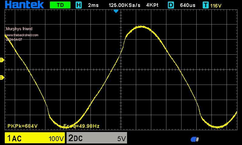

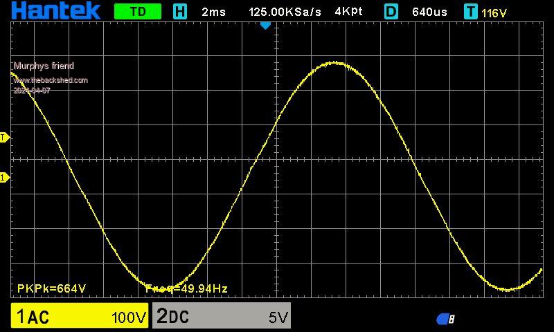

This is a screen shot of the sine wave a 1KW load:
And this is how it looks at 5.3KW (all resistive load):
I also connected a 1KW microwave while the inverter powered about 3KW of heaters.
Surprisingly, the sine wave looked no different to that with the 5.3KW resistive load.

Forgot to mention about the sat. info on the chokes.
I do a saturation test for my home made chokes. The silicon steel core has a sharp knee in the DSO trace when the core saturates so it's easy to see.
The ring cores have a gradual increasing trace with no sharp knee on it. I select my saturation point when the trace slope gets to 45 degrees.
These cores have a very good margin to cope with high current spikes IMO.
