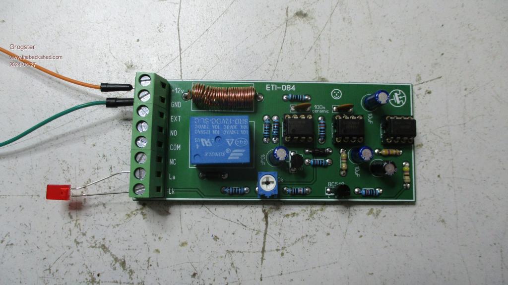

Hi all.
The ETI-084 Car Alarm project from the ETI book "Project Electronics" is still pretty much my favourite simple car-alarm design.  I have used that design a few times back in the day, using the book's PCB layout, drawn out on blank copper PCB with the PCB pen and etching it at home.
I needed one of these recently, so I redesigned the PCB.
Ahhhh, the good old 555 - still such a useful little chip!
The "Project Electronics" book was published back in 1980(the 4th edition), and so therefore, this project is 44 years old, but still a very useful car alarm design!
Correctly installed, it is pretty much impossible to avoid setting off the alarm, as any kind of load on the car's electrical system, triggers the alarm.  It self-resets after about one minute, to comply with noise pollution rules.  It is very simple, but very effective!
As 44 years have passed since the official publication, I figure I am OK in posting this new PCB layout.
The circuit is exactly the same, just a different PCB layout and relay.
Please let me know if this still somehow - after 44 years - is still a copyright issue, and in which case, I can simply delete the thread.
For now, I will only post a photo of the working new PCB, but I won't post the Gerbers till I am happy that it is not a copyright issue to do so.  With so many years having passed, and ETI no longer being around as a business or publication, it is something of a gray area to me, so please let me know your thoughts on this aspect of things.  Would love someone to comment, who knows Australian copyright law.
Assuming that due to the passage of time, it is OK to post a new layout, I can then upload the Gerbers for anyone who wants to build one of their own.  Scanned copies of the book are easy enough to find online via Mr. Google.

Posts: 10085
Posted: 08:32am 09 Aug 2025
Just installed this today on my latest acquisition - a 1972 classic Morris Mini Clubman, and just opening the door - and turning on the courtesy light - sets it off.  This is such a lovely alarm design, despite it's age.
