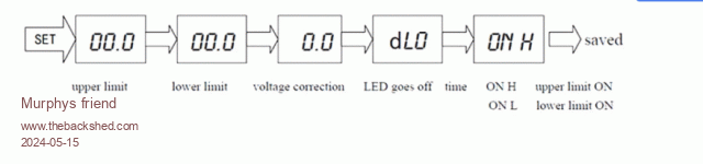

Both items arrived today but there were no instructions how to program that A30 relay included.
Surfing through different sellers of this item on Ali found one that had the info I was looking for.
So I did a screenshot and attach it here for those who might find it useful:
The programming is sequential, stepping through each digit & function with the 'SET' button. Changing the digits at each function with the 'ENTER' button.
dLO means LED display on time in minutes, set to 00 and it's on all the time. If its set to time out then it will only come on again after the power+ is disconnected briefly.
I set mine so the relay comes on at the upper limit, as this only happens in a fault condition to disconnect the MPPT (via Kilovolt Rly.) one can save about 1 W of standby power. The relay contact is SPST so the Kilovac can be connected to be on or off when the A 30 Rly is ON.

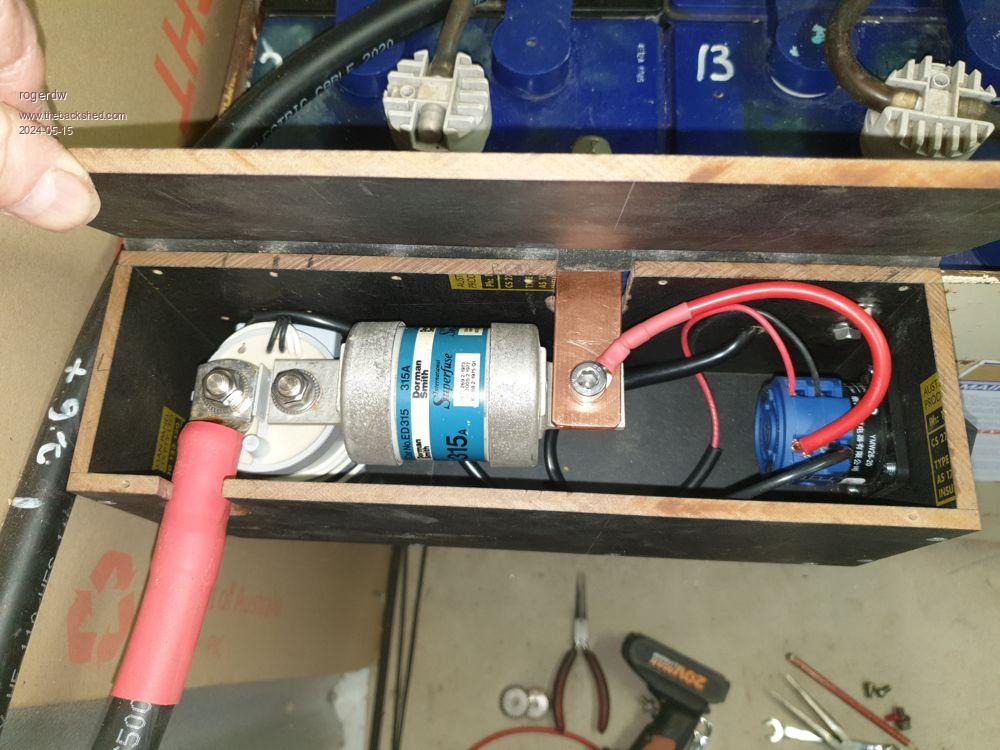

I had the same question when I installed mine and came to the same conclusion  ...  but now that they are in  ...  I realise they often have reverse current flowing through them.
The one for the Warpverter I installed with the battery supply to the A+  ...  but of course when it's backfeeding, there's lots of amps going the other way.
And same for the battery disconnect one  ...  a lot of the time current is flowing out of the battery to the inverter  ...  but there's massive current flowing the other way when there's lots of sun and the inverter is not using a lot  ...  potentially over 200 amps.
The battery lead was getting quite hot when I fitted the battery disconnect one and I had to have a couple goes at getting it all tight enough. The stud base is not a very large diameter compared to the lug  ...  so I fitted a larger stainless washer between them. Had to remove it to stop the voltage drop and hence the heat. All seems good now, though I will check it regularly to make sure it behaves.

Hi Rodger, I have operated the Kilovac many times at 600A DC input at 50vdc with the connections reversed, so it appears not to faze them, like I said, it may be different at +300vdc though.
Looks neat, I find the terminal area is fine if the cable connectors are correctly sized, but it also depends on the quality of the connector, I have almost zero voltage drop across the terminals at a constant 200A with quality cable connectors, some are crap.
I know you are aware of all of the above, and especially washer quality and the flatness of both the connector and washer. I've been caught out on both of those before, it's amazing how the slight imperfections really show up in heat and voltage drop when trying to draw 500A through the system, sure highlights any weakness when starting high surge startup loads.

So 600A x 50V = 30,000W  ...  how long was it supplying 30kW?
I was trying out my big ducted aircon and the Warpverter + house was drawing 10,500Watts.
That's only 210A and that seemed extreme  ...  though that was for 5 minutes at a time.
When I fitted the first Kilovac inside the Warpverter, all the connections were with thick solid copper bar  ...  so I haven't had any heating issues there. The battery one though, I was afraid the lug was softer and the small diameter stud base would compress into the lug and become loose. I think it's going to be okay but I will keep an eye on it.
Initially I got quite a fright when I felt the fuse and it was hotter than I could hold  ...  and thought it was the fuse dropping the voltage and causing the heating  ...  but it was the battery lead connection on the contactor that had a voltage drop.
That heat transferred through the contactor and into the fuse  ...  and being in the enclosed box, got very hot. Lucky I spotted it quickly  ...  plus the box is made of fusebox backing material  ...  so is pretty robust. It does run cool now though, thankfully.
All a learning process.
Cheers,  Roger
