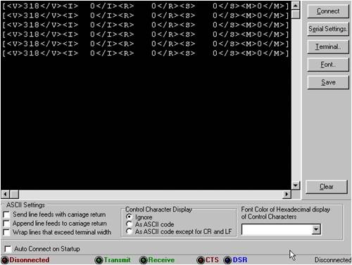

Is my turn to have problems on 12F675 controller. I get weird data on MCLR pin, set as digital input, of course.
I used a pulse generator to test the RPM and Windspeed counting pulses.
See RPM data (value between <R> and </R> tags):

The value from <R> tags should be identical as in <S> tags. But are not and I don't know why (should work). Until now I used two 12F675 to be sure is not about a defective chip. And software seems to be ok. In last version, after analogue readings, I'm switching completely to digital, disabling analogue. No reason not to work. On other pins, counting pulses is working ok.

Good news!
No modifications needed because is working ok. The pulse counting wasn't accurate until I used (on breadboard) a optocoupler between TTL pulse generator and microcontroller pin to kill the noise.
Glenn please, if you want, make a software version for this logger output.
It output <A>,<I>,<R>,<S> and <M>
