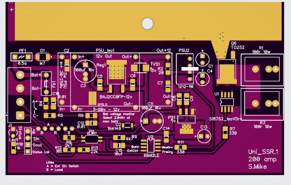

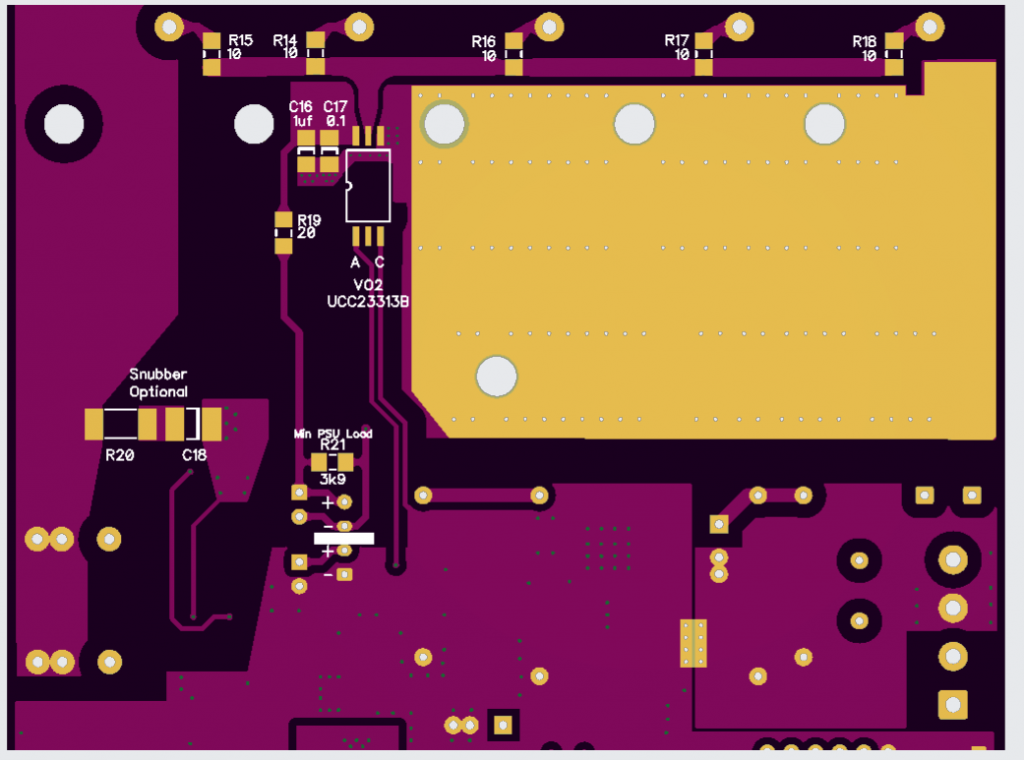

I have a number of projects coming up that require a relay switch that can switch a min of 200 amps at either 48 or 96v DC battery supply; normally I use those evac relays, readily available on eBay or AliExpress.
However some extra functionality is also required, such as smart switch capability, being able to turn off if the incoming voltage drops below limits and incorporate a pre-charge function when activated to charge up any huge capacitive loads prior to final switch closure. Seems easier to do all this on a single pcb using mosfets, costs work out way less than the evac relay.
Combined on resistance is about 0.0004r, so power lost at 200A will be 16watts, 100A = 4 watts, these higher currents will only be of short duration, so overall power lost\heating will be minimal.

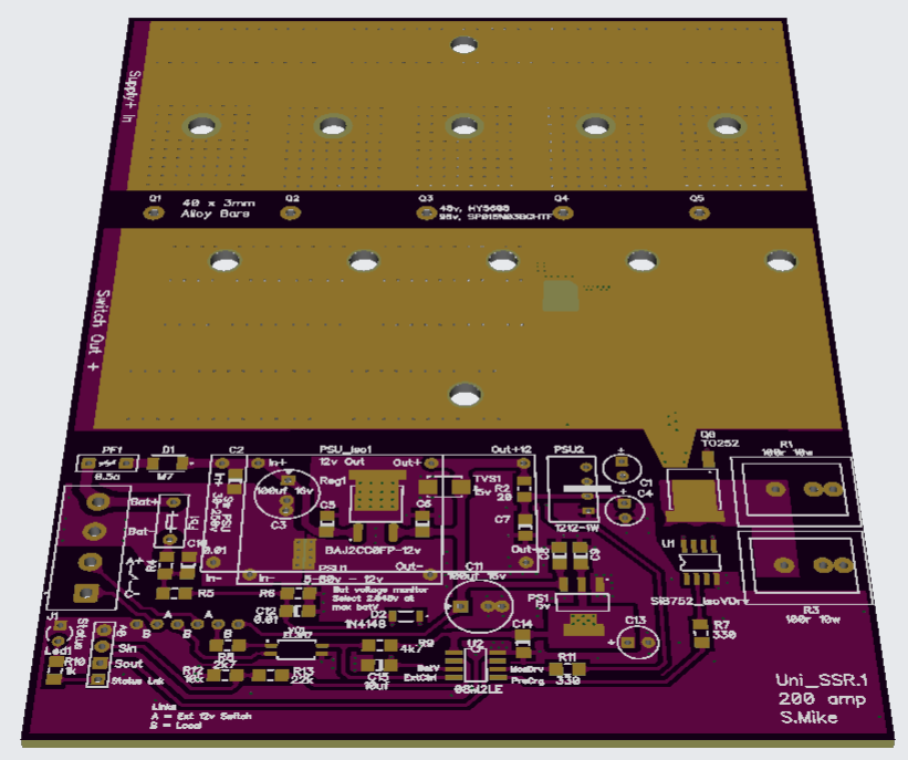

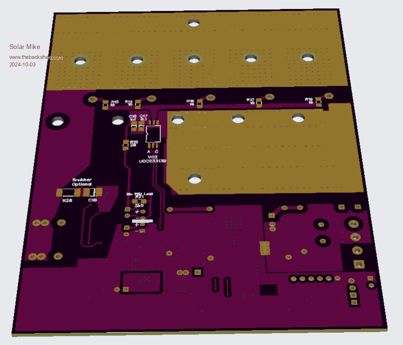

Have used 5 mosfets to make a uni-directional switch, driven from an opto isolated 3 amp driver, the pre-charge mosfet also driven from an isolated voltage driver, switches a resistor for a short period. The main mosfets bolt to 40mm x 3mm alloy bars, for current capability, the bars protrude out the bottom of a plastic box.
CPU is a Picaxe 08M2LE to provide some voltage measurement and delay timing logic, an opto coupler input is used for switch activation, as the circuit is not that complex, I don't have a schematic drawing as yet, but will do one at some stage. PCB 105x148mm fits inside readily available low profile plastic cases.
PCB:
PM me if anyone wants the gerbers.
Mike
