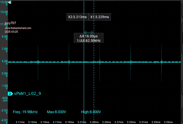

Hi everyone,

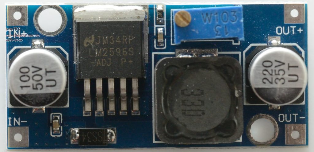

I'm working on a custom Arduino-based inverter project that generates a 20 kHz carrier / 60 Hz fundamental complementary unipolar SPWM—same output style as the EG8010. I'm experiencing severe DC-side noise that’s affecting:
Arduino Nano Every (ATmega4809) analog readings
Serial communication (UART glitches and resets)
AC input feedback from sensors like ZMPT101B and WCS1700
System Details:
Inverter runs off a 36V–50V DC supply
SPWM generated by Arduino Nano Every (60 Hz fundamental + 20 kHz complementary carrier)
DC rail has 4 × 10,000 µF bulk caps (PowerJack power board)
5V line originally from LM7805, now from LM2596 buck converter
Arduino controls H-bridge and senses AC output via voltage/current sensors
Images:
What I’ve Tried:
LC filter (82 µH + 2200 µF) after 5V regulator
100nF and 10µF ceramic caps at load
Common ground for all circuits

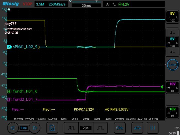

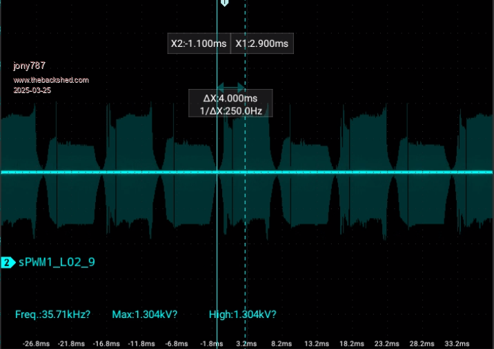

Scoped noise is ~20 kHz ripple/spikes riding both VCC and GND
Considering isolated DC-DC converter to isolate Arduino and sensors
Questions:
How are others managing DC-side noise in inverter or high-frequency switching systems?
Are you using fully isolated supplies?
Any success with ferrite beads, star grounding, or optical isolation for UART?
Are you isolating sensor power and ground separately?

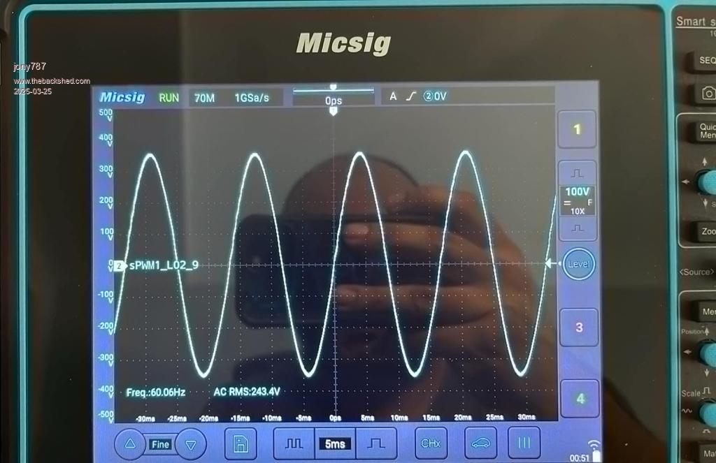

The sinewave looks good overall with minimal wobble at zero-volt crossover.
Thanks to Warpspeed for guidance on transformer tuning—I tuned the secondary close to 90 Hz with a 2.5 µF capacitor.
Right now, I'm powering the inverter from a DC bench supply during testing. The sine amplitude scales with DC input. The inverter is functionally working, but I must fix the noise to get reliable AC voltage/current readings.
Any feedback, schematics, or scope images showing how you solved similar issues would be hugely appreciated.
Thanks in advance.

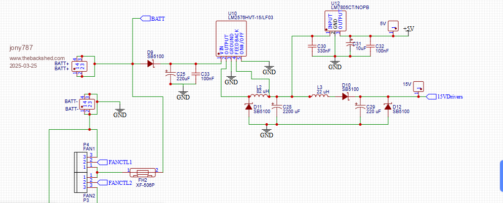

I started the project with an Arduino Nano 328p and had a lot of display issues like you mentioned. Using the Arduino Nano Every ATmega4809 have solve almost all my previous display issues. I see your point in terms of the lowering the voltage, I actually go from the battery voltage to 15v via an LM2576HVT-15. before the 5v power stage. I had a LM7805 and the 20khz noise still present. I will look into shielding what I can and will also need to test the inverter connected to the batteries. Ill have to revise the PCB and will look into improving the  grounding across the board. Thanks for your feedback.

I had a quick glance at the DSO captures you posted and did not notice anything unusual with respect to Inverter noise.

Do you have an inductor between h-bridge and transformer? This helps lowering the di/dt and so lowering some emissons. You might want to increase resistance of gate resistors if power layout is not optimal. Each current conducting path to your controller can inject some rubbish, ferrite beads arround i2c for example helps a lot, but you want to find the cause first. Optocouplers for the pwm singals like in wiseguys design, etc..

In my early days of noise chasing I quickly determined that sometimes the noise is not having any effect as it may be common to the ground and supply lines and everything in between.
This is especially true when very fast rising and falling current levels are being switched as in your inverter, and being monitored with a CRO. Sometimes you can end up spending a lot of time chasing shadows.
To determine if this may be what you are experiencing, connect the probe earth clip to the probe tip and touch the (now grounded) tip to the chassis or the ground wire of the inverter whilst it is running. (The supply rail can be monitored too but use a 10 nano ceramic in series with the grounded probe tip).
You may need to experiment with the trigger level to see the "noise" in question.
Whilst intuitively the noise may appear to be the issue do treat everything else as suspect too - until proven innocent.  I agree with KeepIS the waveforms looked typical to me, I was going to ask how you got it so quiet

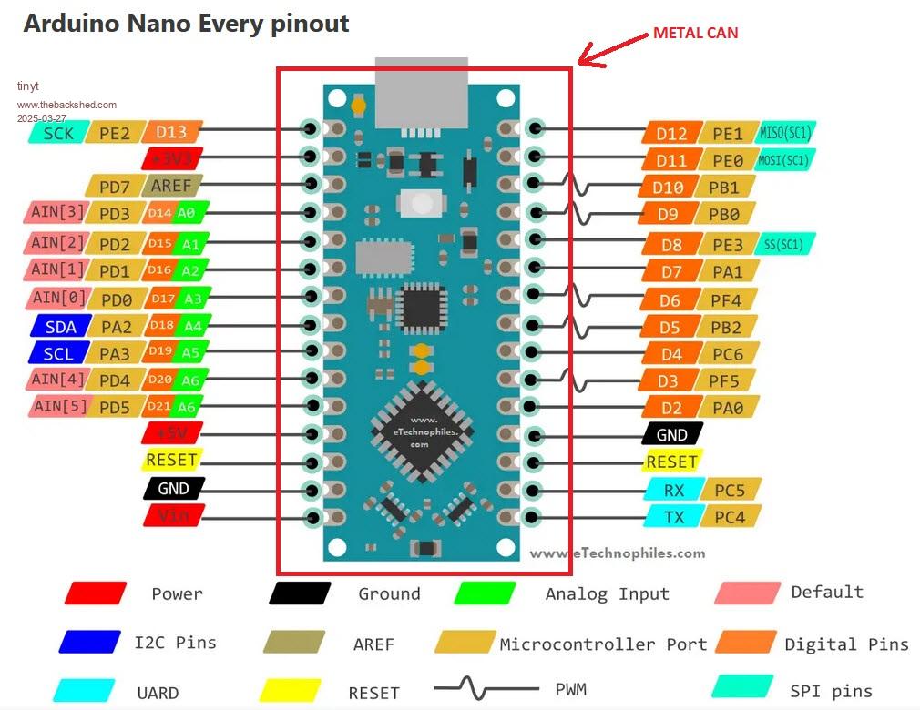

Since you are revising your PCB, together with the ground plane under the Arduino Nano Every, enclose the top of the module in metal can connected to the ground plane.
Also put an R/C or L/C filter outside the metal can but close to it at every pin of the module. Edit: Except for the GND pins of the module, these should be connected directly to the ground plane.
This way even if it is noisy outside the metal can, hopefully the module is shielded from it.
