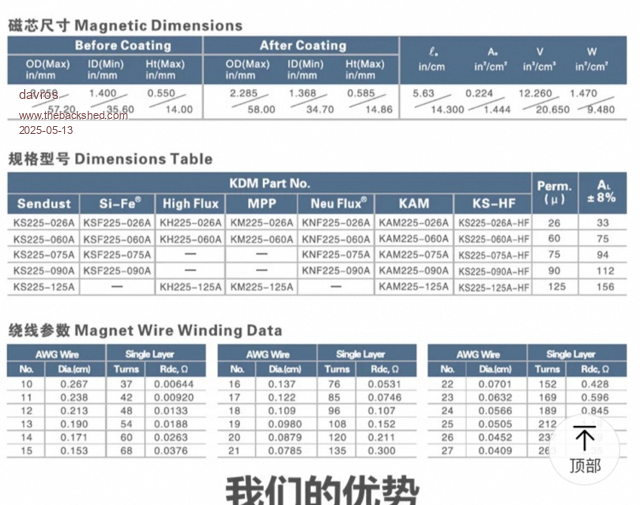

Posted: 01:27pm 13 May 2025
same?

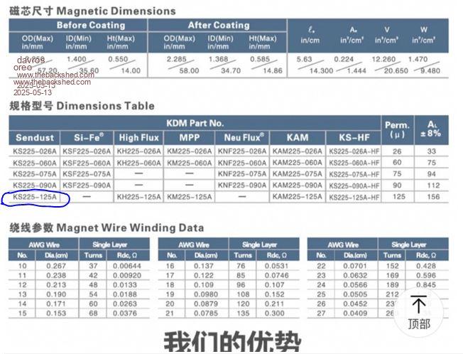

Joined: 11/12/2020
Posts: 138
Posted: 02:03pm 13 May 2025
Keep in mind that this core size is typically best bang for the buck and can be found in other inverters so can be repurposed.  Larger sized cores can support thicker wire and perhaps be packaged better.  KeepIS is using ~10 stacked MS225 cores to build each 20uH inductor.  Check out his thread for pictures.
Dex is using much larger cores -you may wish to check out his thread.  For example, a KS520125 core has a 3" internal diameter and 2 of them with 7 turns would give you a 20uH choke that would support 8kw.
