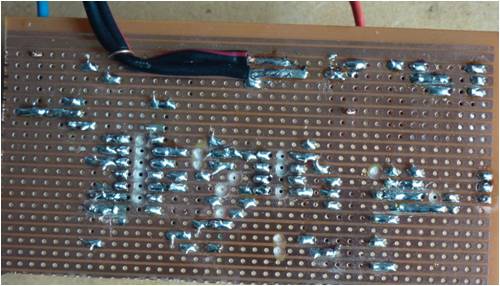

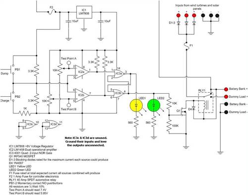

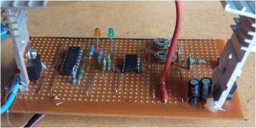

I have built a diy charge controller from the schematic attached and it will not charge the battery. I have it connected to a 12v supply and when I short the header (instead of adding buttons) to force it to charge it only turns the dump led off and not the mosfet and it doesn't turn the charge led on. The blue and red wires go to the relay and the other two go to the battery.
Any ideas?

What voltages do you get on pins 4, 5 & 6 of IC3?
Do they change when pressing "buttons"?

pin 4 is at 0v all the time.
pin 5 is at 5.8 when there is no jumper and when the jumper is in charge position, it is at 1.95v when the jumper is in the dump position.
pin 6 is at 1.96v with no jumper 5.88 with the charge jumper and 0v with the dump dumper.

Well if you can get a low on both pin 5 & 6 at once pin 4 should go high.

After discovering I have a p channel irf9540 instead of the n channel irf540 i measured the voltages again and got 4.9v when the jumper was in the dump position, but the led still wont light and the mosfet doesn't turn the relay off/on. Would an irf840 work as I have heaps of them lying around. I know it's overkill but if it saves me spending another 8.50 then I'm happy.

Edit: I have the led going! There was a direct short to ground. The lower variable resistor had a little piece of solder between its top pin and the led track. The mosfet still won't switch which has me scratching my head as it should still switch I thought, just in reverse.Edited by terrapinlogo 2010-08-26

99.9% of the problems folkes have with building controllers and them not working is due to solder bridges, mainly with vero board as you have used.
The other problem has been wrong parts used.
It looks that you are lucky and have both these problems
Give the bottom of the board a scrub up with some metho and an old tooth brush to remove any resin and gunk, then let it dry and check the circuit for solder bridges.

It was going for about 5 mins but then I turned it off and on again and it doesnt work properly now. Something to do with the variable resistor connected to pin 5 of the comparator. You turn it to on end and you get 6.2-8v and the other and you get 0-2v depending on which end you start at. Those voltages cover 90% of the range depending on the end you start turning from. Which means I cant get the 5.95v required at pin 5 to set it up properly. It is probably a short somewhere bu I'll be damned if I can find it.
Damian
Edit: Fixed it. I had totally overlooked a track cut. Pin 5 of the comparator was shorted to pin 7 of the comparator and pin 6 of the nor gate. Hopefully this time it stays going.Edited by terrapinlogo 2010-08-28

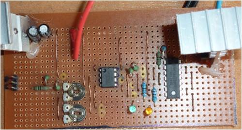

I have the board all going now but the turbine is strong enough that it pushes the voltage that the charge controller sees up to 15v when the battery is still at 12v. This is causing the relay to click on and off and sound like an angry blow fly. Any ideas on how I could add some sort of time delay so that the relay can only change state every minute or so. I'm thinking some sort of capacitor and resistor network but I have no idea on how to hook it up.

What this normally means when you have relay chatter is the hysteresis is not wide enough.
To fix this you need to lower the cut back in voltage on the trimpot
For example the cutout (high) set to 14.0 volts and the cutin (low) set to 12.8 volts.
What this will do is make the dump stay on once tripped for longer until some power is used from the battery and then it will let the controller reset to charging.
At present as the voltage goes up the relay trips then the voltage falls a fraction and the relay switches off and the volts go up and the relay switches on again in a cycle...this will kill the relay REAL FAST....NOT GOOD!!!!
Just lower the cutin setting (LOW) till you get the relay to hold in, the battey voltage will start to fall back to resting voltage and your low point needs to be a fraction below resting voltage or very close to resting voltage.
