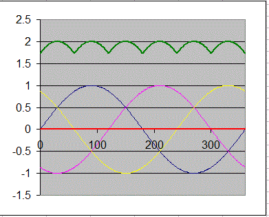

I guess what I am on about is hard to grasp for many, but here is a picture, that will help.
There are 3phase waves that most will be familar with.
There is also the 3phase full wave rectified, and the interesting flat red line.
My intention is to provide a loading similar to the flat line. The rectified waveform becomes highly asymetric with loading [especially a battery, or capacitive type].
I have tested a purely resistive loading on my windmill and the resultant alternator sound is silent, while if the waveforms are rectified first with the same resistive loading, the alternator develops hum.
Just have to get the electronics to do their thing now.
Gordon.

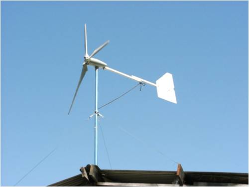

I can see what you are looking at, as my old mill I have been playing with different things to try to make it more useful at lower wind speeds.
The humming noise you mention was participially bad with it to, but my present configuration has quietened it down considerably and in a way is doing what you are talking about.
The Hum as I understand is caused by the switching transients of the diodes on the coils that have an inductance that is establishing and collapsing every cycle.
What I have done is put a large Cap 350000 uf across the diodes to give them something to charge from virtually 0 volts up, when it reaches 10.5 volts AC the GTI starts to draw current and its MMPT circuit draws more current as the volts increase and when it reaches 21 volts AC the second set of diodes start to conduct and charge the battery.
The GTI has a current limit that comes in at 12 amps so all extra current is diverted through the battery diodes, and in the heavy winds two weeks ago it was maintains 30 amps into the batteries and 12 amps into the GTI, 1200 watts, not bad out of an old 500 watt unit. In gusts it was pegging out the 50 amp meter, I pulled it down after the windy days to see if there was any overheating but none apparent, sorry no nice graphs yet as I am struggling to get some other things finished before I loose more hair getting the logger going.
It runs smoother and quieter than before as it is on the roof of the shed that is noticeable, one other thing is noticeable is that it has reduced the cut in rpm to charge the batteries, I think this is because the coils are conducting earlier they have more inductive reactance and generate a stronger reactance field to react with the magnet. Too long since I did the theory so am not sure on that.
It would be nice to charge the batteries from low speed so I see the potential in what you propose, the only thing that concerns me is the low wattage available as the output to the GTI is only 5 amps before the main rectifiers cut in.
