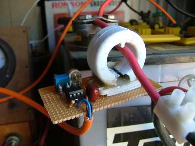

On a different matter, I like your home-made current probe, but am curious - given your claimed inaccuracy (an amp or two at 10A), wouldn't it be far simpler/easier to use the op-amp to buffer (and increase) the voltage drop across the battery negative, and feed that into the A/D? A simple gain adjustment to calibrate for whatever (arbitary) cable resistance there is, and use the cable itself as the sense resistor?

All good points. I would like to revisit the controller in the near future, and maybe consider some sort of intelligent charging. One of the problems with the current design is most of the pins, code and variables are used just to drive the LCD display. This leaves little room for anything else. I would like to have two chips, one to drive the display, and one to control the charger. This will give a charger with much more processing power, and more output pins as well.

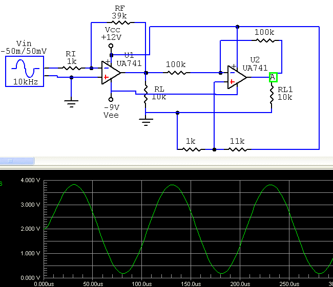

Yeah I'm not happy with the hall sensor. A couple of op amps across a shunt resistor would be better. The cirsuit would need to measure plus and minus amps, as I intended it to display current drawn as well as charging current. I was working on this circuit...
The first op-amp ampifies the +/- voltage from the shunt to a range -2 to +2 volts, the 2nd op amp moves this voltage up to the 0 to 4 volt range, usable on the PICAXE. So 2 volts = 0 amps.
What's with the love-afair with 741s?
There are much nicer, much more stable, lower-power opamps which will swing rail-to-rail and come with 2 in an 8-pin pkg. Been a LONG time, but LF353 springs to mind? DC-shifting is certainly the go to make it easy to read charge/discharge directly from the A/D, although it does reduce your resolution a little. Still, 9 bits should be enough :)
  Gizmo said
Just thinking out loud here, looking for an easier way to do it.
The rest of your circuit doesn't use a -Ve rail anywhere from memory, be a shame to have to make one just for this.
How about, if you used a high-impeadance divider from a known reference but not to *GROUND*, but to the other side of the shunt.
That'll make "ground" *SEEM* to move up and down a few millivolts, but your divider will ensure the input to the opamp will always be moving a little but only in +ve domain. The other input to the opamp would set "zero" to the midpoint. Apply feedback for required gain to scale it nicely to the A/D full-scale. (Does that make sense?)

I have a drawer full of 741's so I tend to use them for everything, and the circuit simulation software I use has them listed. But I'm open to suggestions, I would like to get rid of that -9 volts.

  Gizmo said  I have a drawer full of 741's so I tend to use them for everything, and the circuit simulation software I use has them listed. But I'm open to suggestions, I would like to get rid of that -9 volts.
Well, that's a valid reason I suppose.
Still, I reckon the convenience of having them is outweighed by their need for bipolar supplies, noise, compensation problems etc.
Still, thinking about it a little more... you can probably use a 741 in the sensing circuit with a little creative design work.
Again, without thinking too hard....
Using 0V/Ground as your reference and +V to power your opamp and other devices, as long as the input from the shunt doesn't get too close to the 0V rail you're ok. Imagine, if you will, the sense input being part of a voltage divider. Lets just say it's a 10K from sense to opamp input, and another 10K from there to +V. Lets assume +V is 10V for now because it makes it easy.
With no current flowing, the shunt will be at 0V, so opamp input is at +V/2 = 5.000V
With a 10mV/amp shunt, with 10 amps you'll have 100mV above (or below) ground indicating charge or discharge.
Your divider will now be 10K+10K from 10V to 0.1 or -0.1, so the opamp input will be 4.95 or 5.05V
Ok, so you have to double the gain of the opamp, but big deal!
(You could apply this to the non-inverting input of the opamp, and use the inverting input purely for the gain control)
If you A/D is 10 bits from 0 to 4.096V thats what, 4mV/bit.
The 741 can't really swing full rail to rail, so even if it only went from +1 to +3 and you used half the A/D range, you could measure +/- 25 amps in 512 steps, (10 bits is 1024 levels, half above, half below) so +/- 25.6 amps in 100mA steps. Or +/- 12.3A in 50mA, or +/- 50A in 200mA steps. Sounds pretty workable to me.
