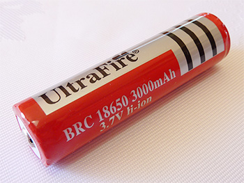

I will try it with a plug pack for the bench, then build one with 18650 rechargables. I use them in my torches so I have always got them with me, they have plenty of hoot.

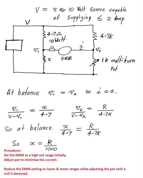

Here is an idea. Make a simple Wheatstone Bridge.
You could use a multiturn pot with a multiturn calibrated knob.
Or simply, balance the bridge, open one end of the pot & measure its resistance with the DMM.
Len
Edit. I have replaced the diagram with a modified one. I inserted a 1 k resistor in series with the DMM.
This is to limit the current to a safe value in case x is high or open & the pot is, by chance, near the low resistance end of its range.
