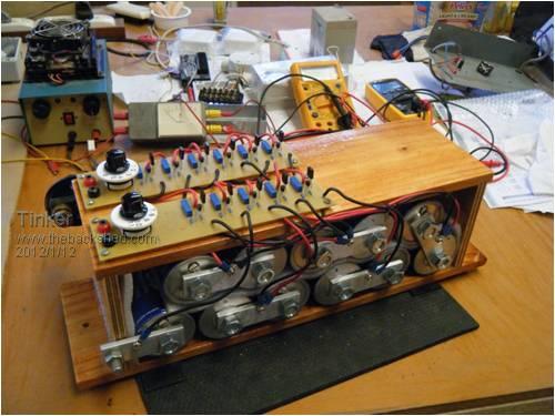

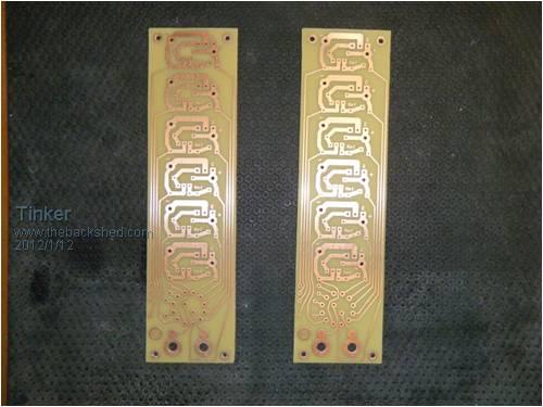

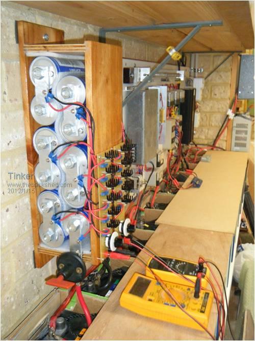

I have almost completed my ultracap set up now. First I made two PCB's
for the equalizing circuit. I used a simple high current shunt regulator that I saw in the Texas Instruments application notice for the TL431 adjustable precision shunt regulator.
The complete arrangement, all wired up can be seen on this pic
There is a rotary switch on each board that selects an individual capacitor so that its terminal voltage can quickly be checked on a plugged in meter.
Each board accommodates 6 identical equalizers but since I only use 11 capacitors in my 24V nominal system one board has only 5.
First tests - with my variable power supply - indicates the circuits are working. One shunt transistor got very hot (its cap had the highest terminal voltage and excess was shunted off) so I think I will fit small heatsinks to each transistor.
Since my power supply only makes 26.5V max I was wondering why the transistor got hot as 26.5V is way below the max combined cap voltage limit. It turns out there appears to be a faulty TL431 on one board whose associated cap was way undercharged. I will fix that tomorrow, then do some more bench tests and if all is well mount the cap arrangement on the wall above the battery bank.

Thanks fillm, for the compliments. I am hoping the ultracaps supply the power surges when the two fridge compressors cut in and even the load on the battery bank.
Wind power is only at the experimental stage at my place, tracking solar panels are the main power source.
Bob no chance to test the caps at starting my car, its a modern diesel motor .
BTW, the faulty component turned out to be the shunt transistor. I will definitely fit small heat sinks on each, even though they are rated at 1.5A each (BD140's). The problem was most likely caused by myself trying to adjust the balancers with them connected to the capacitors. This is a frustrating exercise and the adjustment is much easier without any capacitor connected.
Just connected 2.8V (via a 0.47 ohm resistor) to each balancer in turn and adjust the pot for 2.6V at the rotary switch selected multimeter terminals. That way each balancer can be adjusted precisely to the same shunting voltage.
Now I need to get a bigger transformer for my bench supply so its capable to source 29V DC. I can then test the cap bank on the bench and see if the individual caps equalize once their voltage reaches 2.6V.

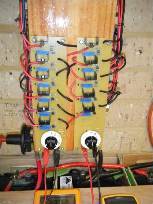

Posted: 01:05pm 15 Jan 2012
My ultracap bank is installed on the wall above the battery bank now.
The initial balancing worked rather batter than I expected. Each balancer was first preset to 2.60V. Then I connected the cap bank to my power bench supply set to 29V via a series resistor and watched the voltage at each cap slowly raise.
As soon as the first reached 2.6V its associated balancer started to shunt current to the others in the chain. The transistor got quite hot at this stage, just as well that I had fitted small heat sinks to each.
But the other caps quickly caught up and the transistors cooled down again.
Initially there was as much as 0.3V difference in charge on the capacitors. Once balanced that difference was about 10 milli Volt. 24 hours later they are still all within 30 milli Volt, even though today the battery bank never got full enough to reach the cut in of the balancers.
I think this circuit works rather well for my installation. Max battery bank voltage (set by the charge controller) is 29V. This equals 2.636V across each cap if they are balanced. Since the balancing starts at 2.6V there is a max of 36mV that the shunt transistors have to bleed off. These transistors are connected straight across the cap terminals, there is no series resistor.
First impressions are the battery bank overnight minimum voltage (caused by the fridge compressor starting up) is now higher. Time will tell what else is changed.

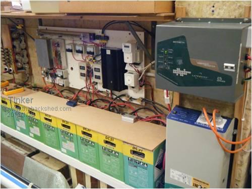

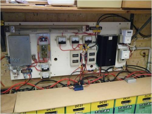

Tinker, That is an impressive setup you got there Mate! I was just wondering if you could show off, or maybe explain some of the other stuff we see on the walls? I always like seeing how others have setup their systems? Helps me get ideas on how to setup my own power station someday soon.

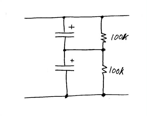

As far as I can gather, you have used shunt regulators across each cap to ensure that they all have about the same voltage across them when connected in series.
Is this true?
My recollection is that all you need is to shunt them with is equal value resistors.
The resistor string causes balancing by allowing some charge to by pass some caps so the voltages are approx equal - as set by the voltage divider effect of the resistors.
As I guess you know, if there is no balancing, then the voltages depend upon the capacitance of each cap.
Since they won't all be equal but they will all have the same charge, then the voltages won't be equal since
Q = C*V hence C1*V1 = C2*V2 = C3*V3 etc.
Therefore V1/V2 = C2/C1 etc. so V1 can only equal V2 if C1 = C2.

Len, I'm not sure what you are getting at with your resistor chain. I don't like that idea as my capacitor bank connects directly (in parallel) to my 24V battery bank.
Any resistor string across the capacitors would also be a constant current drain (read power waste)across the battery bank.
What the shunt regulators do is *nothing* , most of the time, no battery power wasting. Only if the battery bank gets full enough to raise the terminal voltage to 28.6V do the shunts come into play and prevent the maximum voltage across each capacitor getting above its rated voltage of 2.7V.
This certainly works when I monitor each cap voltage, after equalising they are within less than 20mV of each other. Before equalising the difference is less than 40mV.
I'm not too worried if the charge on the individual capacitors differs slightly from the others in the string but I do *not* want to exceed their maximum voltage rating.

Thanks for your interest Robert, below are two more views of my RE power plant
Klaus,
This technique is not suitable for your situation because of the large size capacitors, and as you said, the constant current drain. It is used in Power Supplies when you need a high voltage capacitor that can't be bought for can't be bought at a reasonable price.
In that case, the capacitor values are much smaller than in your case and therefore the resistors can be relatively large. A small current drain is of no consequence tsince the power is being supplied from the mains. I mentioned it mainly as a point of interest.
Len
Here is the basic circuit.

Tinker, Thanks for the additional photos of your setup. I really like the way you have everything so neat up on the wall. Very impressive system in my personal view. Excellent Mate!
