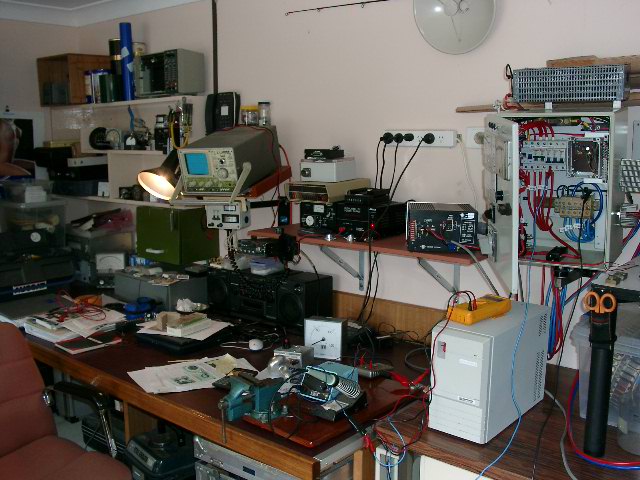

Posted: 05:46am 16 Nov 2005
Bruce has the cleanest workskop in the southern hemisphere. True.
When you visit Bruce's place make sure you take some wood shavings and metal filings. When he isn't looking spread them around the floor, so it looks like a proper workshop.

ozetrade
Joined: 15/10/2005
Posts: 59
Posted: 09:48pm 16 Nov 2005
....well look at that! Amid all of that electronics equipment = is that a fishing rod I spy sneaking into the top of the picture?
Looks kinda new...has it had much use?
