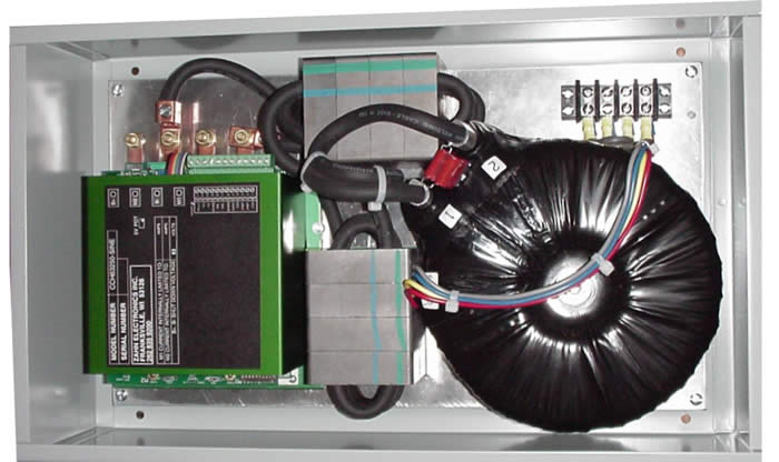

also has anyone had any experence or information on these multi input voltage inverters...
DCAC45/120/2500 and DCAC57/120/2500 DC/AC Inverters.
These Inverters convert a wide DC input voltage to a regulated 120/240vac, using 4 quadrant, crystal controlled, Full H-Bridge, transformer boost technology.
DCAC45/120/2500
Input 27 to 63
Voltage
Output 120/240
I have bought the farm...now I AM powering it...

grolly
Joined: 19/05/2007
Posts: 62
Posted: 10:36am 28 Jun 2007
Hi Dwyer, yes that is the web site I got the pic off, what I was asking was if anyone has had any experence with these type of inverters, whether they are reliable, and do what they say.

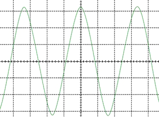

I had aquick look at Zahn inverter and l copy this information Note, with a sine wave
output current, the peak current coming in from the DC source is a sine squared waveform and will not work well on elecric clock, microwave,dvd or tape player, fax machine also some tv set ,anything appication that design run on pure wave is fine but not on modifild wave.

Personally, I would only consider a pure sinewave inverter for my own applications, so whatever you get, check its specs very carefully. See what they rate its "maximum" at, and how long for. Also if they offer an indication of how much overload it can take for how long (eg, my 5KVA inverter can do 6KVA for an hour, at 40 deg C ambient) - if you have this sort of "safety margin" you can probably be reasonably confident with it.

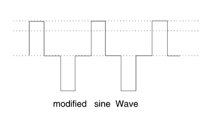

Hi all, what is the difference between Modified Sine Wave and pure sine wave inverters, apart from running a computer, what else will not run?, I am thinking of running the office on a pure sine wave( 1500W/3000w) and the rest of the house on a modified sine wave 4000w/8000w, will this work?
Highlander
Joined: 03/10/2006
Posts: 266
Posted: 09:25am 02 Jul 2007
Hi Grolly,
I'll leave it to Ross or Mega for details, but in a word NO.
Some things will not work at all and others will have their working life greatly reduced.
Have a look at this
http://www.thebackshed.com/Windmill/FORUM1/forum_posts.asp?T ID=375&PN=8
Edited by Highlander 2007-07-03

RossW
Joined: 25/02/2006
Posts: 495
Posted: 10:35am 02 Jul 2007
Yup, as per highlanders diagram, MSW (or "Stepped-Square" the more honest people call them) are pretty horrible.
Whats worse (and not clear from that same diagram) is that few, if any, have regulation - they simply chop the raw DC to the stepped output. In order to keep the "RMS" voltage roughly the same, they adjust the width of those pulses. What this means is that when the battery voltage is high, your "peak" voltage may be *WAY* above the normal 240V sinewave peaks - and in some cases, DANGEROUSLY high.
Similarly, when batteries are low, the pulses are much longer, but may not even be high enough to run a lot of equipment.
In short, for MANY applications, they *WILL* kill your appliances. This is increasingly likely as cheap, low-quality switchmode supplies take over the older transformer-based plugpacks (mostly because the xfmr based ones will not meet the energy/efficiency requirements of under 1W quiescent).
I got rid of my last quasi-wave inverter nearly 20 years ago and wouldn't even *consider* one again. Period.
