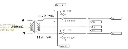

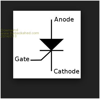

If we look at a drawing of a SCR its like this.

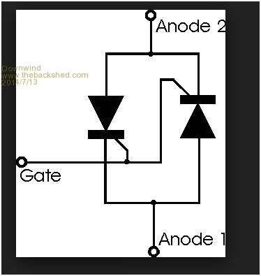

Then if we look at a Triac drawing its like this.
As you can see its a back to back SCR as you have suggested your circuit has.
Pete.

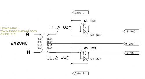

From what i understand of the present circuit i see it as this.
As far as can understand it can only be a VAC circuit when configured this way.
I dont know for sure (and to lazy to check a data sheet) but i suspect each SCR will have a diode loss of 0.6v, so hence the difference between VAC in and VAC out, its just a guess to how i would expect it to perhaps operate like.
Please note while drawing the schematic i did not recall the actual voltages, so i simply used a voltage example to express the result.

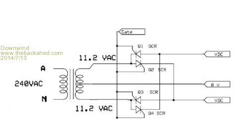

But by changing the config of the SCR's then it might be possible to make a DC rectifier from them, like this circuit

Then the existing circuit may have used VAC wave chopping to control current to the output............ who knows?
Personally i would use the VAC switching of the low voltage side to control the battery charger, that way you simply switch on/off the VAC to suit the requirement of load/voltage.

Posted: 11:00pm 15 Jul 2014
Pete,
Your second schematic for DC output looks like what I can see on that chlorinator. The heatsink is the common anode of the two non-insulated SCRs and that is the one DC output, the common from the centre-tap is the other DC output, i.e, two DC leads.
You are correct in suggesting AC wave chopping as there was a variable resistor on the board for 0 to 100% chlorination.
