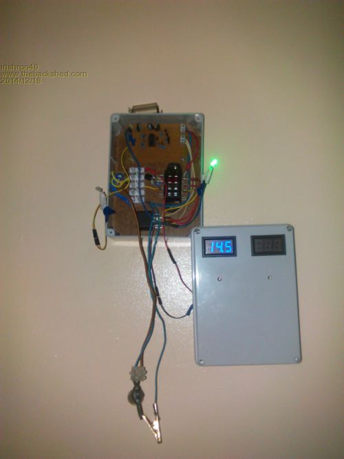

irishron40
Joined: 22/09/2014
Location: Ireland
Posts: 254
Posted: 01:27pm 18 Dec 2014
I just finished this charge controller, and would like the voltmeter and amp meter for turbine to match the one I allready have to check battery voltage
