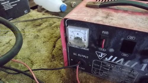

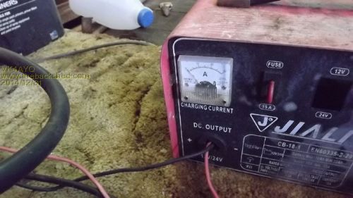

It is a bit of a waste of power but in my experience over the years it is common to loose 10% of input to various inefficiencies across the RE system.
The 32 volt equalization is a theoretical voltage where all the sulphation is desolved and if that is done it is supposed to stop the slow deterioration of lead acid batteries over a number of years, in practice I have found that using desulphators achieves this end without boiling hell out of the batteries, your comment on blowing the desulphator on 24 volts is unfortunate but you can use two 12 volt units across the bank with even better results that a single 24 volt unit.
An actual meter reading on a 500 AH 24 volt bank I am re hydrating at 29 volts.
An actual meter reading on a floating at 27.5 volts, also re hydrating.
